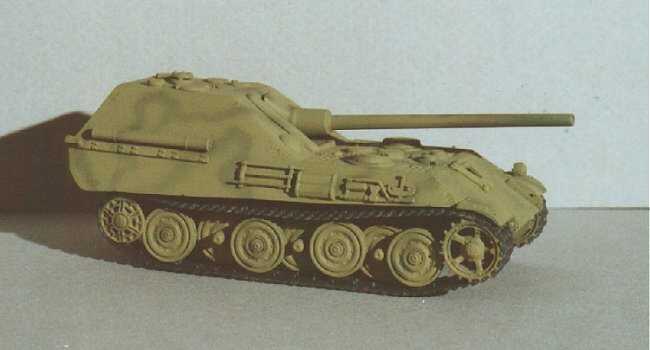

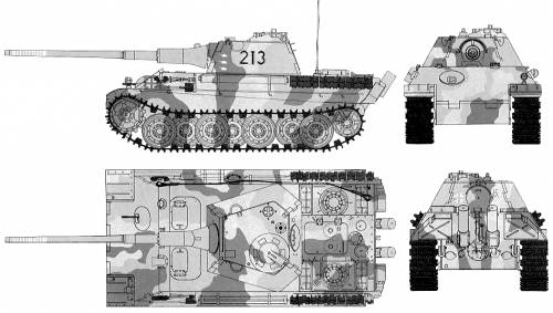

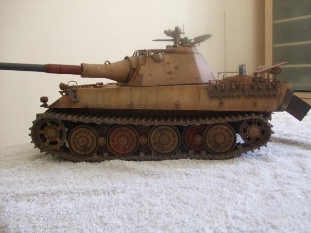

Hi Guys Started my new project its a Panther II, see first two photos the third photo is a Jagdpanther II,It has the same hull, so might make the upper to fit, so I have two tanks for one hull.
The Hull is a Tamiya panther hull (Bought on ebay), wheels spaced and one removed using King Tiger wheels and suspension arms,it will have King Tiger tracks and sprockets (have full tracks for build to set suspension and get it running)I know its supposed to have transport type tracks, but these are very expencive and will be added later (when funds allow),Hope to also have Tamiya DmD/Mf units (again funds permiting)Have the low ratio gears from forgebear(also have a Jagdpanther upper from Dave May convert to Jagdpanther II)So could have a running lower hull soon (using heng long electrics).

the best set of accurate drawings i have come acrss if in panzer tracts no5-4 its all about the panther F and II .. and explains all the history and why thay did not come about .. .. one section that made me think about the panther ii is the fact that it was going to be fitted with larger road wheels . like the e-100 .. e-10 and e-25... as the germans were trying to standardise as may components as possible ... to date i have not found the corret wheels .. other thank on a hoobinbs e-100 ( yes right .. i wounder if the kitt will ever turn up ..and if its complete )

The middle picture is Martin Davies (Edelweiss3945)'s Panther II. As far as I remember, he made it from a cut-down Tamiya King Tiger hull and re-spaced the wheels. The turret was scratch-built. He brings it to our northern branch meets sometimes and it runs great. Might be worth giving him a PM as he'll certainly have more pictures of it and maybe some building tips too.
Chris
