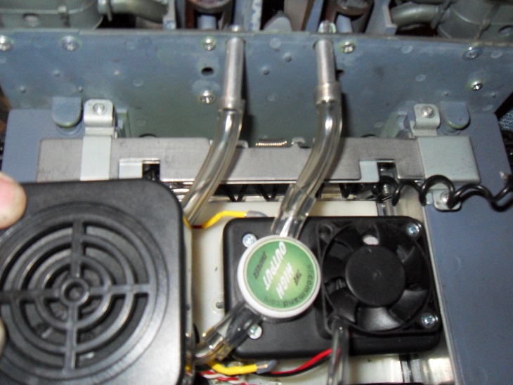

No problem Pete,these are pictures from a fan modified smoker,this was the common solution for many.The fan in this picture fits the frame of the smoker well but the round intake section needs to be cut back so air can blow more direct into the round air intake,the fan can be driven by the stock printed circuit board just remove the pump motor and attach those wires to the fan make sure of fan direction.Blake
