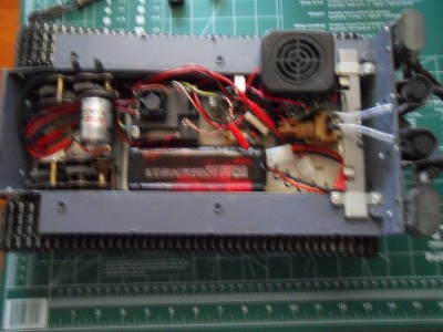

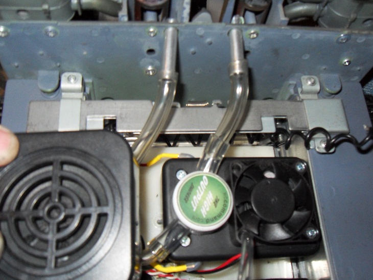

hi guys. i notice rob has been talking about the heng long reinforced hulls that nigel pearce and i are working on. we reckon with the tiger 1 base, deep dished to look like the tamiya, so you have room for the electrics of your choice, heng long suspension in metal with grub screws, idler set on the rear, fully reinforced, the price will be £80. gearboxes shown on the piccie are an extra £40 (fitted) if required. cheers dave
the second piccie shows a completed heng long and gives and idea of what you can end up with after your initial purchase of the reinforced hull!
