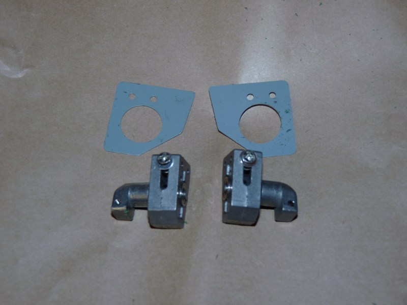

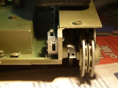

hi sax i have taken some photos this may help , i havemanaged to insert 1 track tensioner but the problem seem the tensioner is hard up the roun plastic post which holds the tank togther, also the rear of the tensioner snerfiers with back plate

Chris,I have a different set,Blake

with those tensioners you have to remove the rear post plus with mine i only got one flat plate its only used as a template to hold against the hull to drill the two holes for the tensioner
Re: help needed with track tensioners ?
hi ice if i remove the rear post how do you scure the rear of the tank to the top deck , and dose this cause any problems,.
i think i may be able to grind a small amount of the lower half of one side the tensioners to get them to fit , ill need to do some carefull measureing befor i start griding . ill post more pics soon . ps many thanks to everebody who helped me to start posting pics. tanktop

mines only fixed at the rear with the two screws under the rear track guards

I have been looking my pantiger and i look like will have to remove the rear posts
hi tanktop removing the posts shouldnt cause any problems with the lid

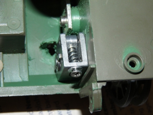

Hi guys i still need some help with the track tensioners , i have removed the rear post and fitted track tensioners in place this seemed to go quite well . but that were the trouble starts , i refitted the maetle tracks and tryed to ajust them ,
I found that the weight of the tracks drags ajuster foward again .
in the track tensioner there is asmall spring which is ment to hold the ajuster in the required place, but the spring is not strong enough ,so pushing the ajutsment screw out the back of the ajuster relaesing any ajustment made.
has any body try fitting these track tensioners?
here are some pics of track tensioners and ajuster with spring assy
