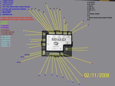

Hi
I am guessing that this would have been posted before somewhere on here but can anybody tell me how to connect a Tamiya recoil unit to an RX 18 board.
cheers
Glyn

Re: Tamiya recoil to RX 18 ??
Post by FireflyKeith »
This diagram should help :thumbup:
Keith 8)
