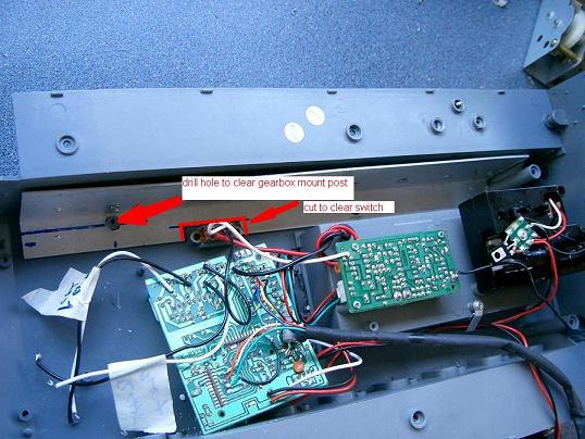

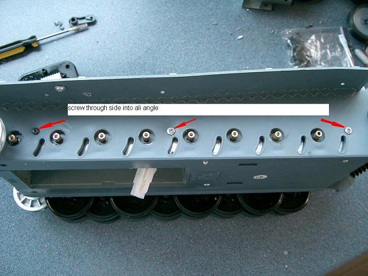

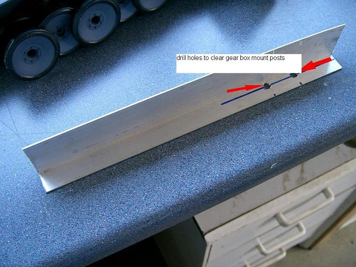

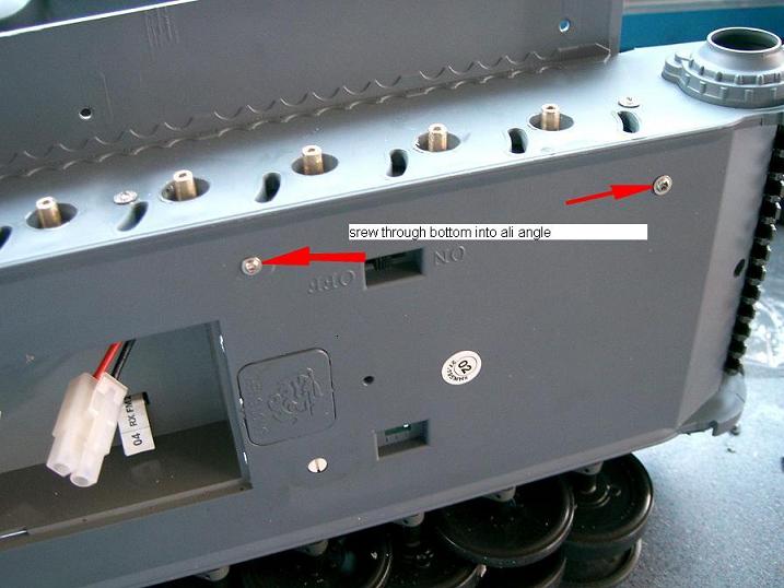

hi all , this is my method of upgrading to metal suspension arm's, using "L" shaped ali angle and screws to fix to tank to allow removal for repairs, rather than glueing.
