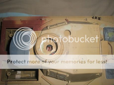

Hi looks good . Yer the late cupolas have the swing lid. Heres the picts of how far I moved my cupola . You can hardly see the diferance.
Original position.
New position.
And with the swivel cupola and ring.
grompix
Posts: 704
Joined: Mon Jul 21, 2008 8:48 am
Location: Newcastle upon Tyne
Re: HL Pz. IV cupola possition
Post by grompix »
Looks spot-on Andy. :thumbup:
