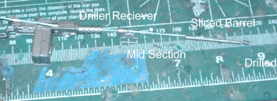

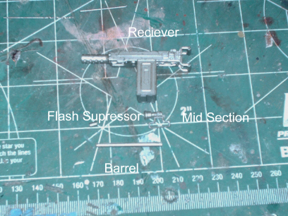

Pretty easy. Take you gun and cut it apart as shown. Drill the easy parts Reciever, flash suppresor, mid section.
For the barrel. Find the mold seem and ever so carefully use a #11 blade to slice along the line. Now use a metal coping saw blade to cut half way through.
Two strands of Fiber optics are then lay inside theslice and secured with CA. Be sure you leave a good amount of the optics at the business end.
Putty up the slice, then sand smooth.

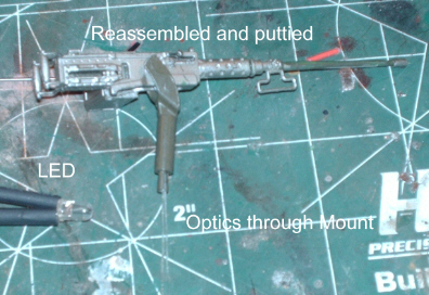

Take an LED. REMEMBER LEDs OPERATE ON DIFFERENT VOLTAGES DEPENDING ON THE COLOR!
I recommend using on that is already in the tank.
Connect your wires to the LED. Use a small bit of tube Brass or Plastic, but with enough inside diameter to hold you two strands of Fiber Optics. Wrape black tape around the tubes until it will fit tight inside a bit of Heat Shrink.
Place the heat shrink over the led and then insert the wraped tube so the end contacts the tip of the LED
Shrink it tight.
Now insert your Fiber optics and securethem with CA.

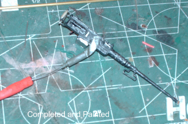

Connect your LED to an MG Circuit in your tank and there you go!
Enjoy

Drill a hole in the mount and feed the Optic Fibers through, then secure in the tube so so ends ofthe fibers sit on top of the  LED.  Putty up the cut area of the barrel. Sand and paint!

Wire your LED and with a narrow bitof tube shrink wrap the tube to the tip ofthe LED

Use A fine tooth metal saw to slice the long barrel half way through

Cut  The weapon as shown. Drill the small easy to reach places to accept two or three Optic Fibers
