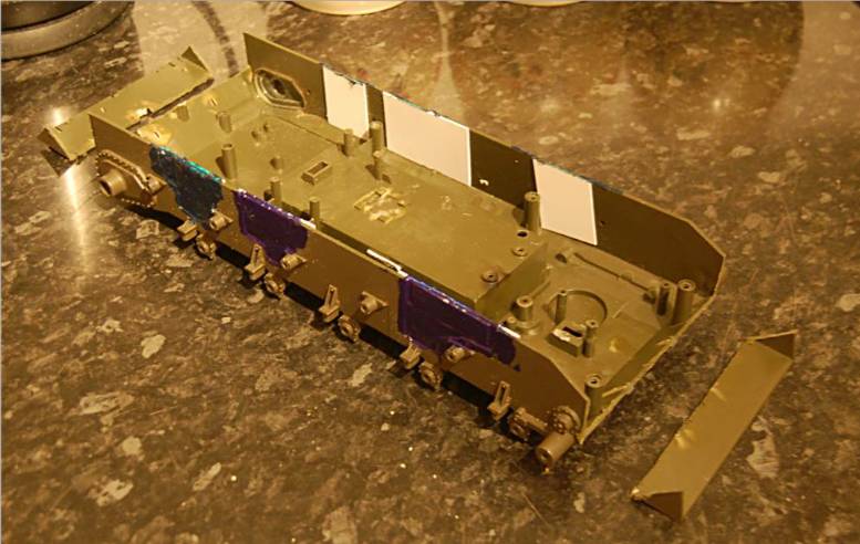

Here's the hull smoothed out and short'nd. It's now 27cm's long, which is equivelent to around 4mtrs in real life.

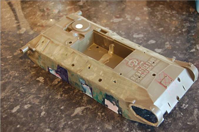

Here's the scrap Bull dog hull from my M-75 build. Ive started to alter it.

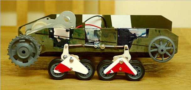

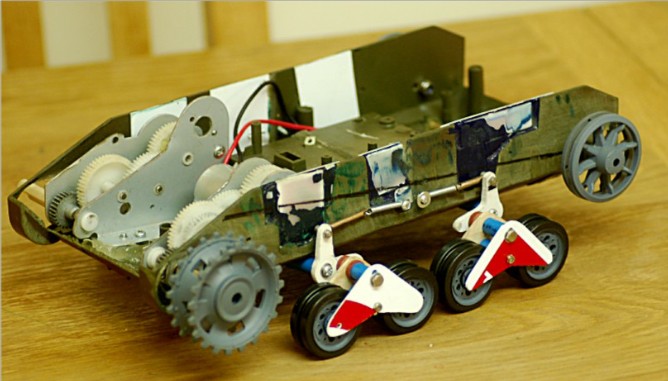

Well, its been a while since I did any work on this, but the lower hull is starting to take shape.
The rudimentry spring set up, though looking flimsey, works and will be fitted with a half tube shape cover.
Suspension units made and fitted. They are constructed from Pzr III wheels, air tubing, thick, strip balsa and plastic sheet. The axels are made from the stainless steal posts that are used on HL gear box's. You can also see that the sides of the gear box's have been shaved right down to give me a lower profile.

Post by grompix »
Looking really good. Clever use of servo horns to hold the suspension units.
Chris
vonrundstedt
Posts: 994
Location: Northampton, UK
Re: New project started in earnest.
Post by vonrundstedt »
:eh: :eh: , That would have been a clever idea, Unfortunately I did'nt think of that at the time. The suspension units are all home made, apart from the wheels. the 'horns' being cut from an office door sign.
