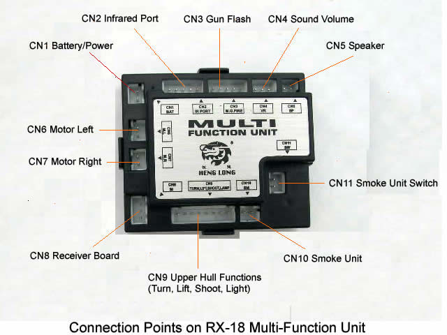

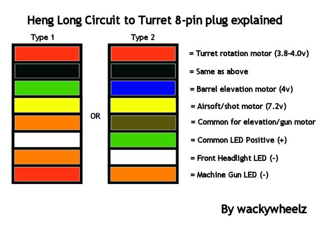

These may be helpful,they are accurate for most smoke and sound tanks.
Trouble shooting 8-pin cinnector
8-PIN WIRING COLOR GUIDE
DETAIL OF RX18 PIN DETAIL
RX18 MFU PUG DETAIL
RX18 MFU PUG DETAIL

Can someone please explain what the pins on connectors 2 & 3 actually do? I understand B+ and B- but what does HBU sig do? How about the pin labeled Strobe on CN3?
Thanks
carl
For those who fought for it, freedom has a flavor the protected will never know.
B.A.D.A.S.S.Force
Posts: 55
Joined: Tue May 29, 2012 7:03 am
Re: WIRING DIAGRAMS FOR HENG LONG TANKS
Post by B.A.D.A.S.S.Force »
nyleatherneck wrote:Can someone please explain what the pins on connectors 2 & 3 actually do? I understand B+ and B- but what does HBU sig do? How about the pin labeled Strobe on CN3?
Thanks
carl
Hope I'm getting all this right, & I'm sure someone will quickly correct me if what I say is misleading, but ...
The Heng Long tanks that battle using IR have what is called the HBU, or I believe Heng Long Battle Unit. It is a sensor (some times called the "apple") that sits on top of the HL tank to receive IR signals when other tanks shoot at it during IR battles.
The HBU has 3 connector pins on it ... negative, positive, & the signal. The 3 pins labeled on CN2 with the "HBU" are connected to those HBU apple pins.
I'm a little more certain with what I said about the HBU then what I'm going to surmise with the Strobe on CN3, but here goes ...
The HL tanks have an extra that can be added, called a High Intensity Flash (HIF) unit that stores electricity & emits a high intensity light flash from an LED when firing a tank's main gun. The HIF unit will connect to those 5 pins on CN3, the Strobe pin is the trigger, that when the tank's main gun fires, the HIF unit has a switch which shorts the trigger with the positive to complete the circuit & make the LED bright flash go off.
