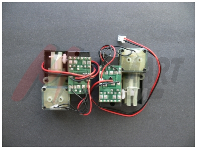

You have answered your own question in a way,the new smoker does receive power from both motors.As motor RPM increases the smoker pump motor increases as well.
New smoker
New smoker
New Smoker Wiring
New Smoker Wiring
If converting an older smoker you could use one motor to wire to the pump,but this might cause an imbalance between the motors,which I think is why H/L designed the new smoker with the board to channel motor power drain equally,or balanced.Understand I am just stating an opinion,the only smoker that has ever worked well for me is the new model. Cheers Blake

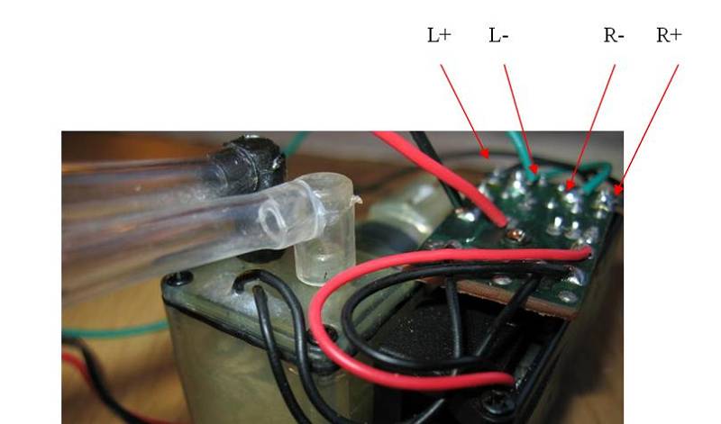

To cut down on heat at smoke pump unit and power drain at drive FETS, just hook up to one motor to both inputs. That little board gets VERY hot . This Does not really affect steering or tracking. No one will notice if your pump does not put out a tone of smoke when you turn left.

The little smoker board has four solder square spots(the biggest ones with nothing hooked up to them in your pics). Basically + and - from each motor. I can't remember if + on outside or inside. This powers motor. The smoke element is powered by the rx18 board. With one motor hooked up, the smoker does not always run the motor at idle, but kicks right in when you throttle up.

No, you need to do much more than that. Smoker motors run on different voltage and current requirements. I would not waste time trying to convert an old smoker. There is an actual circuit on the little green board on the new proportional smokers that reduces and regulates current (hence the excess heat with two motor hook-up). Or you could build the circuit board which requires one D882 (probably used as a cheap voltage regulator), 6 diodes, and one resistor. This thing gets hot with full motor power (so hot you can't touch it....probably in need of a good sink)
