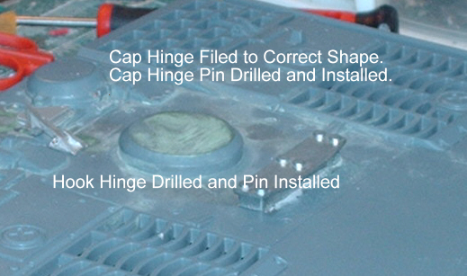

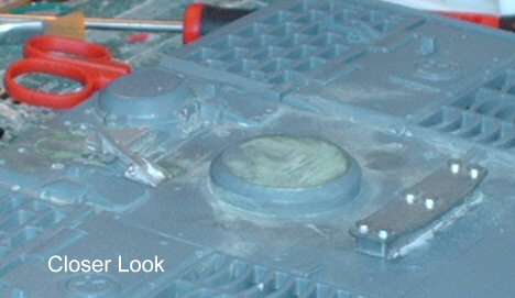

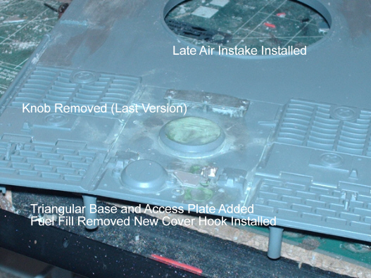

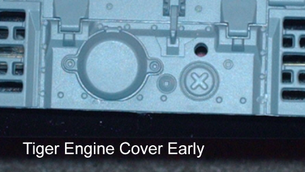

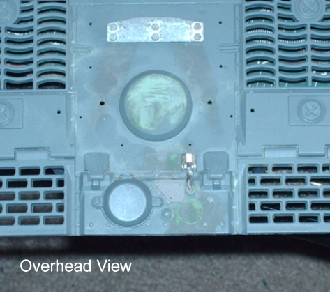

The Engine Cover needed some love. So I modded the coverto the Late and Last Version. This Version had a triangular plate for access rather than having to life the entire cover. The wading equipment was removed ad thus the knob on the cover was deleted. The Fifle Air Cleaners were done away with and a new air intake installed.
