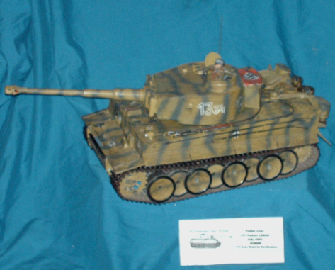

Do you want a really great looking name plate for your pride and joy? Be nice at a show or a battle.

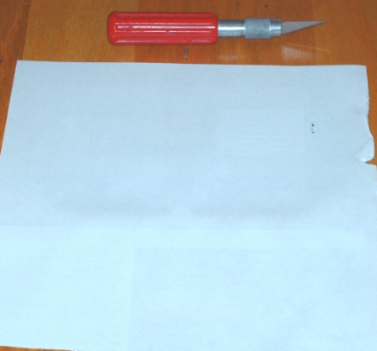

On the spot of a fresh sheet of paper use clear tape to place a piece of the magazine paper to the blank sheet where the image will print.
Note: Use a sheet with mostly text on it. Better yet if you can find a piece with no writing at all.
Feed the sheet with the magazine page taped to it into your Laser Printer. You might have to try this a few times.

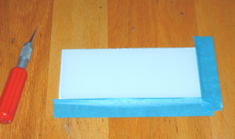

Now lay out your lexan or plexi and secure it to your work surface on two sides.

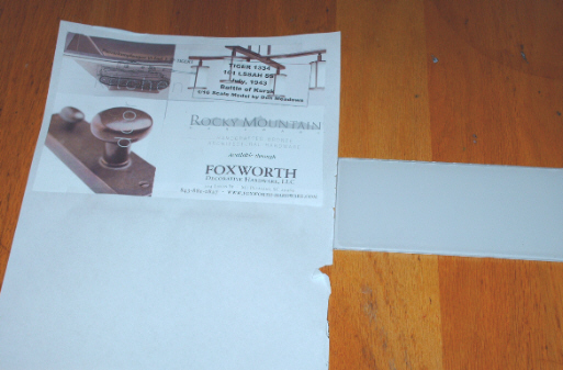

Remove the magaine page from the sheet you used to run it through the copier.
Place the magazine page with the image you printed face down on the Lexan. Static will help here.

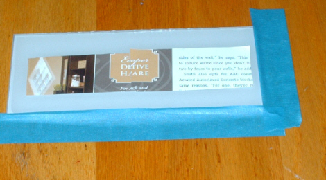

Lexan and Image to be transfered
Lexan Taped to Surface
Once dry and cleaned up you ca place a background or paint it. The Sky is the Limit!

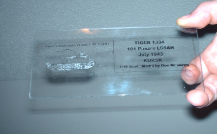

After 30 Minutes  Little bits of paper still stick  Soak some more and gently rub off
