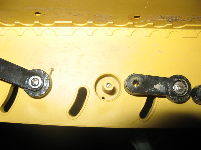

hi the sturmtiger has recieved some battle damage and i am unsure how to go about a repair
one of the screws that hold the suspension arms on has snapped off leaving the screw thread inside the plastic
thought about drilling it out but dont want to damage the plastic
does anyone know if the tiger 1 lower hull heng long will fit if the repair goes wrong
if anyone has a lower hull with wheels and suspension arms they would consider selling please let me know
thanks phil

now youve broke it lol :silent:
best bet would be a metal arm upgrade set with reinforcing bars for inside the chassis :thumbup:

i have a spare H/L lower hull you can have, but you should go with fv432's advice and get metal arms and support brackets, if its snapped once it could snap again.

At the moment you just need the support bracket if you dont have enough for the arms as well.

Got a set of metal arms looking for a home.
PM me if you're interested.

Hi yer as per the other posts . Get metal swing arms and the brass spigots or the strengthening strips that replace the plastic spigots . They snap ever so easily . I change all my HL ones .
