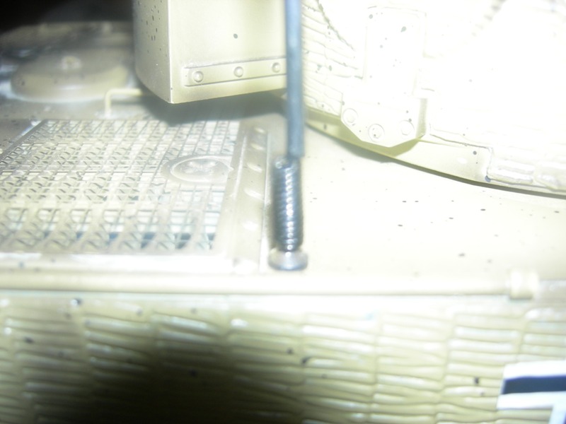

Thanks for posting this video. I plan to fit this unit to my Tiger, when I can get around to it. I also like your external aerial/antenna set up. Is it spring loaded ? is it functional ? Can you tell me a bit more about it.

Hi Steiner.
Glad you liked the video.
The antenna is a dummy I made og an original HL antenna.
What I did was first I relocated the antenna stand that was placed back on the tank. Then I cut the original down to 125mm (that will be a scala lenght of the antenna). I then took a thin electrical wire and pulled out the copper and used the insualation for covering the antenna.
The working antenna is an internal antenna made after pzrwest antenna mod found here; http://www.hobbyhavoc.com/forum/index.php?topic=155.0

Thanks for that info, I already have cut my aerial down to scale size and its still works. I wonder if I got some shrink tubing and covered the aerial with that I might get the same effect. It might reduce transmission distance though ?
Great idea though.
Cheers.
Great idea though.
Cheers.
STEINER
Re: Recoil on HL Tiger 1
Hi Steiner.
I dont know if it will reduce the transmittion distance by using shrink tube. The reason I used the insulation from an electric wire was because I couldnt find a shrink tube small enough in my local store.
