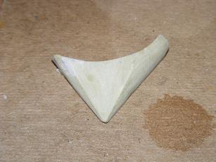

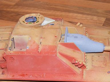

The title say's it all really. It's chucking it down outside and I'm stuck at home as I am on standby for work ( again :thumbdown: ). So what to do ? I know let's start another tank conversion. This time it's the turn of the Stug III. I have the Asiatam metal hull and late return rollers on order for Xmas so I thought why not upgrade to a later model as one does. After asking round about a few things and checking the prices of bespoke conversion kits on the bay I decided to order a replacement gun shield for the loader from Forgebear, as I have "misplaced the origional :{ somehow. I have rebuilt the mantlet to the later pigshead type by simpley dremmeling off the sharp corners to a more rounded profile. I also removed the front plate off the origional mantlet. Then all I did was rebuild the mantlet using Milliput to get the aproxamate profile. I have put in an alloy tube to allow for a battle system IR emmiter to be mounted where the co-axial machine gun came through on the full sized Stug. A little oversized in comparison the the real thing but I can live with that. After undercoating I sprinkled good old bicarbonate of soda over the still wet paint for a rough cast texture. Next came the shot deflector in front of the commanders cupola. This was a new experance for me as I don't normaly "scratch" build anything, but this time I had no other ( cheap ) option. So i marked off where the shot deflector fitted in front of the cupola and cut out a cardbord template. Then I put the mixed milliput on the template and trimmed it to the V shape making sure it was thinner at the point of the template than at the rear. Then I put the template onto the Stug and roughly moulded and trimmed it to the shape and required thickeness. I used images from missing lynx .com as refrence. Here are a few pictures as to where I am at the moment . Comments as always welcome :D

Reshaped mantlet and shot deflector
resized Stug pic 2.jpg (32.43 KiB) Viewed 3910 times

scratch built shot deflector
resized Stug picture ( shot deflector ).jpg (24.54 KiB) Viewed 3910 times
another view of mantlet and shot deflector
resized Stug pics.jpg (29.42 KiB) Viewed 3910 times

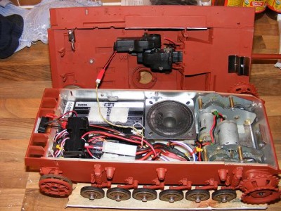

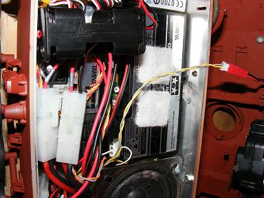

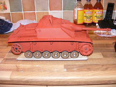

Well Christmas has come and gone once again. This year I got an Asiatam Panzer III/Stug alloy hull, which was nice. So now i've had a few days off I will share my experiance with this ( Frankenstien ) build so far. The hull is a very nice unit and well put togeather. The gearboxes were a drop in fit, but only 2 of the locating screws could be used on each gearbox, and I had to cut 2 small slots in the gearbox side plate to allow for the screws that hold the front of the hull togeather. I removed the mounting lugs on the plastic inner deck as I wanted to install Tamiya electronics not HL, mounted the metal wheels and got on with the electronics. That proved to be an entertaining experiance trying to shoehorn everything in, but rewarding as I got it all running today with the new planet T5 RC gear I bought earlier in the year. Here are a few pictures of how far I have got. All I need to do now is sort out the recoil unit to work with the Tamiya electronics ( more on this later ). Then wait for the late style return rollers to turn up and put them on the hull. After that it's just painting :haha:
Alan

Some very untidy wiring sorry to say

It'a a very tight fit in there

Nice work Alan, it is looking good, which tamiya control units did you use, also did you use a shoe horn to get the gear into the hull, LOL
