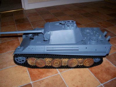

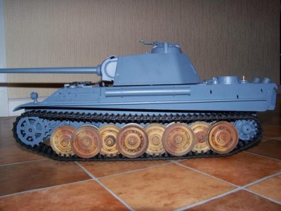

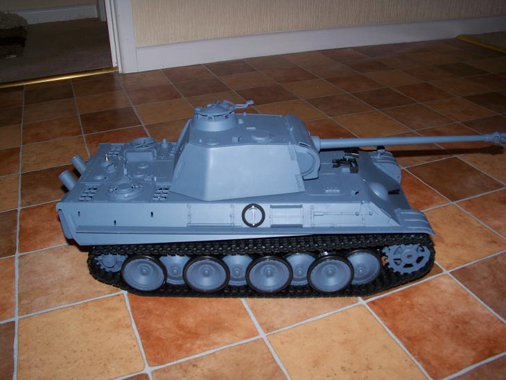

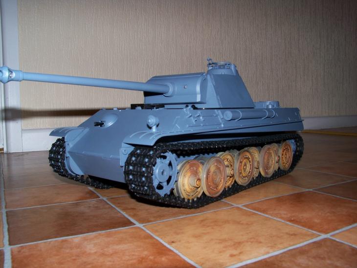

here are some pics of befour .. and after .... what a difference ...

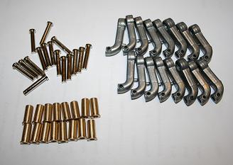

Hi Ian you mean like your favourite seller ( not ) Tankzone is selling for the HL jagdpanther
. Hope this helps
