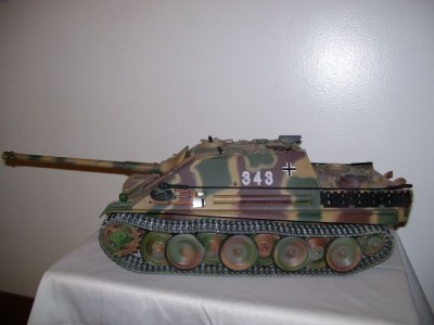

matoro kt direct fit to tamiya hull parts needed are hull and suspension the mato parts can be fitted to the tamiya hull
mato sherman fits tamiya minor mod to hull need 1/4 inch cut from rear plate on tamiya hull
hl panther and jag direct fit to tamiya hull need to remove mounting posts from the HL hull need hull and suspension and front cear covers from tamiya

no the pershing is longer in the tamiya version the hull would be to long
