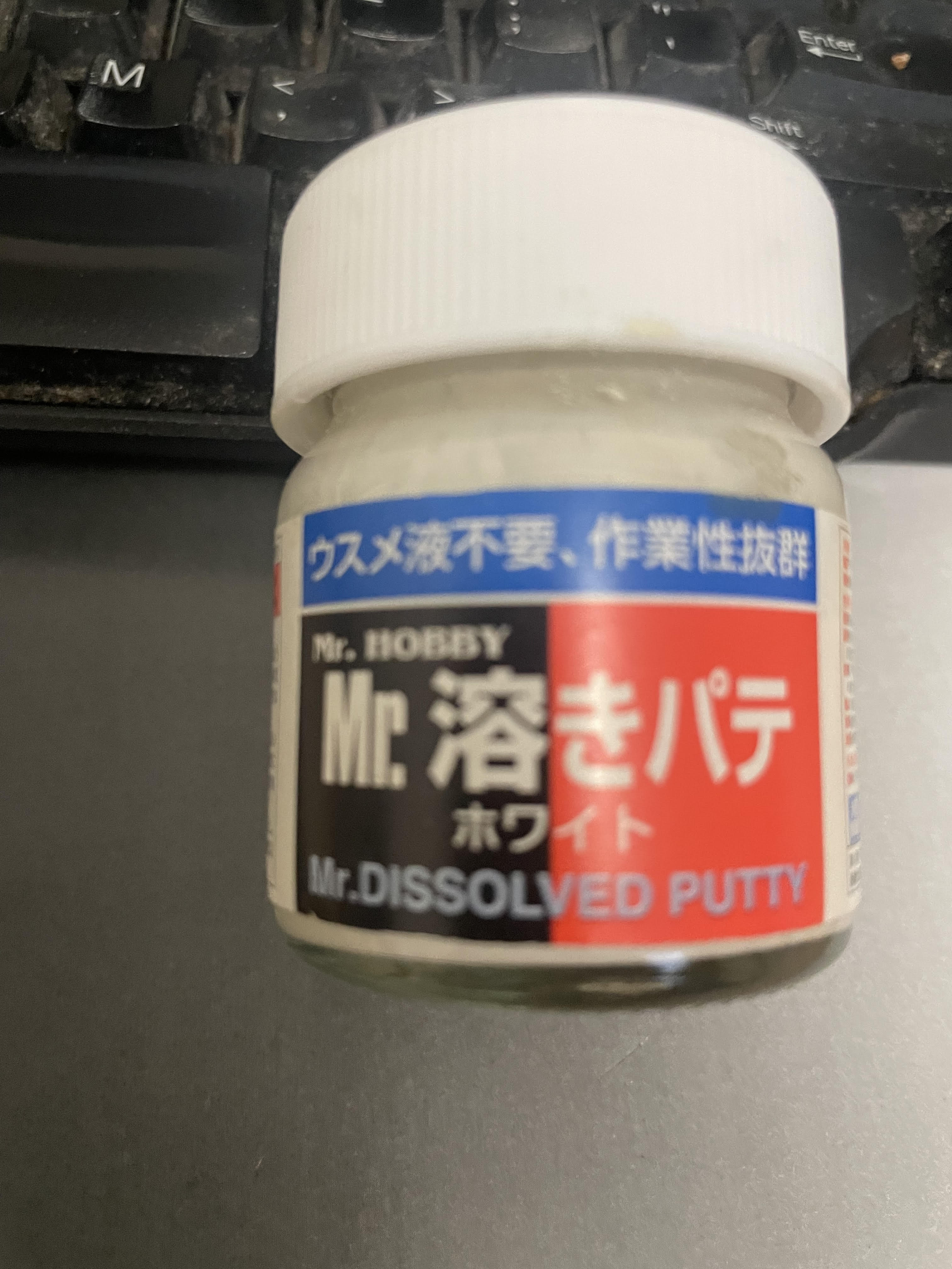

Really love this stuff. Granted you could make your own but I have great results with this
mr dissolved putty.jpg (774.48 KiB) Viewed 120 times

Panzermechaniker wrote:Really love this stuff. Granted you could make your own but I have great results with this
Nice thanks ill give it a shot for sure
