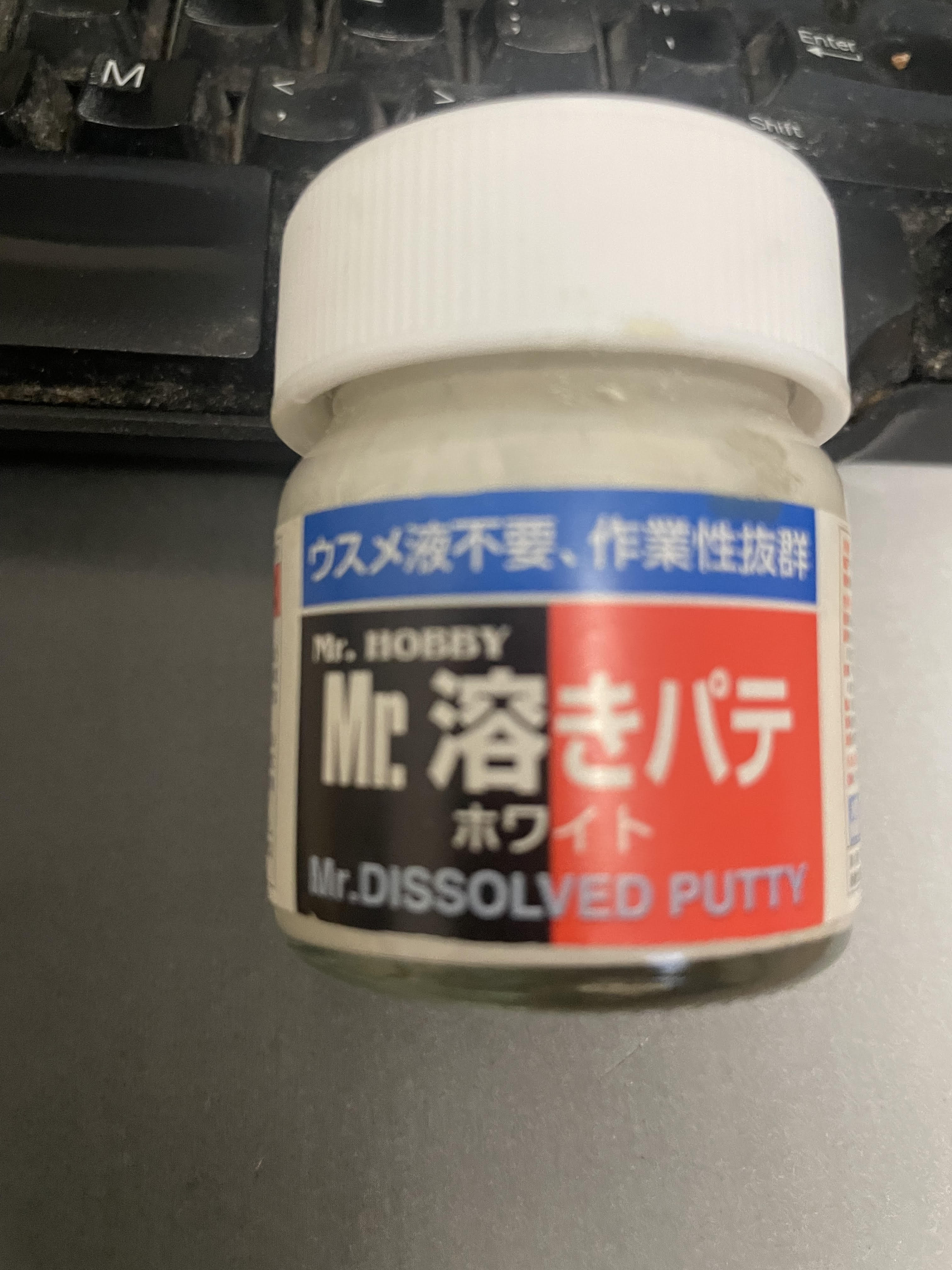

Re: Armor Texture
Really love this stuff. Granted you could make your own but I have great results with this

Re: Armor Texture
Nice thanks ill give it a shot for surePanzermechaniker wrote:Really love this stuff. Granted you could make your own but I have great results with this

- Herr Dr. Professor
- Posts: 6155
Re: Armor Texture
I've had many uses for Mr. Dissolved Putty, but for that "cast" look on the M26, I used Mr. Surfacer 500: viewtopic.php?t=34857&hilit=cast&start=60

- Shameless86
- Private
- Posts: 97
- Joined: Wed Jan 08, 2025 9:58 pm
Re: Armor Texture
Dang that thing is super high quality thanks for the tip!Herr Dr. Professor wrote:I've had many uses for Mr. Dissolved Putty, but for that "cast" look on the M26, I used Mr. Surfacer 500: viewtopic.php?t=34857&hilit=cast&start=60
