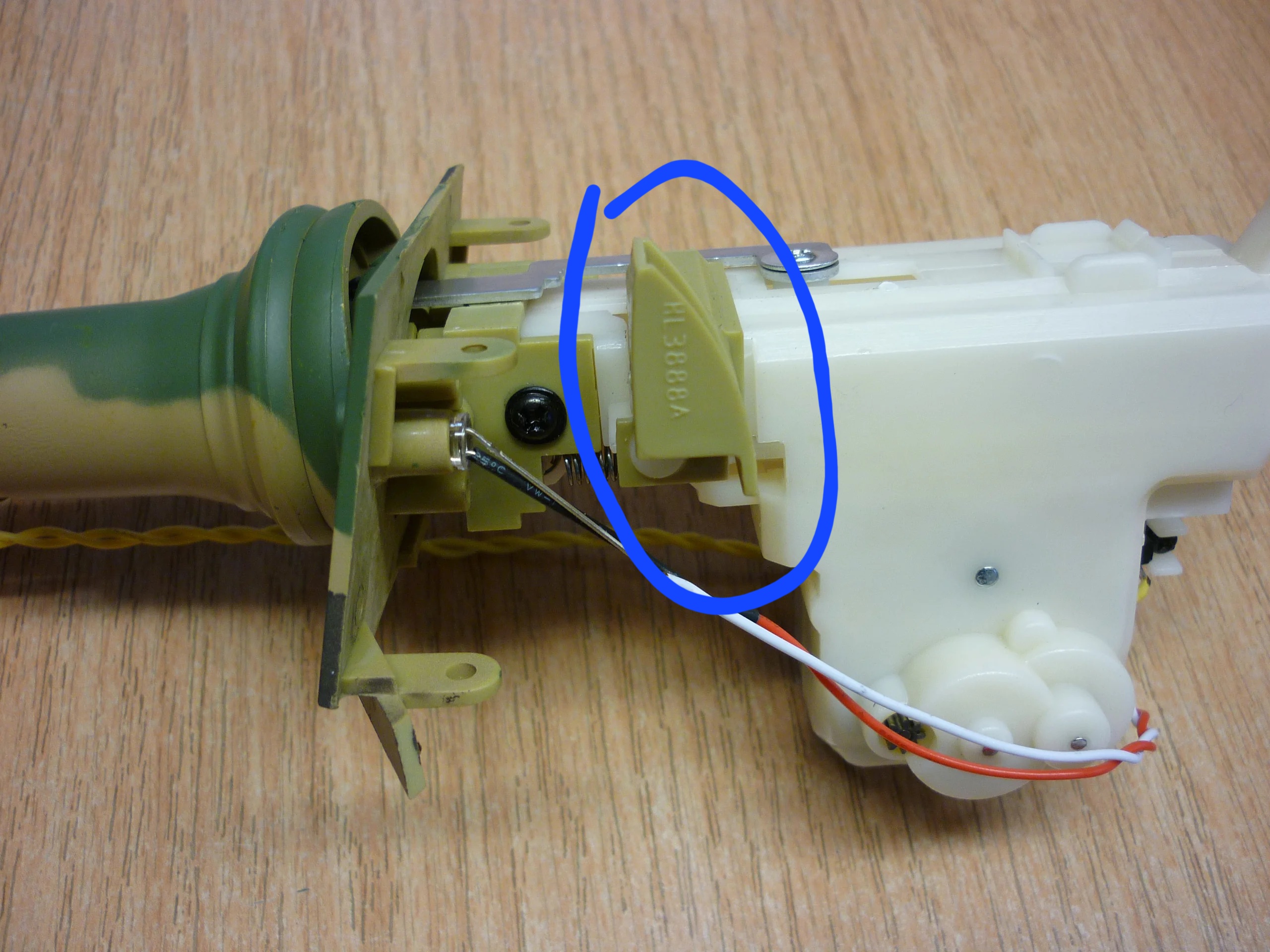

Hello all, I've recently gotten into the hobby and have three HL tanks. Two of my tanks have a no recoil function.
I was wondering if these can be converted to recoil units by simply tapping into the barrel and knob on the launcher on a standard bb unit, and making a makeshift brace for recoil effect without buying a servo.
Secondly is the little housing on the launcher circled on the first picture needed for the bbs to be successfully loaded into the launcher. Replacement units seem to be lacking this little housing from what I've seen online. I'm thinking of buying the recoil units if a standard bb launcher cannot be modified to have recoil effect.
Any insight would be greatly appreciated.

I think so yes mate.
I did a King Tiger recoil with one of those recently & the replacement did not have that appendage.
Not needing to be a BB unit the owner didnt care.
Im sure if you are keen enough to do the swap/conversion you can create a suitable substitute.

HERMAN BIX wrote: ↑Fri Dec 05, 2025 7:30 am I think so yes mate.
It boggles me that the appendages are not included with the purchase of a recoil unit. Let alone no one seems to have the parts available.
I think I'm going to experiment and see if I can pull off transforming my non recoil tanks.
Re: HL Recoil unit questions.
I've seen it modified from a Non Heng Long "Recoil" Barrel to What they call "Recoil". So yes just fabbing a connection to the airsoft unit will cycle the unit. I have to dig and find some videos from a few years ago showing how it works. I know I've seen it. But I also remember not being satisfied with the results and persuing other avenues.
But the thing is that it doesn't recoil the way a tank cannon recoils back After firing. It winds up and snaps the barrel forward when the BB lets loose. Again I have seen a video experimenting but it still didn't get a reslistic recoil.
The Servo recoil is the most reliable realistic recoil that I've come across. And I've messed extensively with the Asiatam unit to fits of frustration which drove me to just do servos. But I'm a glutton for punishment and still have several of the other units that I randomly put in my tanks. The main issue with them is reliability. They work Great when they work. Then they don't and I end up pulling whats left of my hair out while gouging out one of my eyes with a wooden spoon because I can't get it to work Just Right.

MrChef wrote: ↑Fri Dec 05, 2025 7:41 pm I've seen it modified from a Non Heng Long "Recoil" Barrel to What they call "Recoil". So yes just fabbing a connection to the airsoft unit will cycle the unit. I have to dig and find some videos from a few years ago showing how it works. I know I've seen it. But I also remember not being satisfied with the results and persuing other avenues.
Intresting I wonder if maybe using a small spring would assist in improving the reliability. I've seen good video's on you tube of modifications but all have servos on recoil launchers from looking at them and their features. If you come across the video of non recoil bb units again I'd love to see them. I was doing some research earlier but no cigar.
