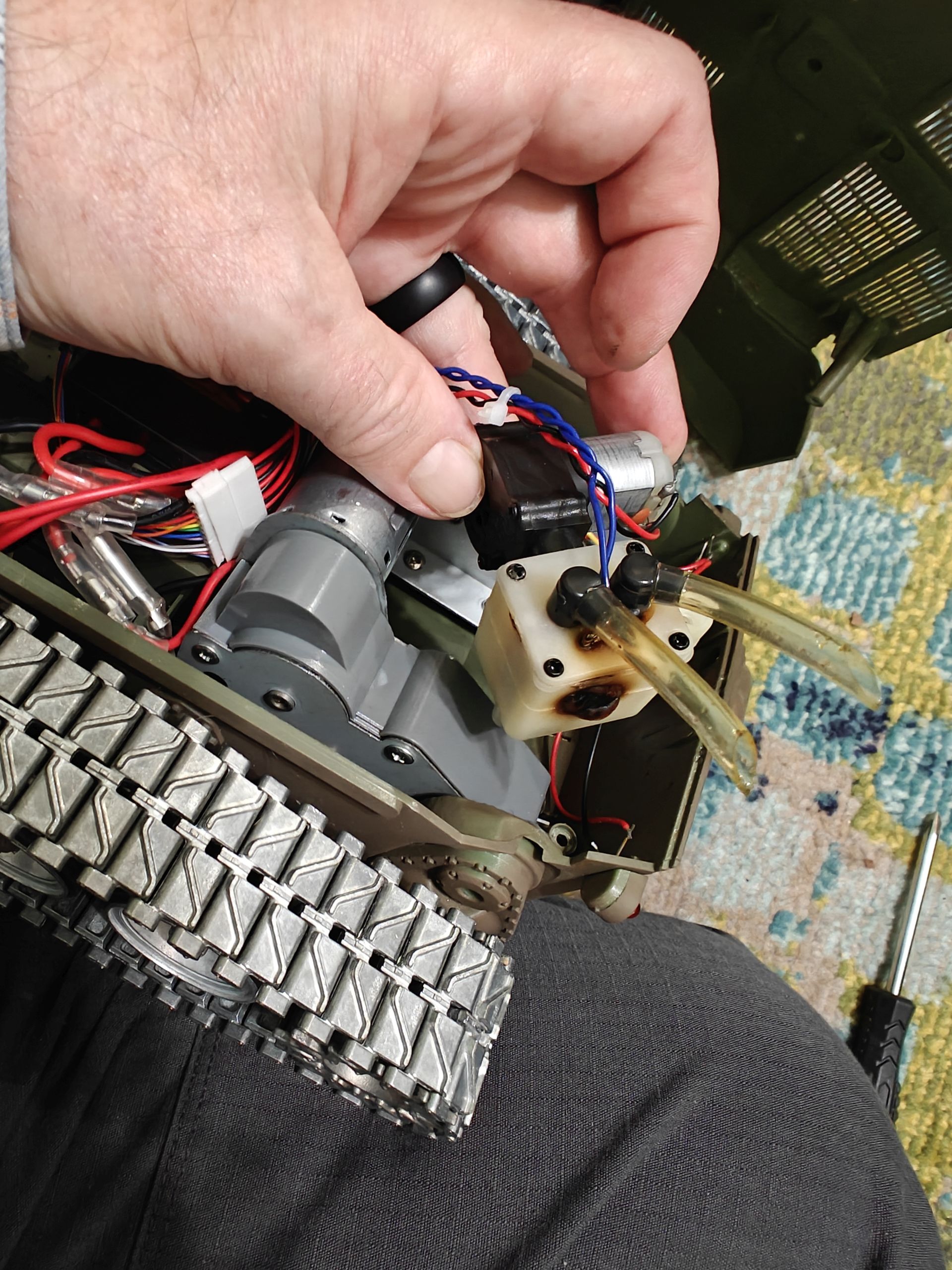

First of all, how janky is that little plastic syringe thingy they supply to refill smoke? It is hard to insert, kinks, and seems to block flow. Anyway, on to the real core of the question: Long story short, I fell for the hype and bought some Mega-Steam. After factory smoke started to dwindle, I put a few drops into the tubing (hard to measure, truthfully, with that janky syringe falling off the dropper). During this process, I noticed that the clear rubber hose seems to not fully "exit" the M26's exhaust (see pic). Is this normal?
Now, for the BIG question: Assuming I made the classic noob mistake of adding too much juice, what is the recommended way of evacuating it (hopefully without disassembly)? Just run it long enough? Flip the tank on it's back overnight? Turn it on its side? Blast compressed air into the exhaust?
Many thanks,
Many thanks,

2) I don't see any problem in your photo (well done) with the plastic tubes.
3) I know of no way to clean out a smoker except to open it and soak up some of the oily fluid with cotton. Yet in over 25 years, I have never overfilled a smoker, train or tank. In that respect, I am just lucky. Until recently, the regularly-supplied tank smokers of HengLong or Taigen/Torro have four little screws that open the top for access. Then one enjoys going bananas trying to screw the little lid and gasket back in place.

I actually wonder if I got any juice into the smoke box, since there's now quite a bit on the rear bulkhead as you may be able to see shining in the pic. In terms of harm to the smoker box, which is worse? running it dry, or flooded?
Not long ago, before I knew anything about RC Tanks and I was researching here and all over the place, I saw someone post a photo which I believe they said was an easy fix for smoke boxes. If I understood it correctly, they had drilled a hole in the top of the box, between the two outlet pipes. Seemed legit to my ignorant eyes I guess, but for the life of me, now I cannot find that post/photo/thread.

I would open up the hull and clean up the spilled fluid using a paper towel for now. Then I'd get some JT's b-Gone pronto and go back at it like a careful, anal-retentive idiot. Well, maybe I exaggerate a bit. If you have hobby store nearby (unlike me) that serves model train addicts (like me), it may handle JT's products.
I have not seen the idea you noted to drill a hole between the two smoke outlet tubes. The fluid could leak out. I have seen some of the smokers with a third opening and a little black rubber-like plug. I like those, but one still may need to open up the hull to get at the access. The syringe you show above may be one of those safe ones for squirting medicine down a child's, cat's, or dog's throat. I had not thought of using a safe syringe. I have stupidly used unsafe ones: don't!

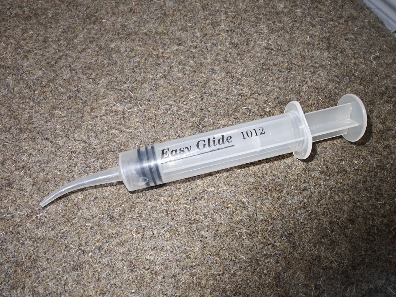

Re: HL Smoker (noob) issues [tubing not lining up? flooded?]

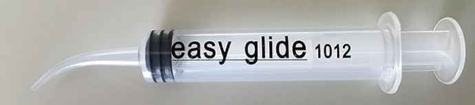

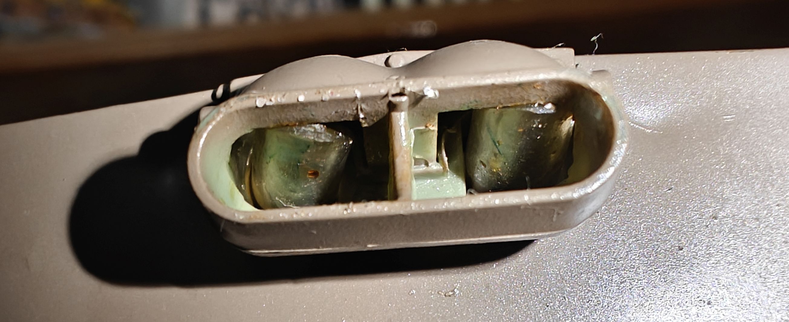

Quick followup: I found the syringe pictured below in a "junk drawer". Figuring I had nothing to lose, I injected the amount shown in the photo into both exhaust ports. The curved tapering "needle" was able to get up into the hoses and deposit the juice without getting everywhere else. Fired up the tank and it was smoking again. Indeed, it had run completely out, and I was worried it would be permanently burnt up, but it wasn't.

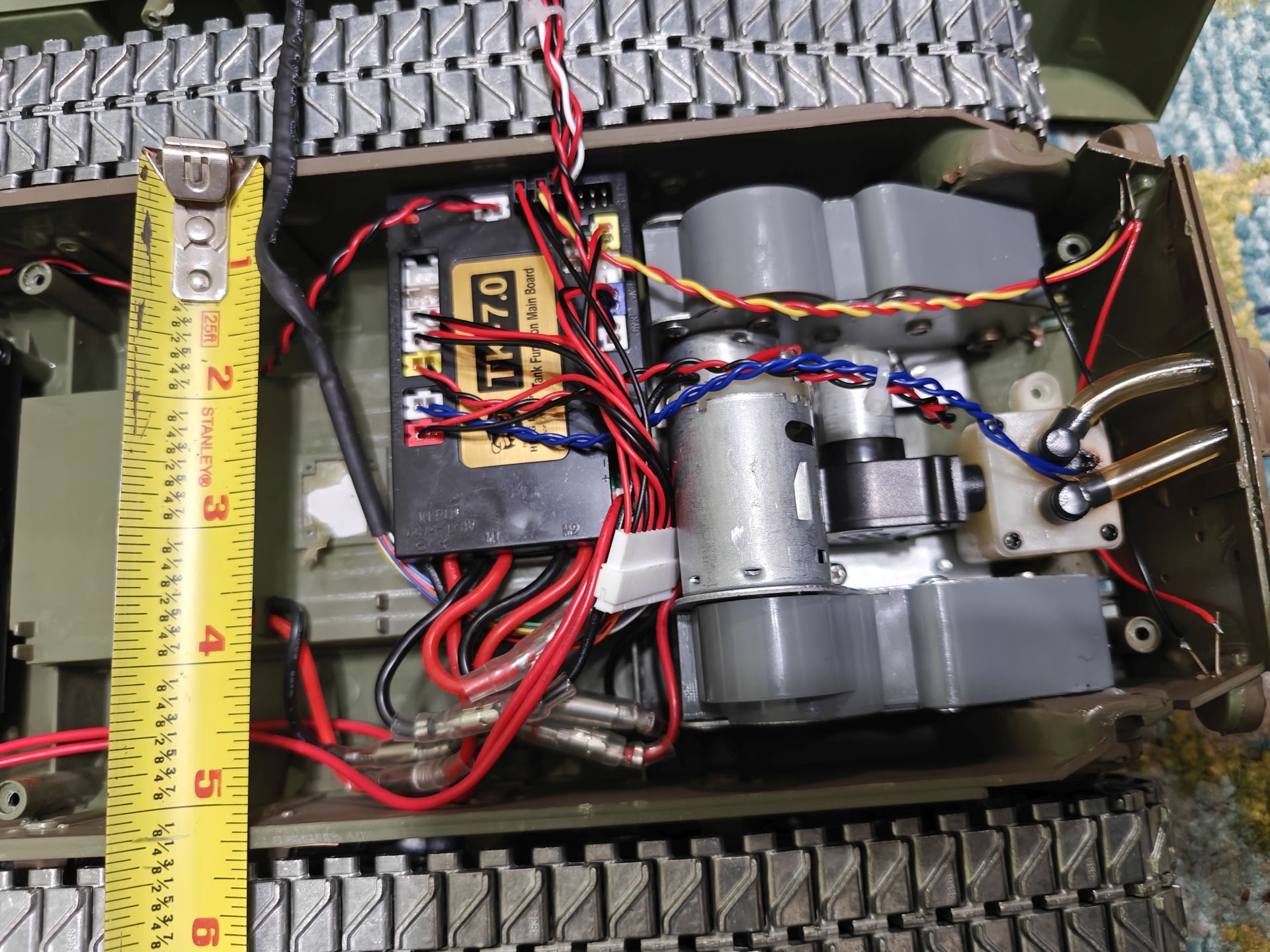

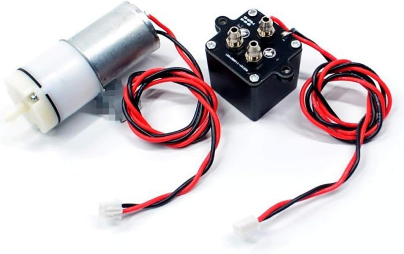

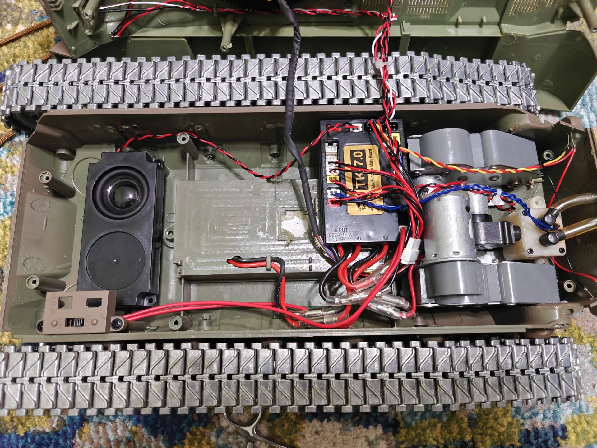

Welp, it appears I DID damage the smoker, but it still produces smoke. What is the conventional wisdom for mounting the metal replacement unit shown in the screenshot below? OEM unit has a pin that fits a recess in the hull, and a screw that goes thru a hole under the hull.
These seem to be available on a variety of websites, and multiple vendors on Amazon. Is it good?
