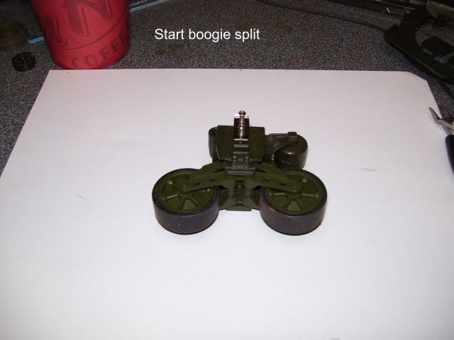

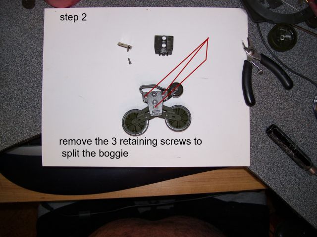

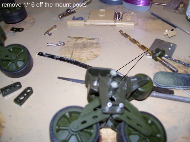

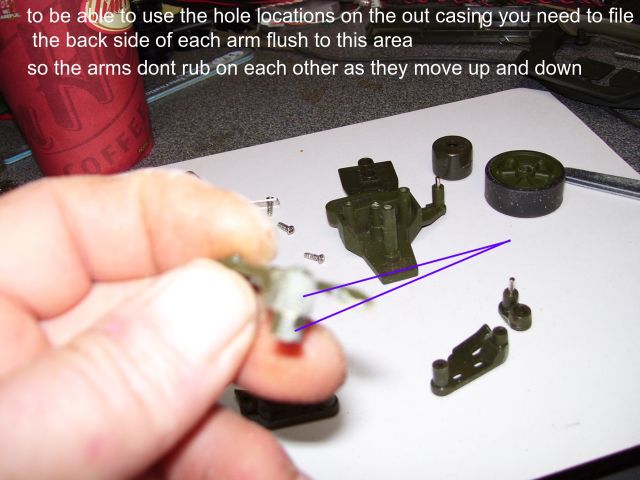

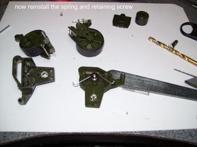

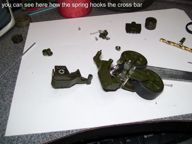

sherman bogie split and bogie mount on tamiya hull
bubbajoexx
Posts: 201
Joined: Sat Nov 22, 2008 8:58 pm

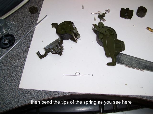

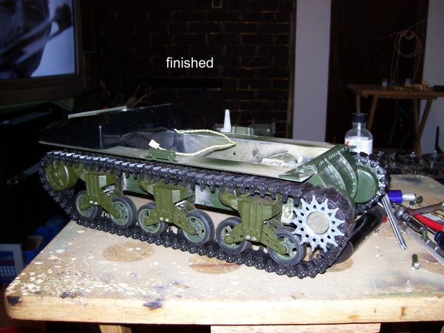

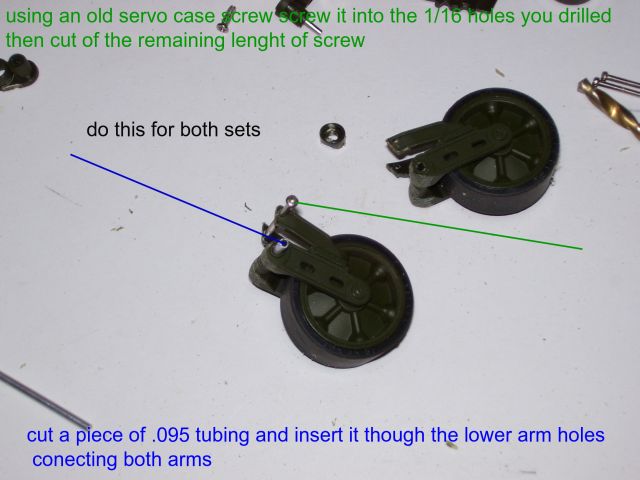

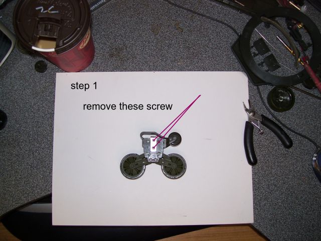

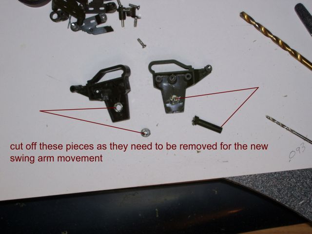

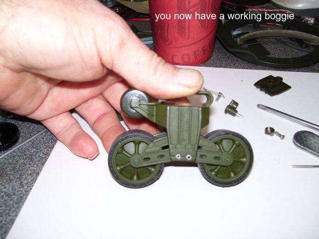

Post by bubbajoexx »

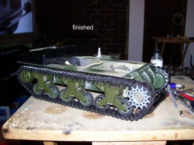

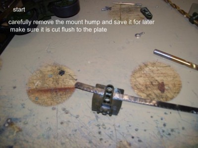

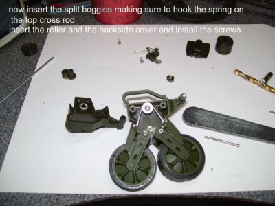

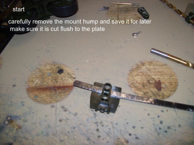

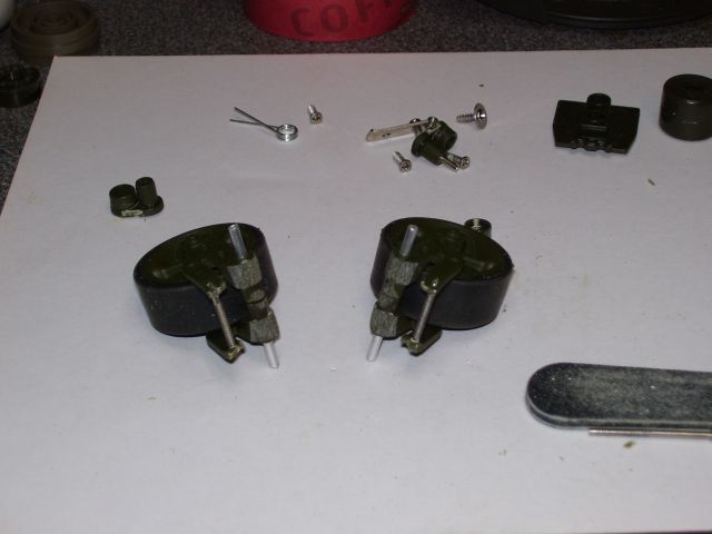

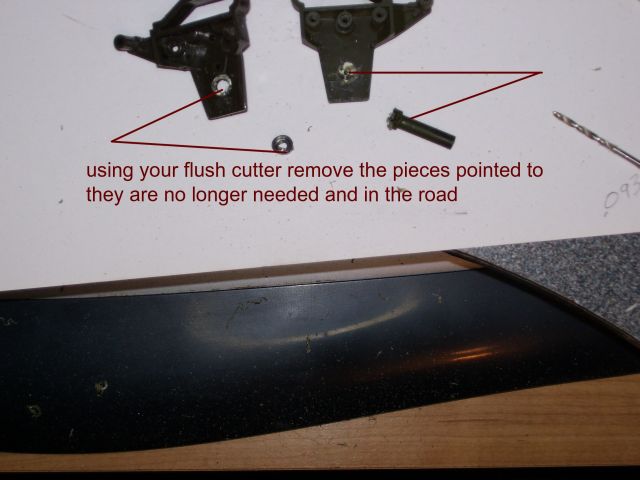

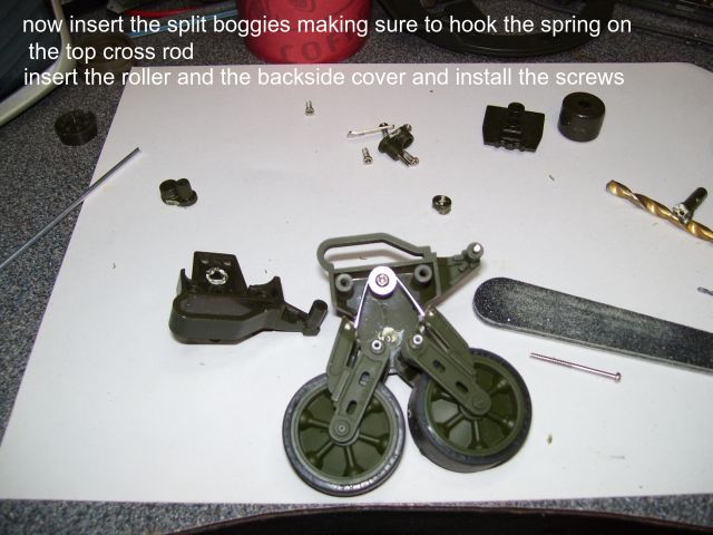

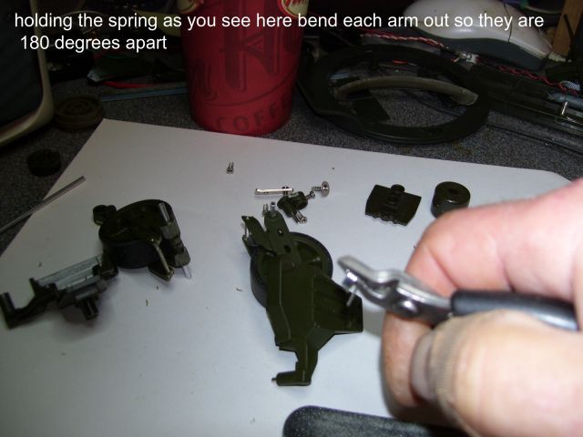

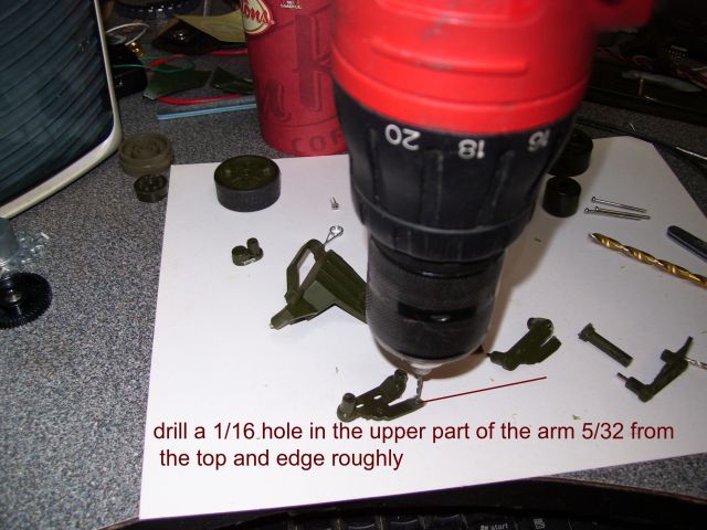

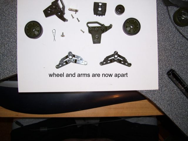

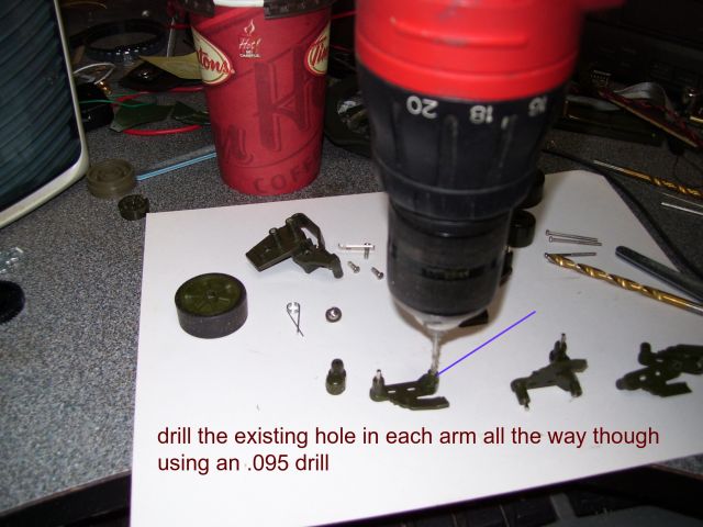

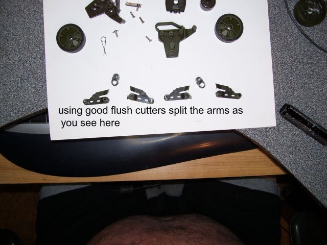

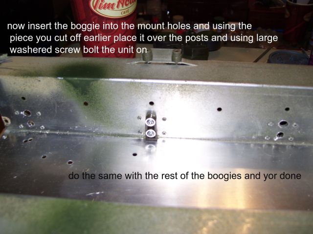

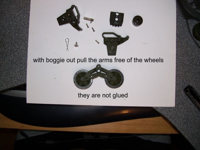

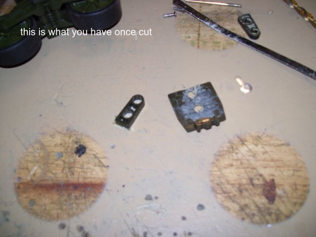

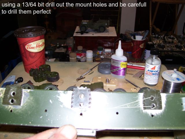

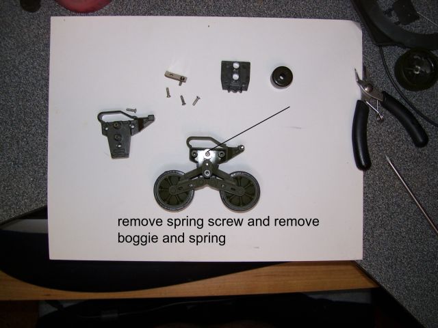

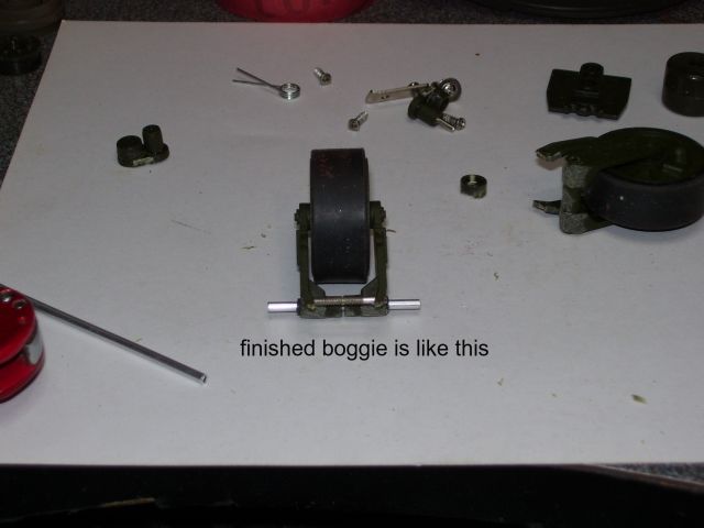

I am posting the split here if you cannot see the instructions clearly use the link below
bogie split is now posted on RCU as the pics are going to be larger for you to see as instuctions are imprinted right on the pics http://www.rcuniverse.com/forum/m_92206 ... tm#9220728
bubbajoexx
Posts: 201
Re: bogie split
part 2
bubbajoexx
Posts: 201
Re: bogie split
last pic instructions are imprinted on each pic
and a small clip
http://www.youtube.com/watch?v=93PYw2qUSDk
tankman
Re: sherman boggie split
Post by tankman »
An impresive "fix" for the Sherman bogies bubbajoexx. Thank you for posting
Alan
BREL
Posts: 2473
Post by BREL »
Bubba Nice work on fitting the VVSS to the tamiya hull

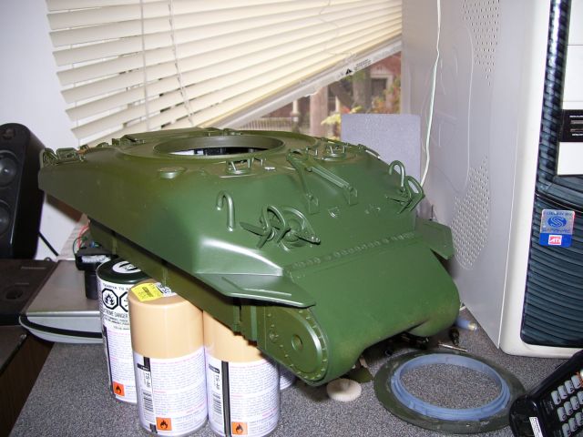

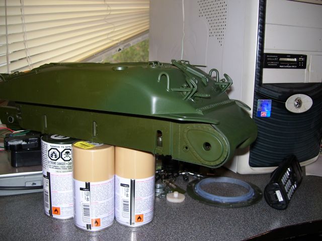

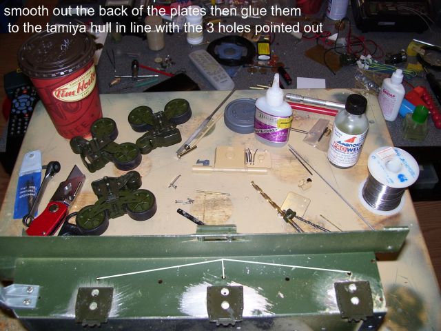

here you go next mod a Tamto mato tamiya hybread

trans cover replacement here are 2 shots of the new trns cover a simple fix using a tamiya cover on the mato hull will post the how to later today
you can see in the foto that the cover now lines up with the front fascia at the correct angle
wibblywobbly
Posts: 6396
Location: South Wales Valley
Re: sherman boggie split and boggie mount on tamiya hull
Post by wibblywobbly »
Just a quick question to clarify something. Does the Tamiya upper hull fit the Mato lower hull?
Rob G
971wright
Posts: 2733
Location: nelson Lancashire
Post by 971wright »
Hi And visa versa dose the mato upper fit a tamiya lower .
regards pete
bubbajoexx
Posts: 201
Re: sherman bogie split and bogie mount on tamiya hull
yes with only minor work very easy to do
