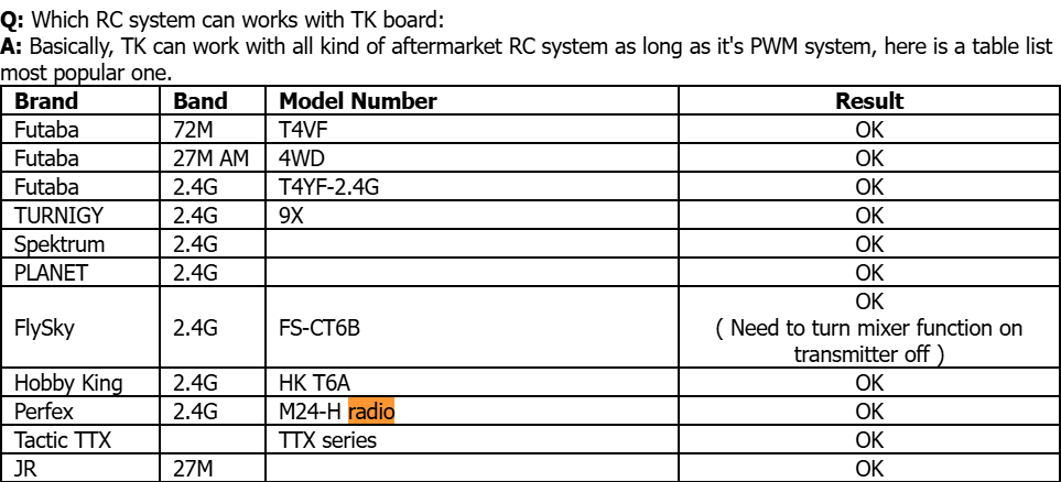

The issue you will run into is getting whatever new radio configured to use the functions of the Clark board. The Gepard is using a Clark TK50 board. I'm not sure what you Centurion has in for a control board. It may also be a Clark TK50 or it could be a Haya (re)branded board. The real issue about going with a transmitter that no one else is using with their Clark boards is that no one will really have any experience with that particular radio configuration. You will be basically on your own to get it to work.
Clark says the following have been tested with his boards, but some of these are really old and not SBus so I can't really comment on how well any of them will work at this point. Most of the newer TK50 boards are SBus.
- radio.png (77.56 KiB) Viewed 635 times
Gook luck!
