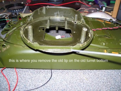

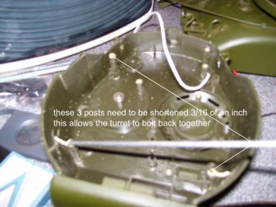

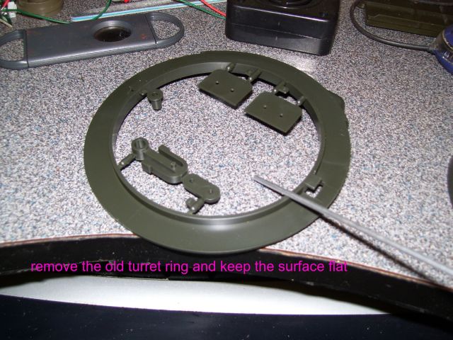

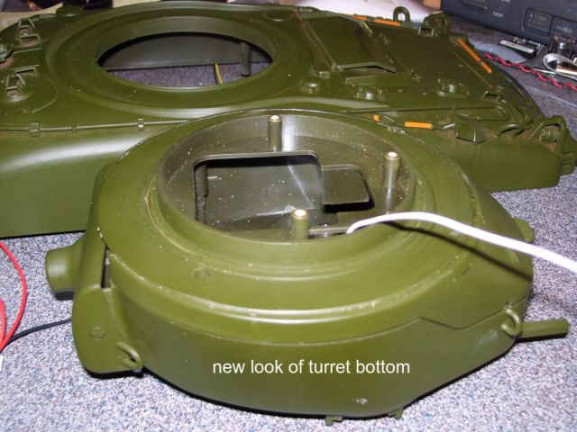

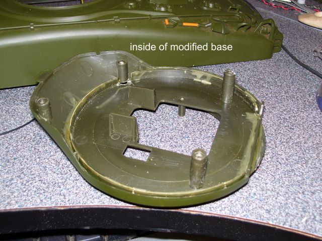

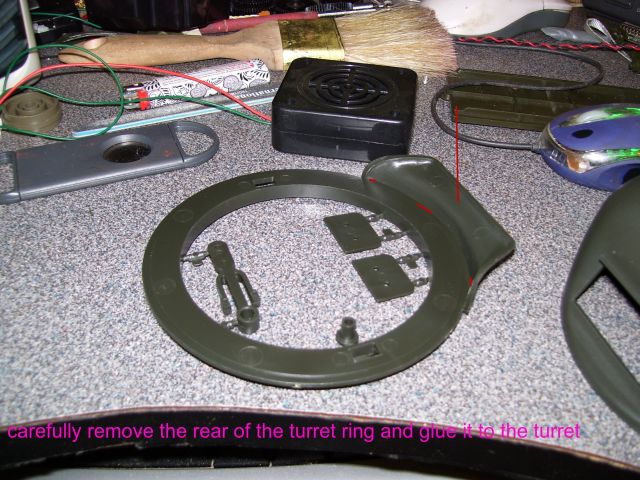

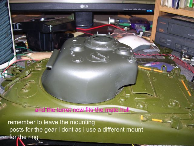

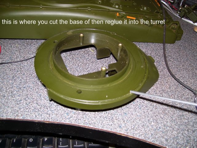

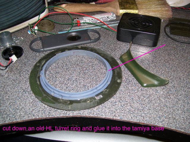

here is how to fix the turret you need to cut the buttom turret ring at the seam then reinsert it into the turret bottom and glue it solid if cut correctly it will slip right in once you cut the front lip of the ring then shorten the attaching posts in the top of the turret the same amount the ring has been rased

first calss work ....
will the standard iya tam turret ,, fit the hl turret ring ??
iain

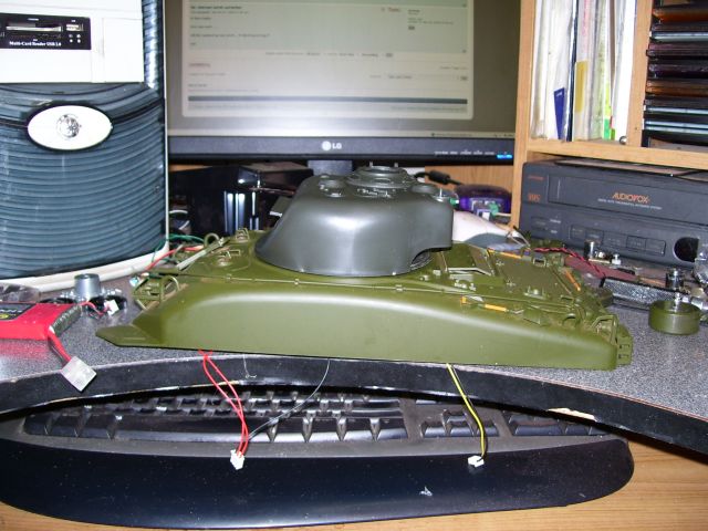

mcevoyi wrote:hi there bubba
iain
you mean tam turret on mato hull like this
mcevoyi
Posts: 2294
Re: sherman turret correction
Post by mcevoyi »
PERFECT BUBBA
yes thats the idea ... it opens up so many conversions prospects .....
you have changed my mind anout the sherman .. i will get one and have a play with it to see what kind of mess i get in to
thanks bubba !
