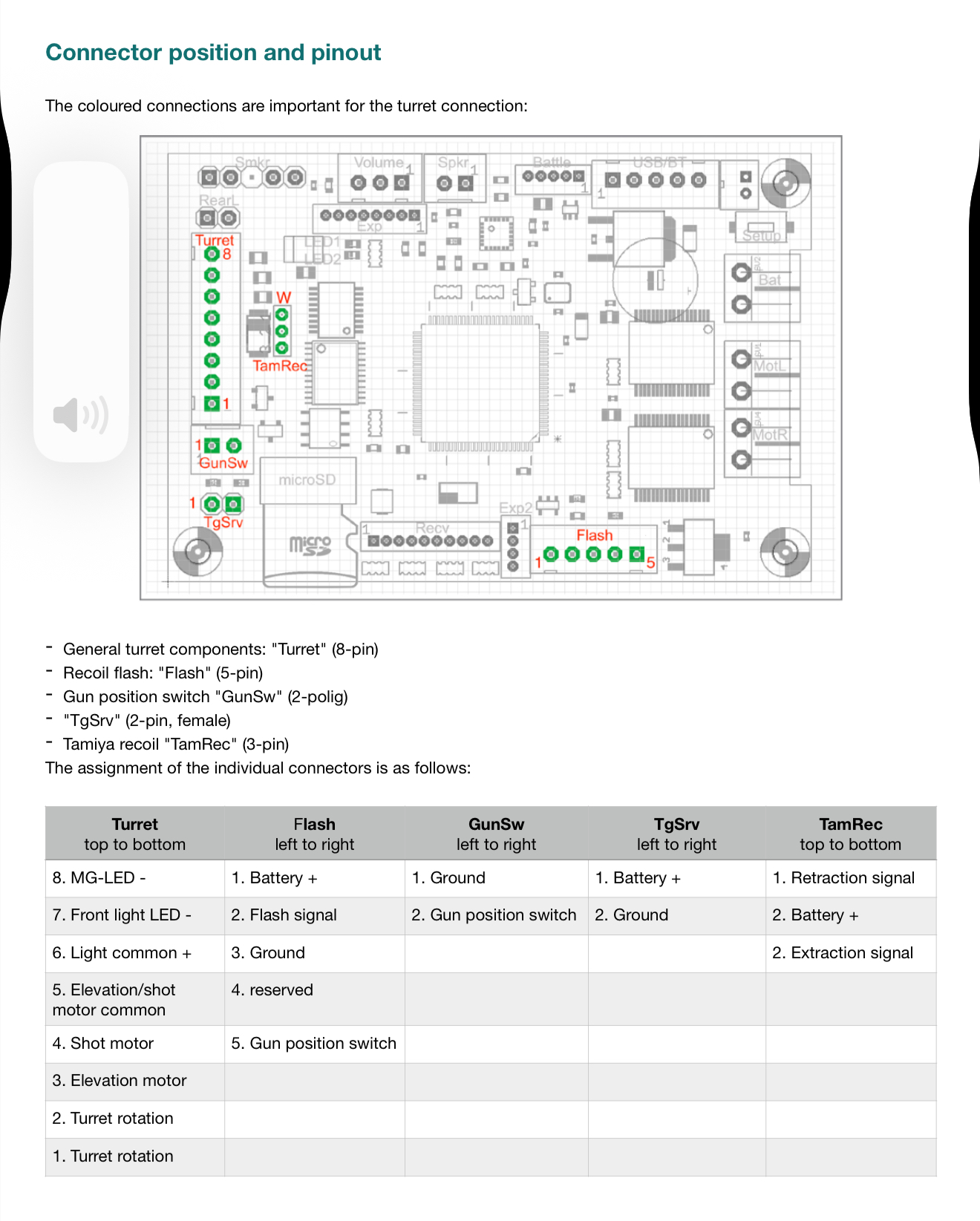

So looking at some PDFs it was partially off on my statement.
Taigen/Torro use a common positive wire for the elevation and shot trigger motors, but they each have their own separate ground. This is what goes through the slip ring
They also use a common positive wire for the hull machine gun and front headlight LEDS, and each of them have their own ground.
Again though they are keeping motors and LEDS on separate circuits. Gun muzzle flash is also on its own circuit.
This is for connecting an ElMod MFU to a Taigen/Torro model, but it gives you the gist of what’s going on with the wiring.
