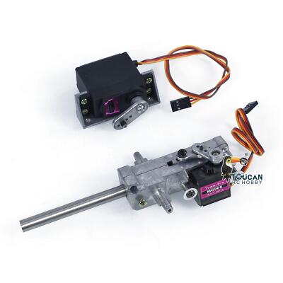

I better askk before I
buy one .
Can a clark TK 50s run 2x ESC's for left and right drive motors ? Run a Servo for gun recoil and a Servo for Gun elevation .
Re: TK-50S
Posted: Sat Oct 04, 2025 7:59 am
by tankme
gabedrummin wrote: Fri Oct 03, 2025 10:14 pm I better askk before I s-l400.jpgbuy one .
The TK50 doesn't support external ESCs that I know of. It can use a servo for both gun recoil and gun elevation. It wouldn't have any issues running that setup.
