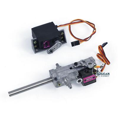

I better askk before I buy one .
Can a clark TK 50s run 2x ESC's for left and right drive motors ? Run a Servo for gun recoil and a Servo for Gun elevation .
Re: TK-50S
The TK50 doesn't support external ESCs that I know of. It can use a servo for both gun recoil and gun elevation. It wouldn't have any issues running that setup.gabedrummin wrote: ↑Fri Oct 03, 2025 10:14 pm I better askk before I s-l400.jpgbuy one .
Re: TK-50S
You shouldn’t need external speed controllers for that scale, you should be able to use the Clark board’s built in speed controllers.
