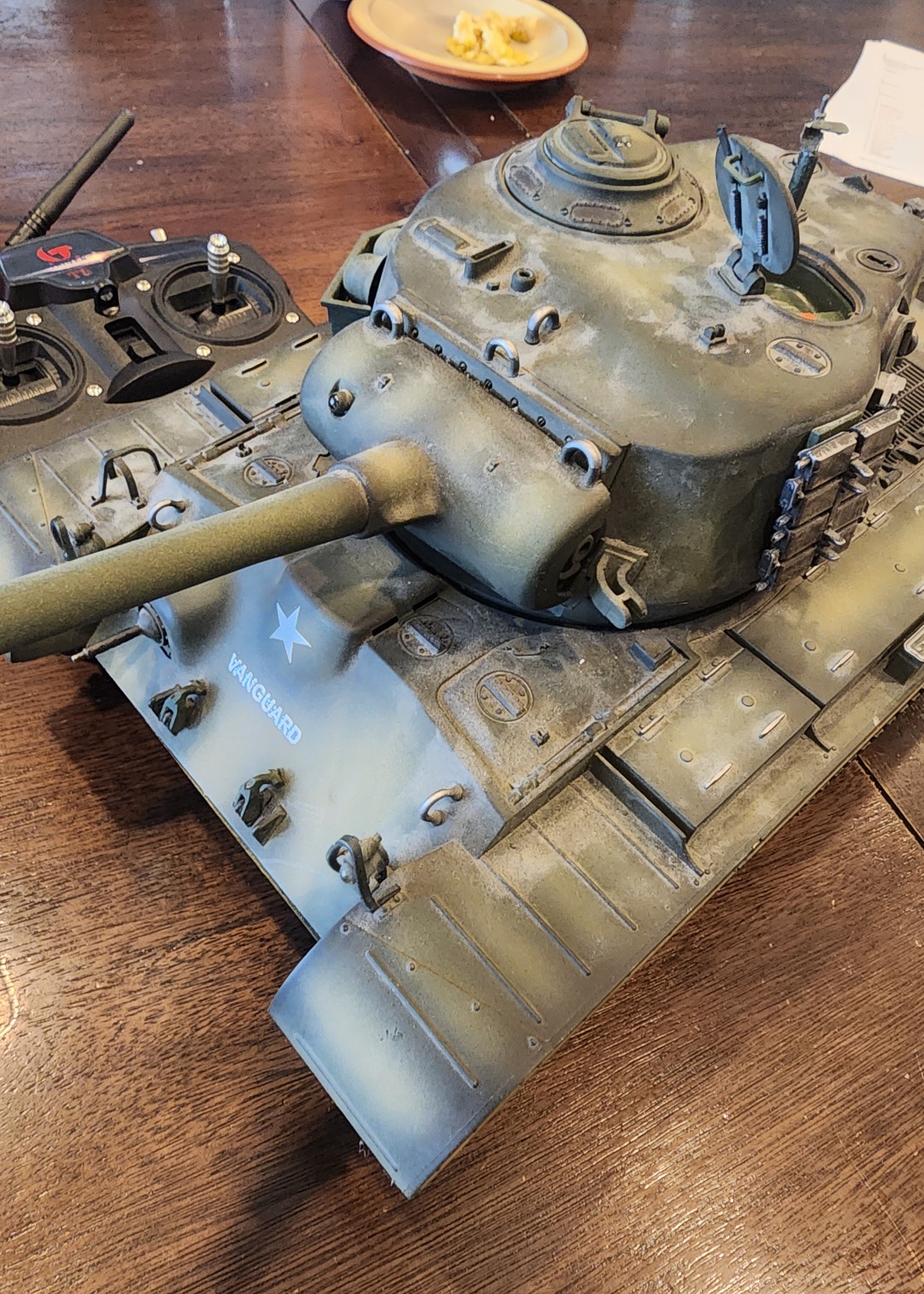

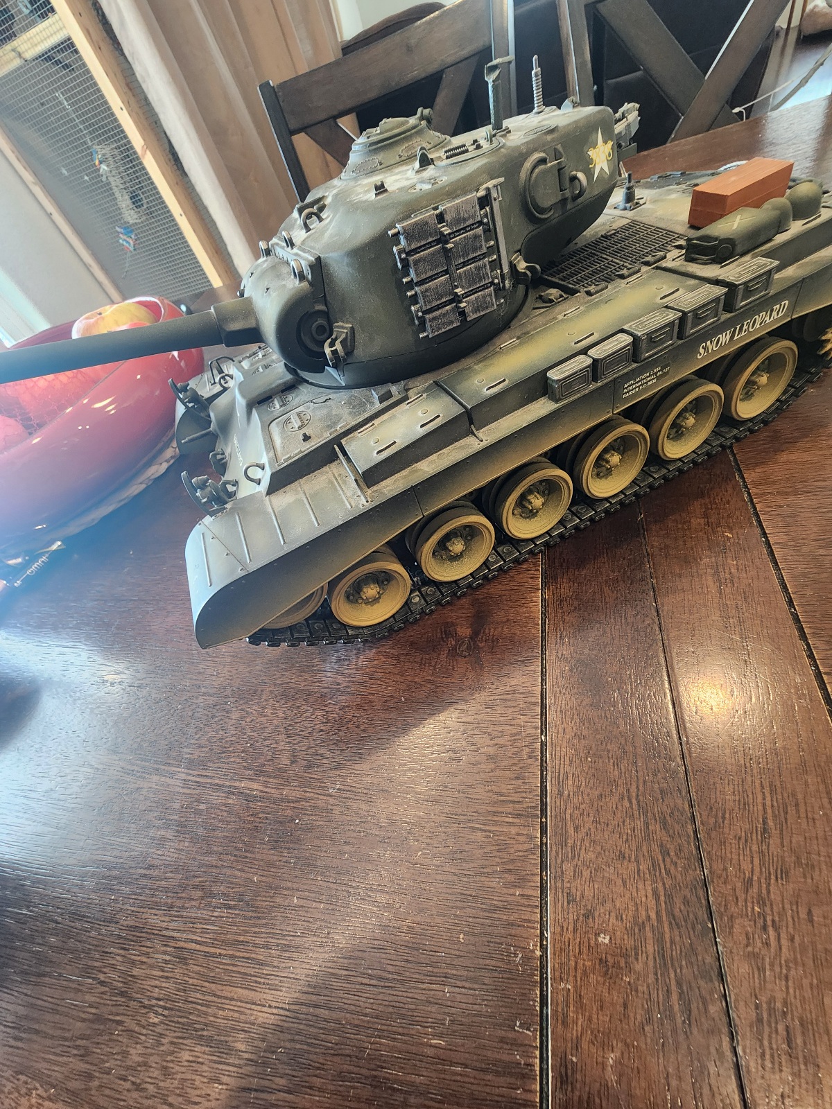

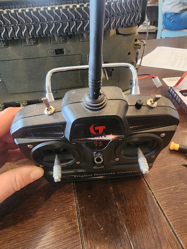

Added more photos.
Posts: 11864
Re: 3838 1/6 snow leopard by taigen
Ahh
It’s a V1
