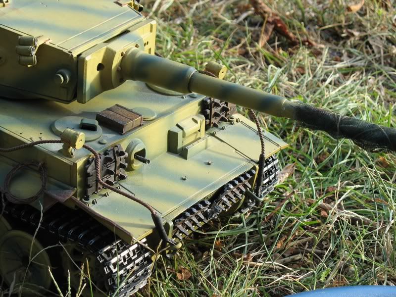

I know that most of use are unhappy with the plastic Heng Long towing hausers as supplied with their tanks.Most of the pictures that you see of Tigers, they have the hausers already attached to the towing eyes to save time and lives if they are needed, during combat. People tend to cut the ends off and then make their own wire to attach to the hollowed out Heng Long towing eyes. Personally I use a gauge of wire that is similar and then cut the wires to length. I then clamp one set of ends in a bench vice and put the other ends in an electric drill chuck and then push the button to ' twist' the wire until it looks about right, then cut it to length and add the ends.

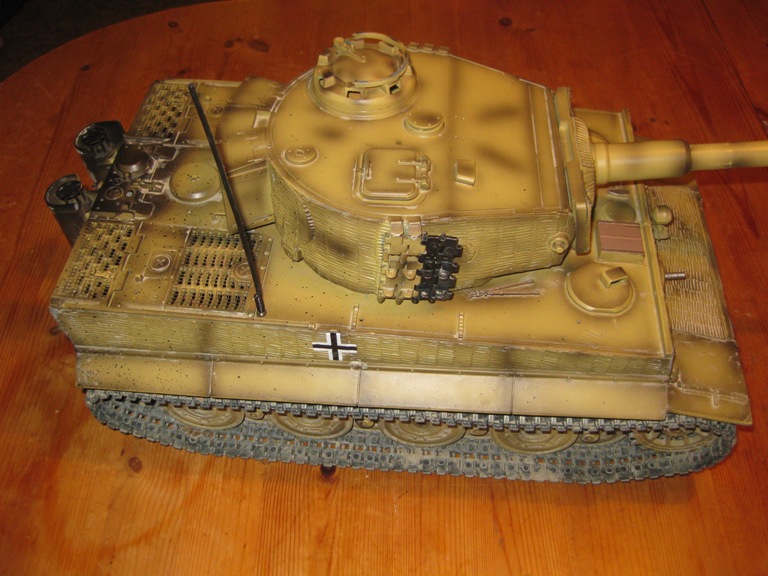

NOW ! for the EXTERNAL AERIAL......if you look at the pictures 3 and 4 of the rear deck of my Tiger 1 you will see the hauser,now look just behind the wooden crate and in front of the X-shaped deck opening fitment.....can you see the slight irregularity in the Hauser ? That is where I soldered the thin aerial wire from my control board onto the hauser. This way I have a copper aerial that runs completely around the Tiger giving excellent reception but still manages to remain almost invisible !
