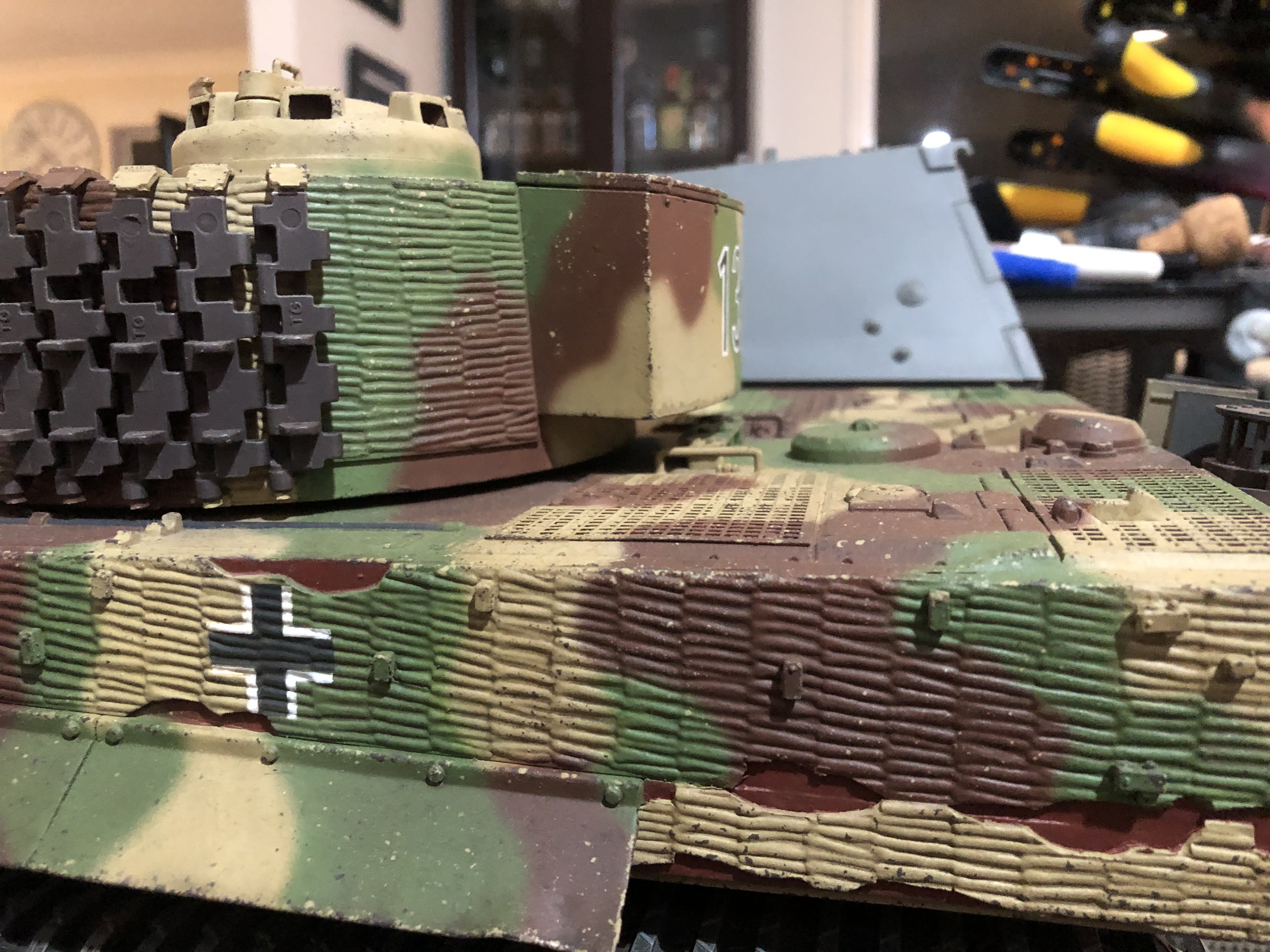

Right front guard missing, seemingly 2 toolboxes on the right side one partially covering the Balkankreuz,, no rear guards and camo netting on the right front corner of the casemate.
Even the box is imposing :crazy:
"Got Mit Uns"& away we go ;)

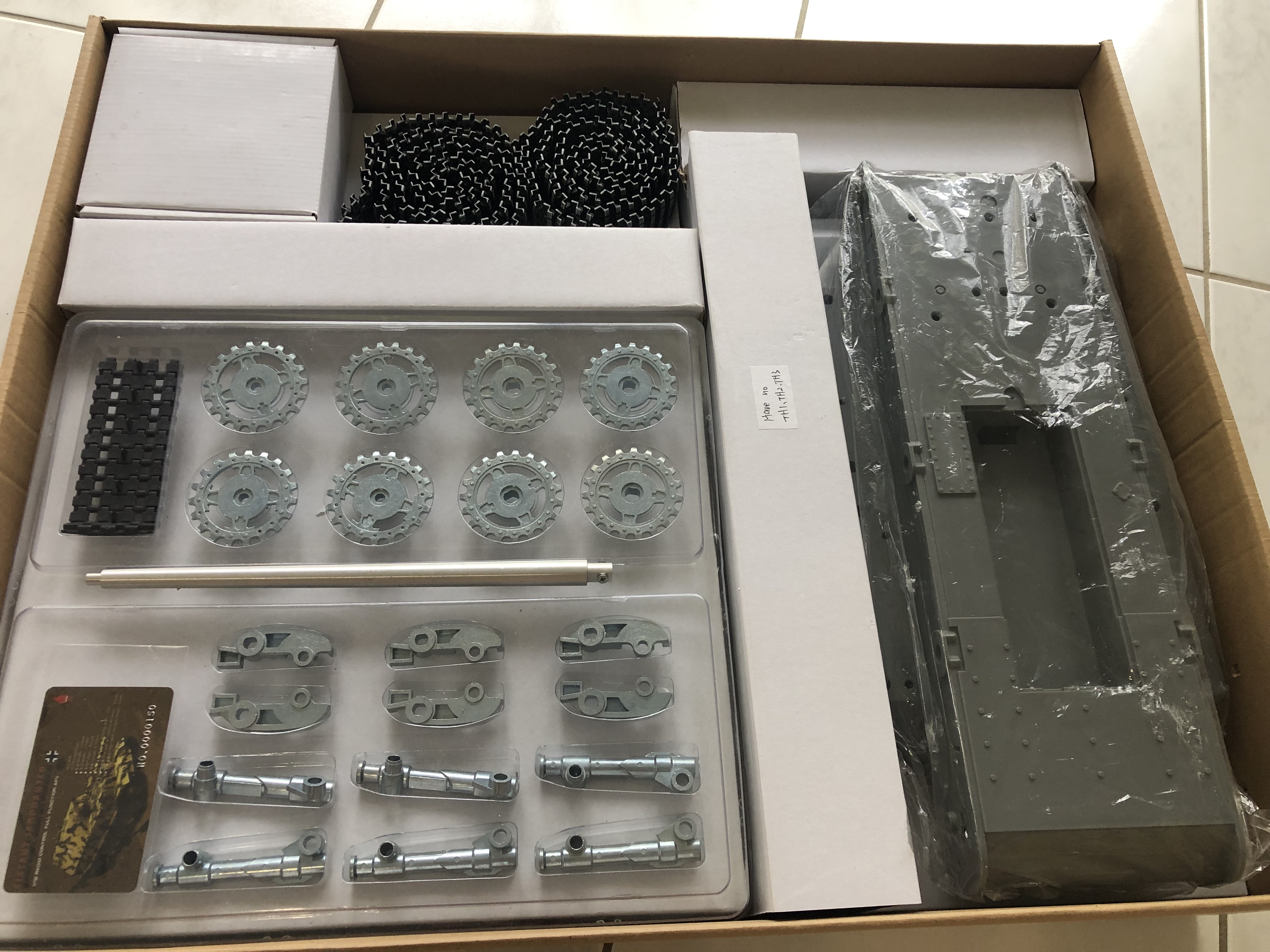

And on opening the lower hull out of the plastic bag I see its dated 2010.
Let the games begin !!

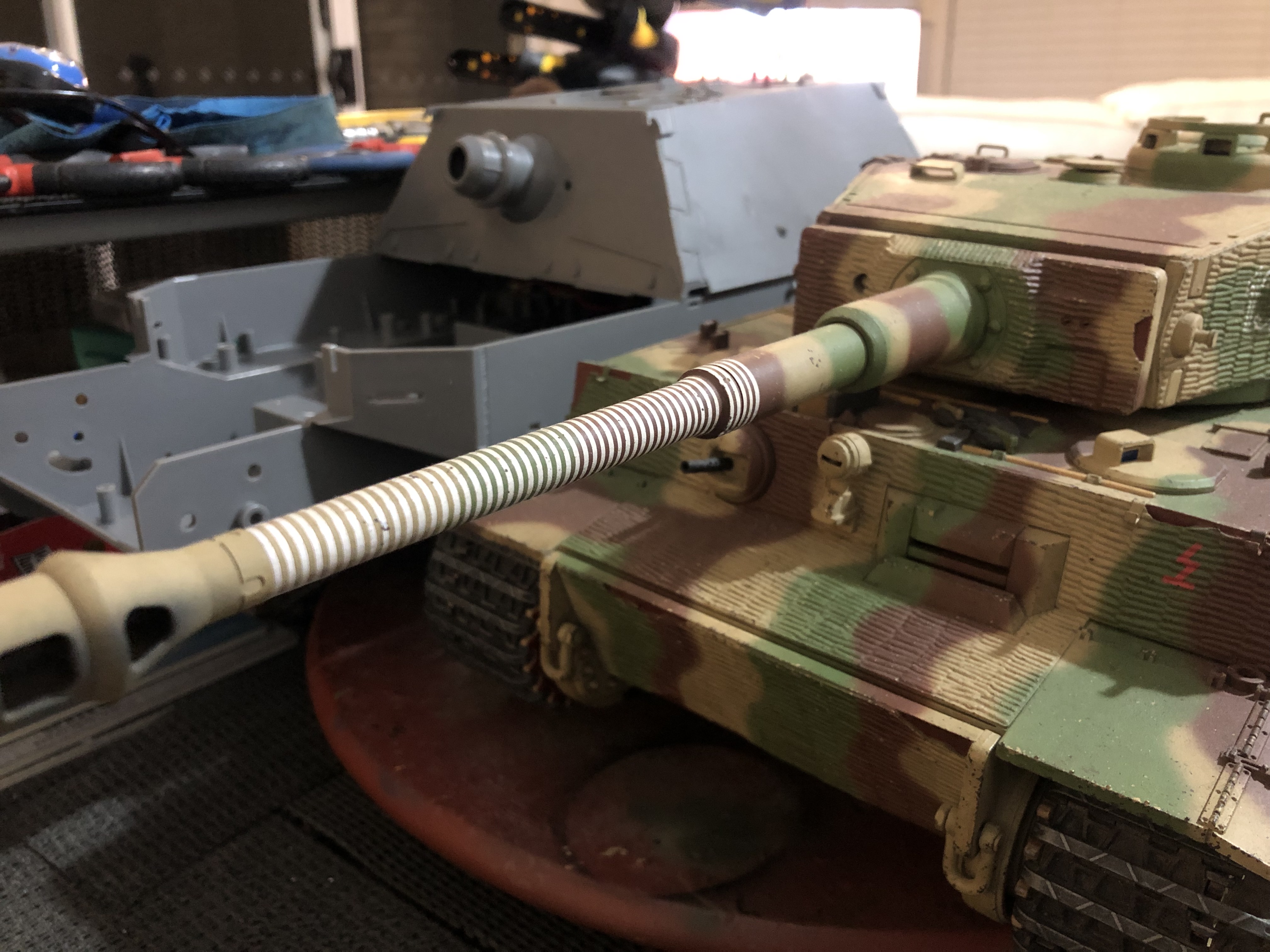

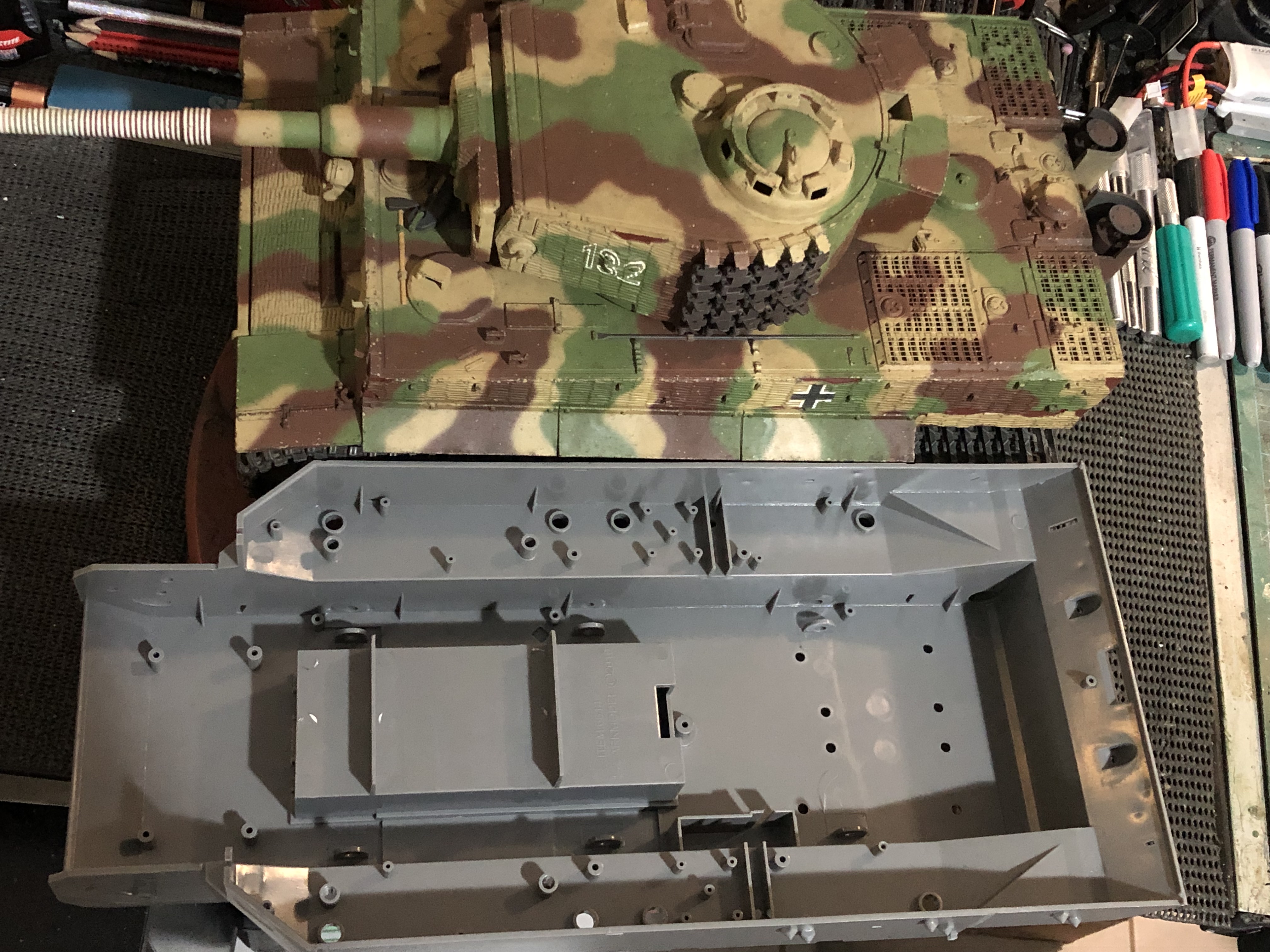

For those that have not seen a 16th Elefant at all, heres a scale comparrison...........
Taigen Tiger 1
Hooben Elefant lower hull
A fearsome weapon in its day, but jeez, no wonder they were shell magnets :/

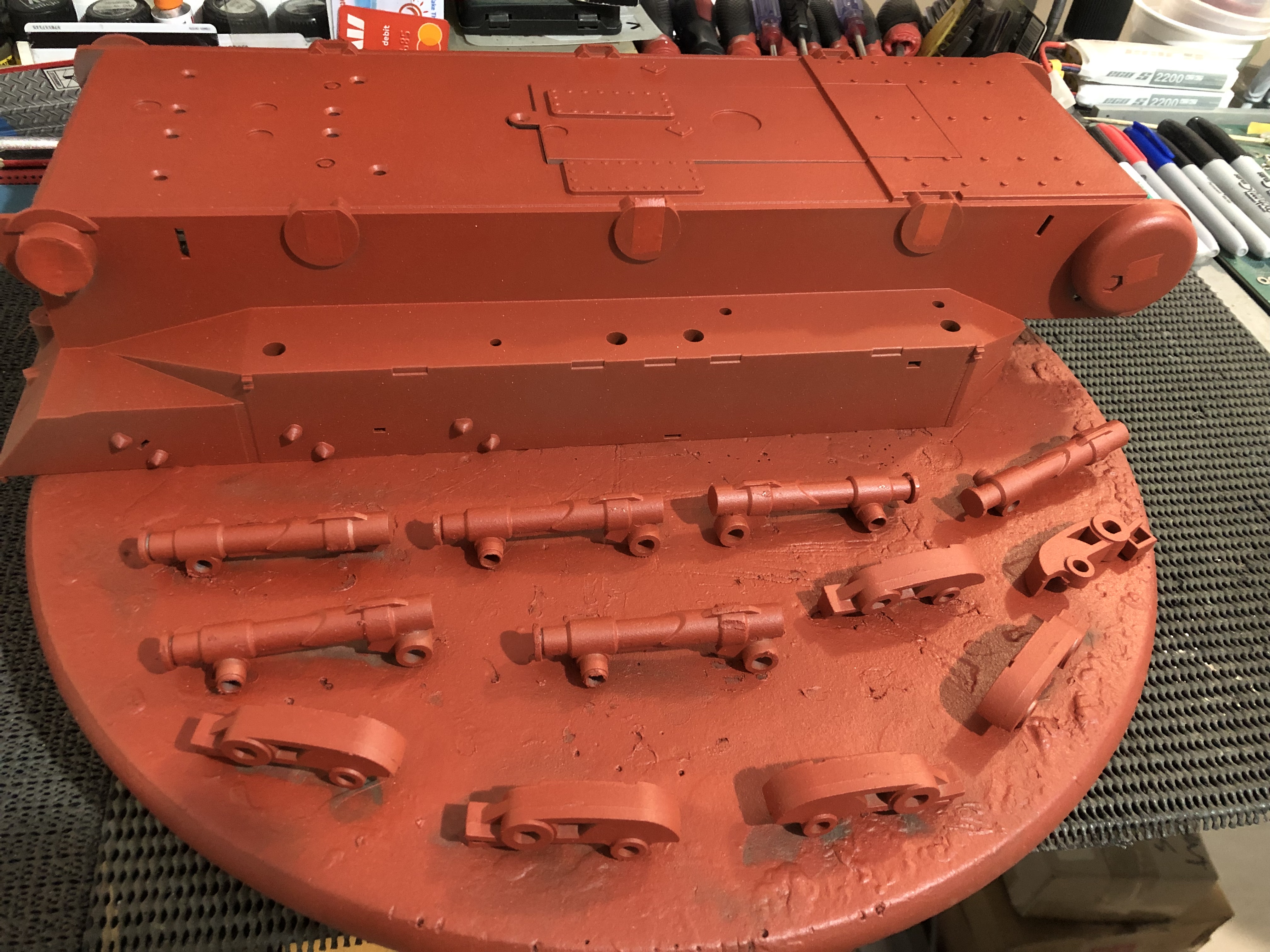

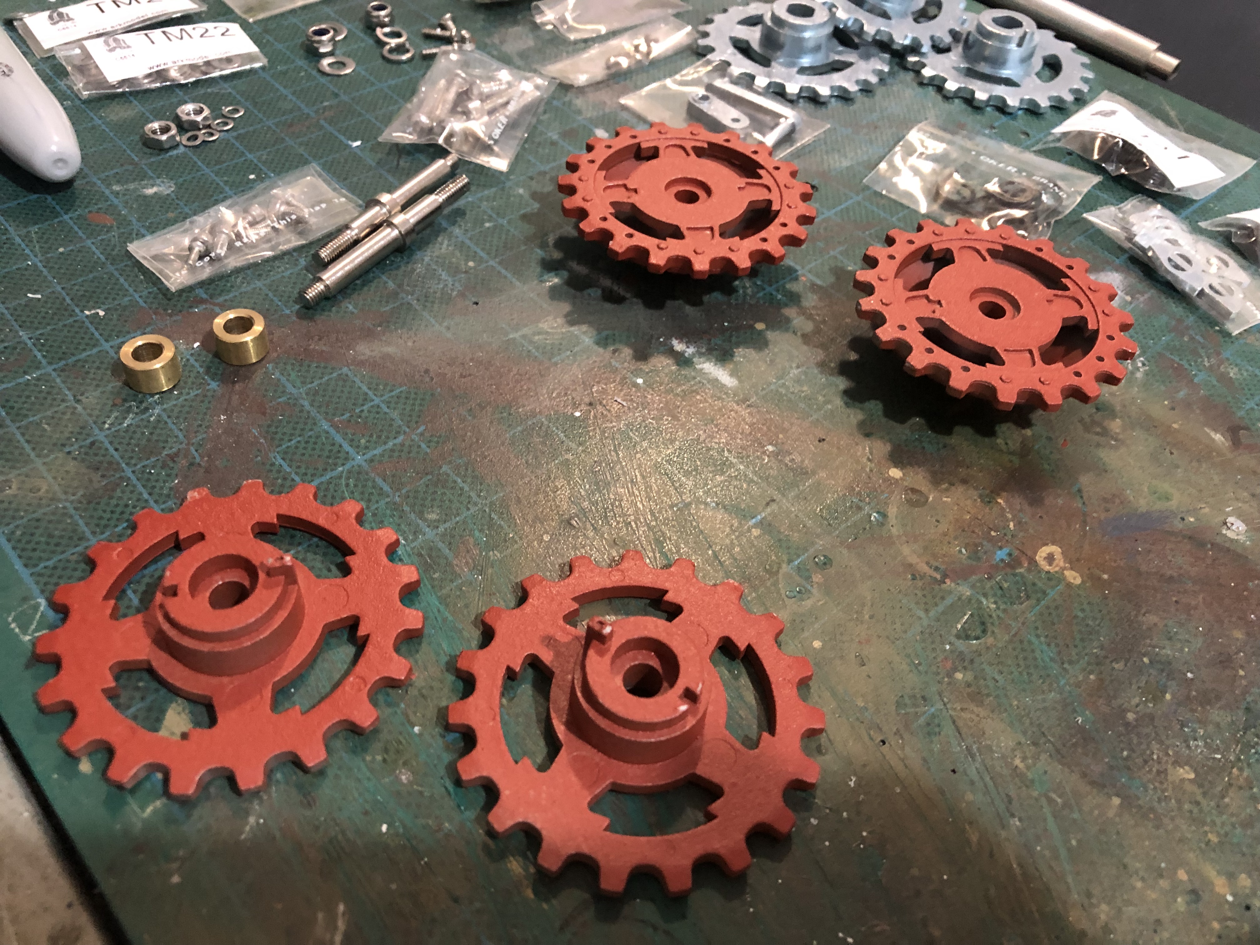

AAAAaaaaaaannnnnd heres the first one :'(

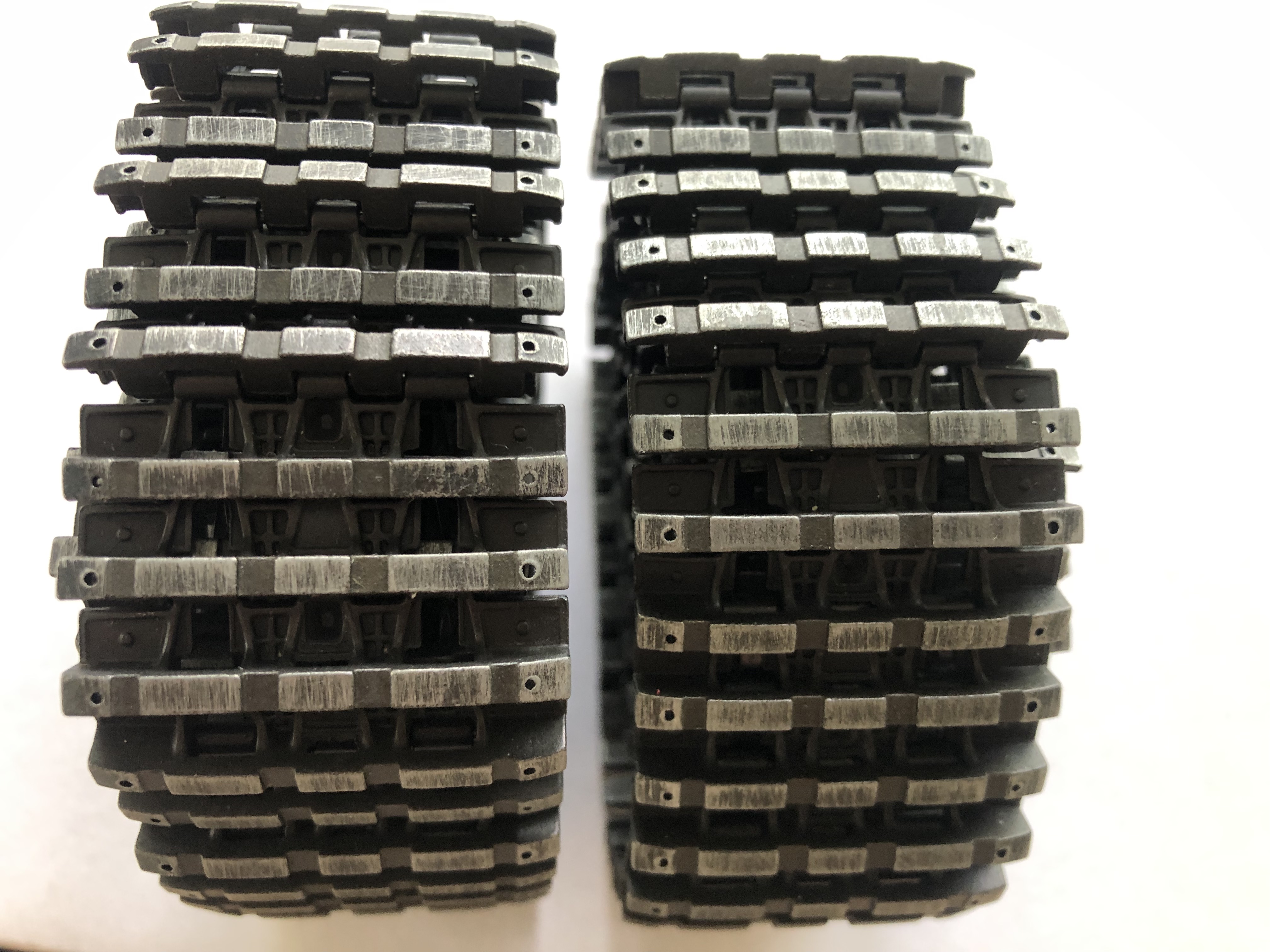

The precious tracks I got years ago from a guy in Rome, the early ones that turn out to be Asiatam...............
Dont fit the sprockets :headbang: :headbang:
The sprockets are too wide.
I will need to delicately machine the tooth rings thinner on the inner and outer faces or each set to fit the track drive slots.
I can do/get this done, luckily, as aside from some minor nuances between turning a later Elefant into an early Ferdinand, if the tracks aint early, its not a Ferdinand & thats a non-negotiable for me.
There appears to be enough meat in the sprockets to allow sufficient thinning without risking failure, but again, the amount of use this thing is likely to see will negate the risk of wearing them out !!

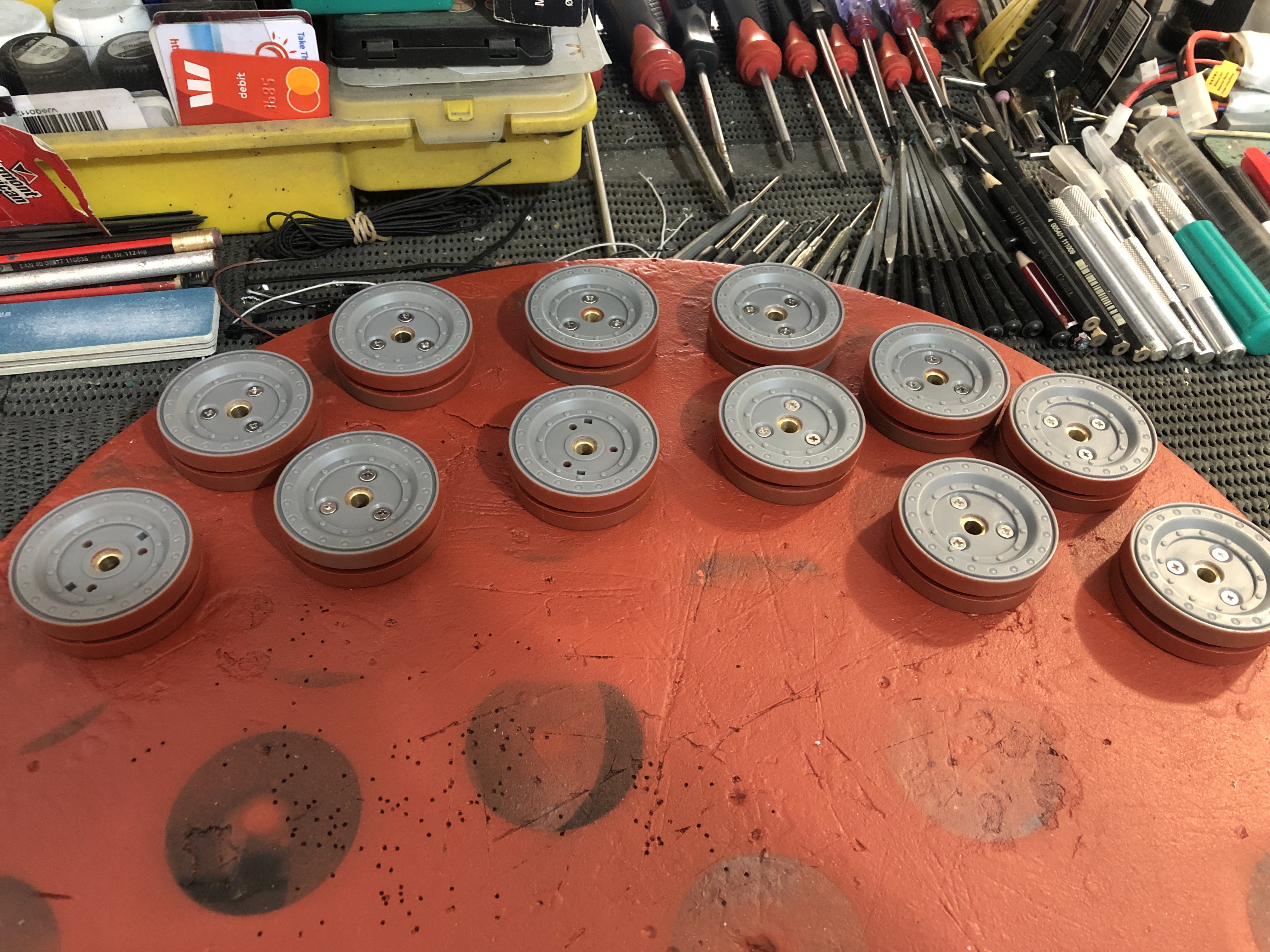

Another surprise :O was finding out that the gap in between the roadwheels of the stock set is too tight to go over the Asiatam track guide horns :-< Another punch in the face, but one I can wipe the blood off & go again next round....
I even managed to get primer on the lower bits I need to fit that wont take paint real well, nah, I just needed some semblance of progress to offset the hassles i've highlighted.
Bloody thing is like a PzIV :/
