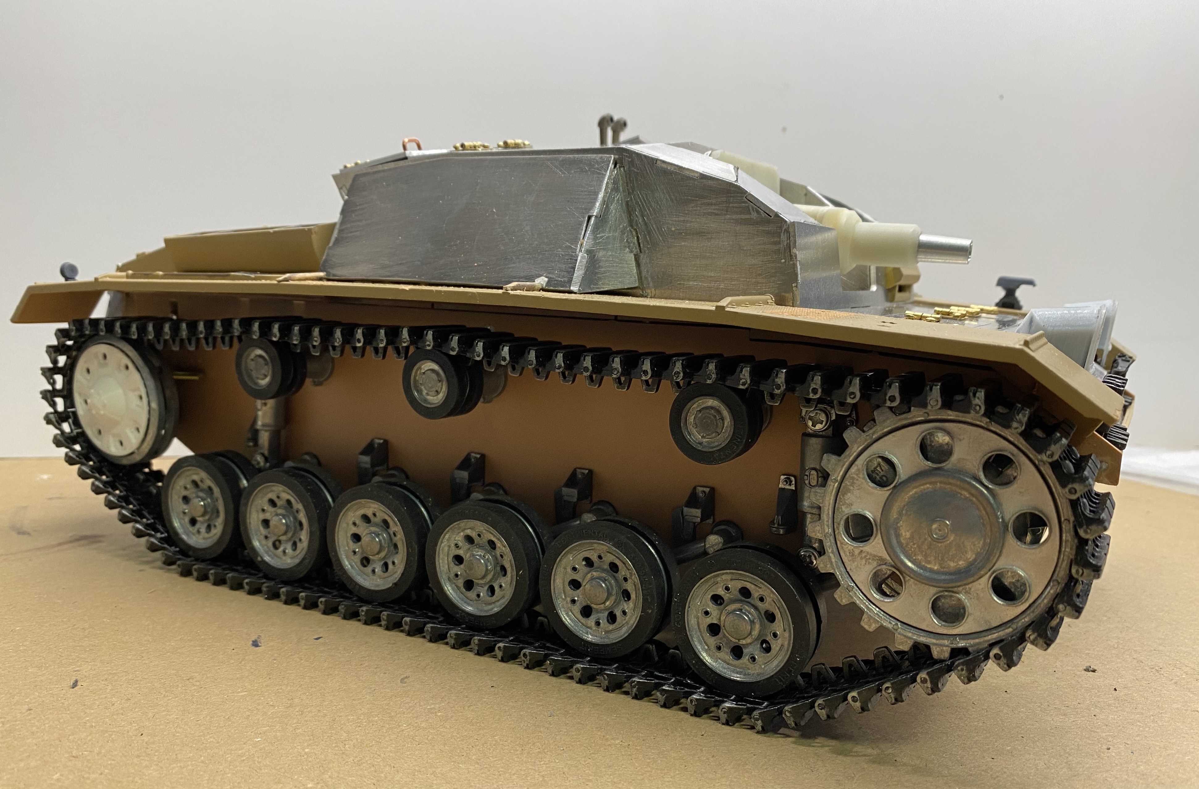

Hi Dave.
Firts of all, welcome on here!
Well, I happen to own 5 StuG's.
Depends on what you want to do, there are lots of things which you can change or add.
In the Show Off section is one of my StuG's with 8 figures on it, so you can see what can be made of a simple, stock, plastic Heng Long StuG.
I added a railing, Zimmerit, Saukopf mantled, side armour made of aluminum and their hangers out of brass.
Took the front light off, StuG's did not have that, just the Notek on the bow.
When you go to the build section StuG, there is my current StuG project with topic name New Project.
This also is a Heng Long plastic StuG, bought for €128 shipping incl, from Aliexpress.
On this one I put Winterketten with metal sprocket and idler wheels, added a Saukopf, made a brass railing, and made the hangers for the side armour out of brass too.
The most time consuming on this one was repositioning the 6 return rollers.
From front to rear they need to be raised 3-5-5 mm.
But that is not necessary, just add schurzen and you won't notice they are at the wrong positions, or just leave it all the way they are which is okay too!
Check out my build/pics so you have an idea what is possible.
If you have any questions, just shoot me a message!

You hit the expert spot with Rob59, and no doubt other wizards will follow. I have not used a HengLong Stug upper with a Taigen/Torro lower, but generally the two are similar, so at least there is a chance that the only modification needed will be to devise a means to hold the hulls together (e.g. magnets). Here is something to consider: will you use the HengLong electronics or those in the Taigen/Torro? The former offers easier control of motion, especially, but not only steering. The latter offers better sound.

BTW, I added a Taigen lower to a Heng Long upper hull.
Fits, no doubt!
Did that on my early StuG-Ausf.-A, where I put a Tauchpanzer III upper hull onto a Taigen metal lower hull.
Only thing you have to change is the way to fasten the upper onto the lower hull.
You could use magnets for example.

SWEET!! Thanks Rob thats exactly what Ill do..Ive been looking at magnets for the Jagdtiger and Amazon has crap loads ..I still have to go look at your work ..will later
