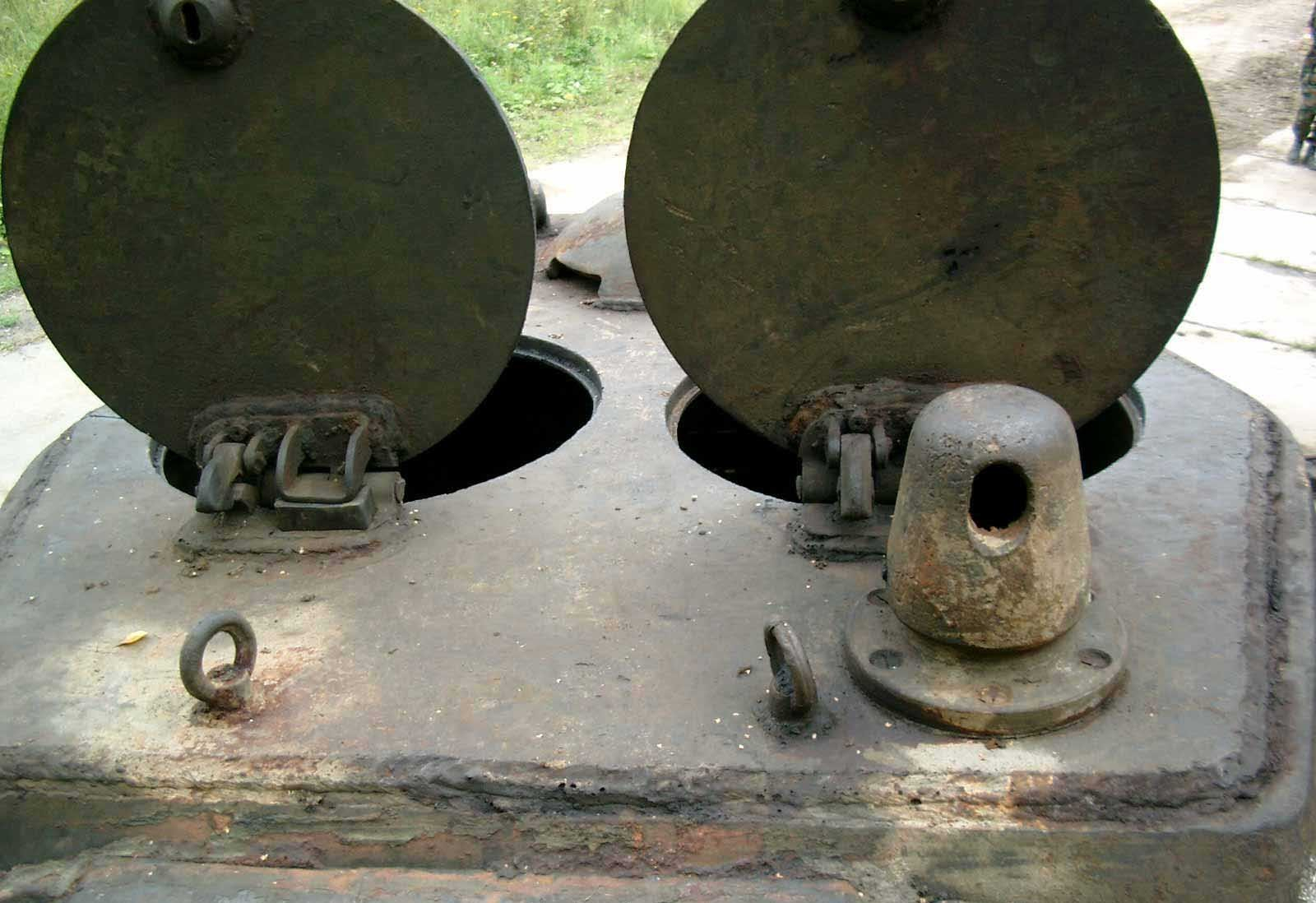

To open the hatch, effort was required! A key-hook was inserted into the hole of the lock and the lid opened, it was locked from the inside, it was impossible to open the hatch without heavy tools. The crews died inside, but did not give up!
https://tankist-31.livejournal.com/15966.html
Inside there is a locking lever that is turned through the hole and opens the hatch.

In the restored tank that is shown in your link that was pulled from the lake.
The metal is very pitted all over with corrosion.
Including the hexagon bolt heads on the turret hatches.
I assumed that these are original.
Is this correct?
I can't see anything that looks like a slot for a tool to be inserted in to.
What do you think?
Thanks
Mike.

Re: Soviet BT-5 question
Post by Pavel »
Yes, that's how it was before the war....
Nobody thought that by turning a wrench the enemy could open the hatch.
