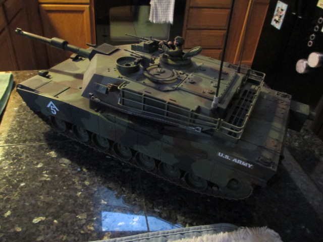

Posts: 7783
Re: Confused about Heng Long Abrams versions-NG needs some help!
Good Afternoon,
TankMe has the Right of it. My very first 1/16 tank after returning to the Hobby after 2000 was a Hobby Engine Abrams M1. I purchased it for the munificent sum of 69.00 used from an Online owner. I loved it and wore the tracks right off of it. It had some interesting features but was basically, a big RC Toy. There was a guy here on the Forum, ( Tankbear), who put a lot of Time into redoing the electronics on the Hobby Engine Abrams into something RC-like. After other Manufacturers started coming out with Tanks in 1/16 with regular RC, I don't think that Tankbear put any more effort into that type of Abrams. He was my source for a set of replacement tracks for mine. Heng Long had brought out their Tiger 1 and once I was able to get my hands on one, I was hooked for real and gave my Abrams away to a Friend to try to get them interested in Big Scale RC Tanks. So much more to chose from nowadays. Good Luck and Have Fun with whatever you get. ( Just don't get a Hobby Engine Abrams ;0)
Golden Oldy.JPG (110.05 KiB) Viewed 928 times
