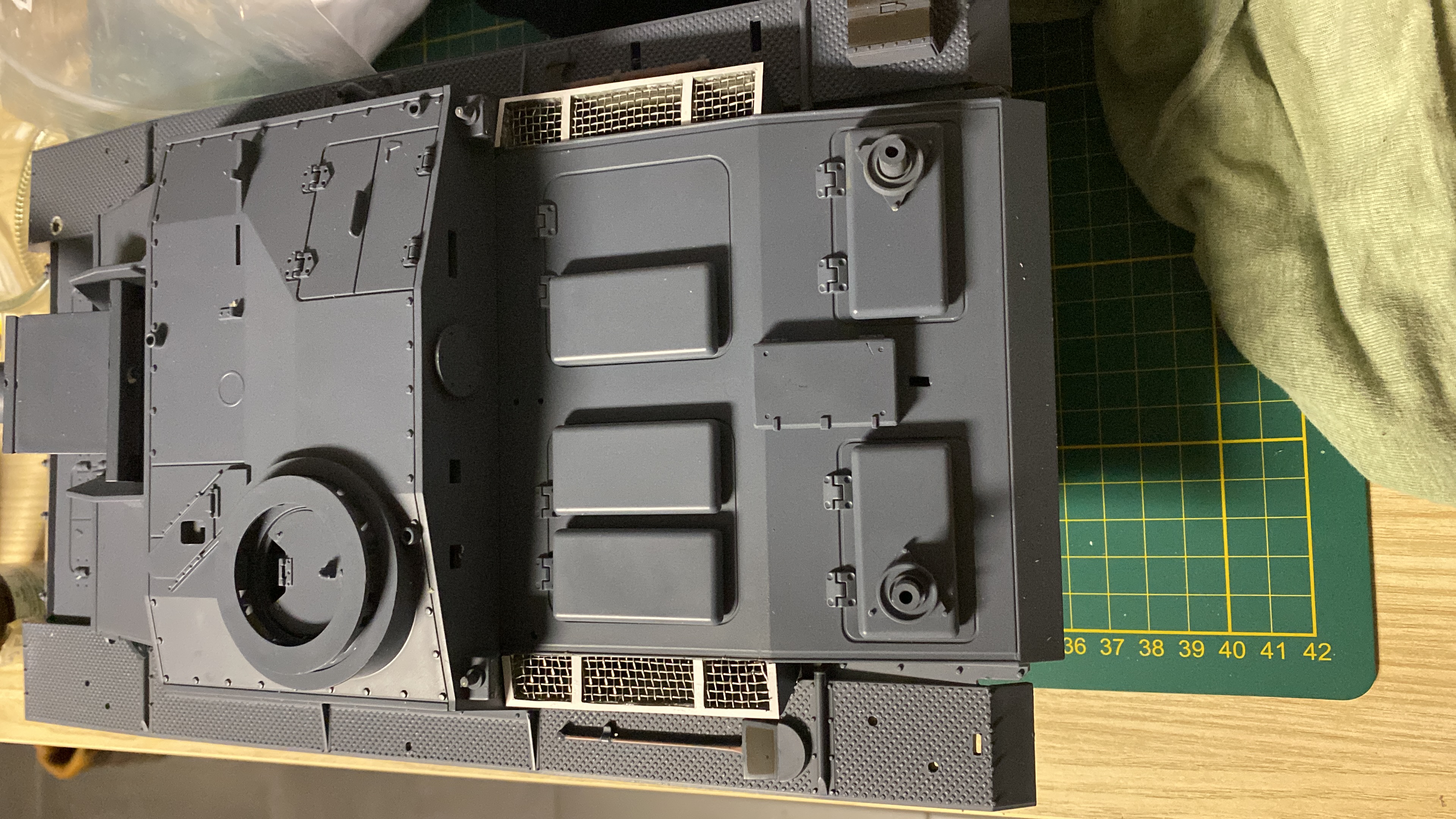

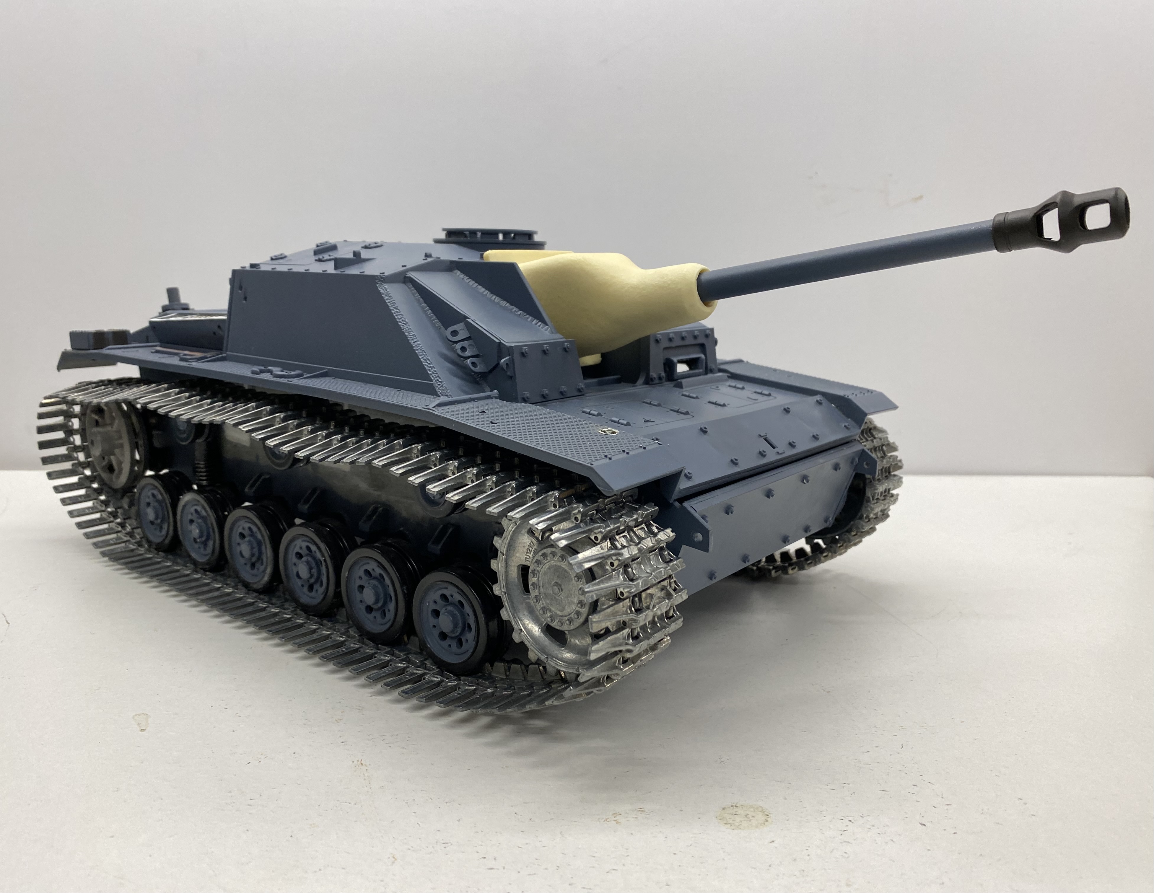

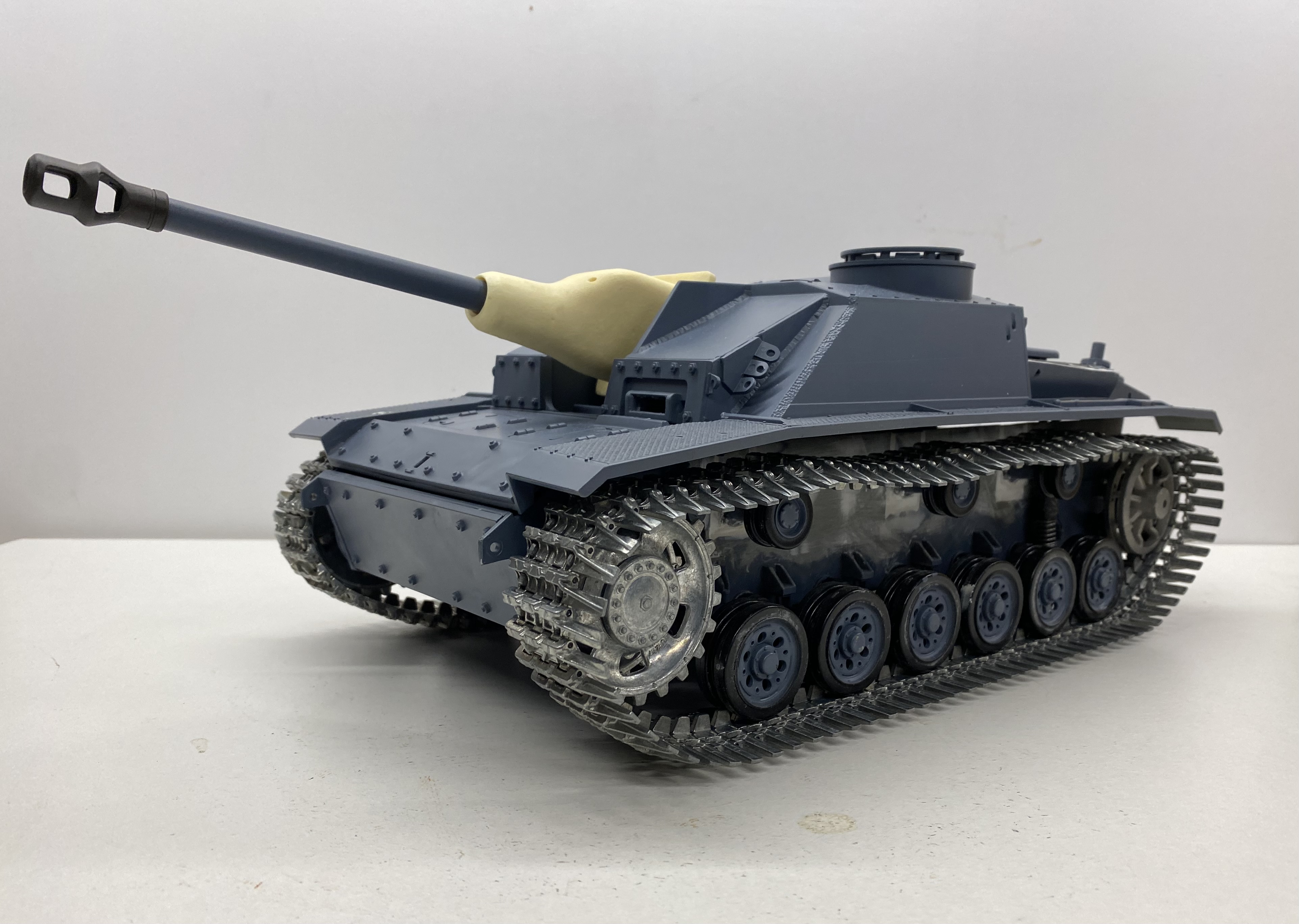

My StuG-A needs some cleaning and grinding before I can spray it in Panzergrau, and I discovered I need to order a new rattle can, so this assault gun is pushed aside for a short time.
In the meanwhile I bought a new HL StuG from Ali a while ago.
Costet me €128 shipping included.
The plan is to ad the Winterketten I had on the Early StuG before, onto this one.
This is what it should turn out in the end:

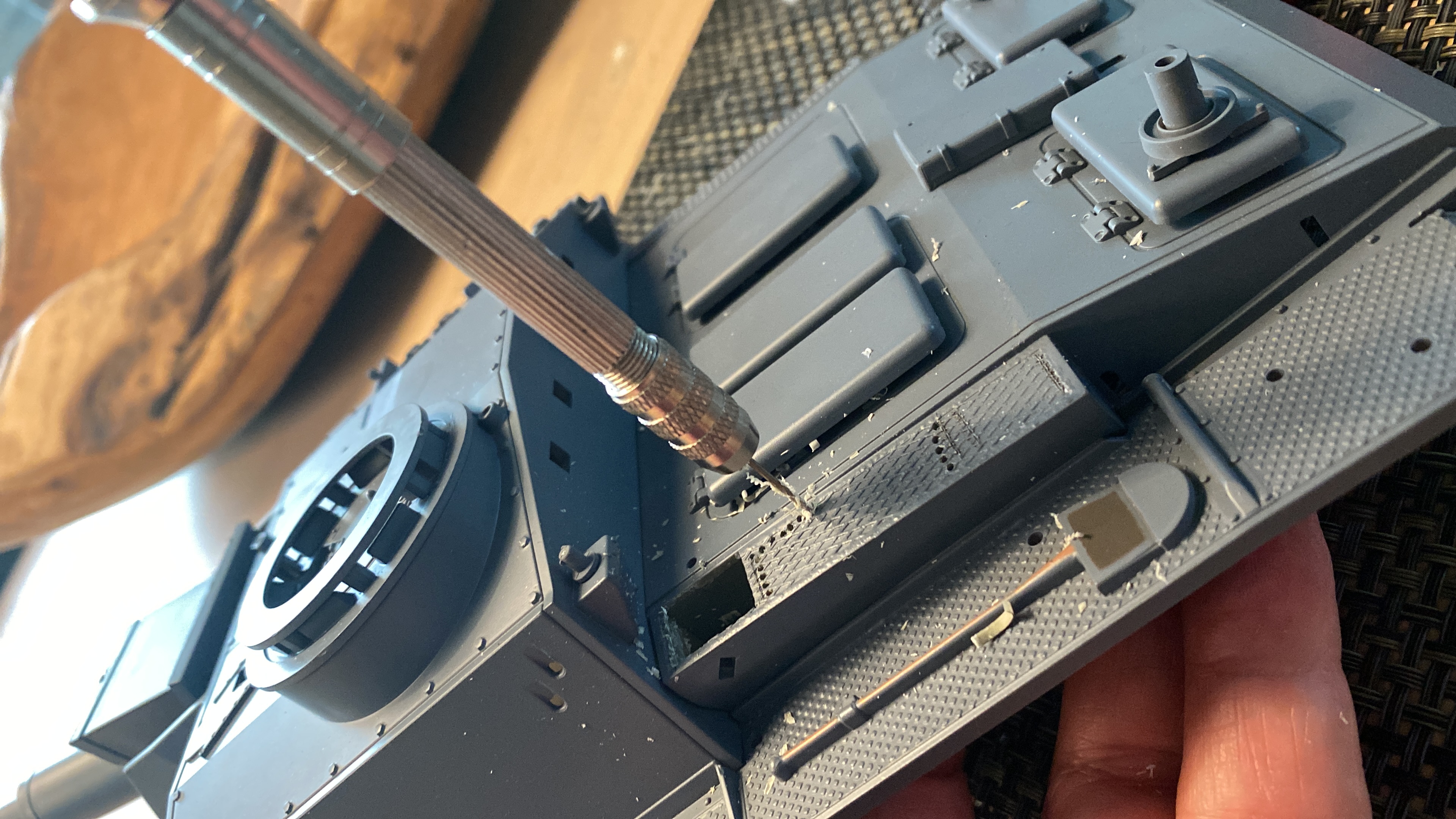

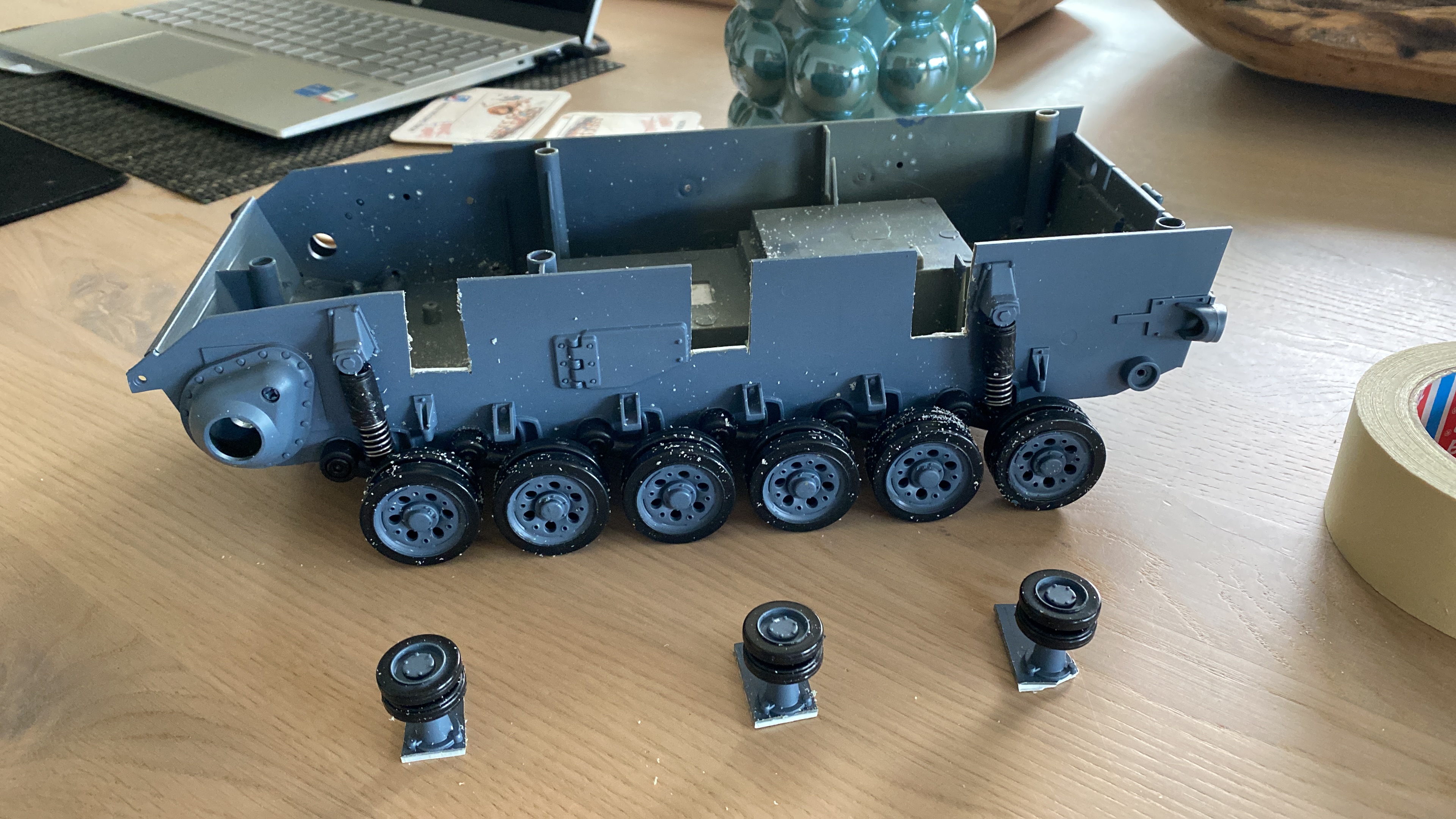

During the past weeks I emptied the lower hull, ordered metal sprocket and idler wheels, mounted the Saukopf Blende, cut out the plastic grills and replaced them with parts from a kitchen sieve (as always).

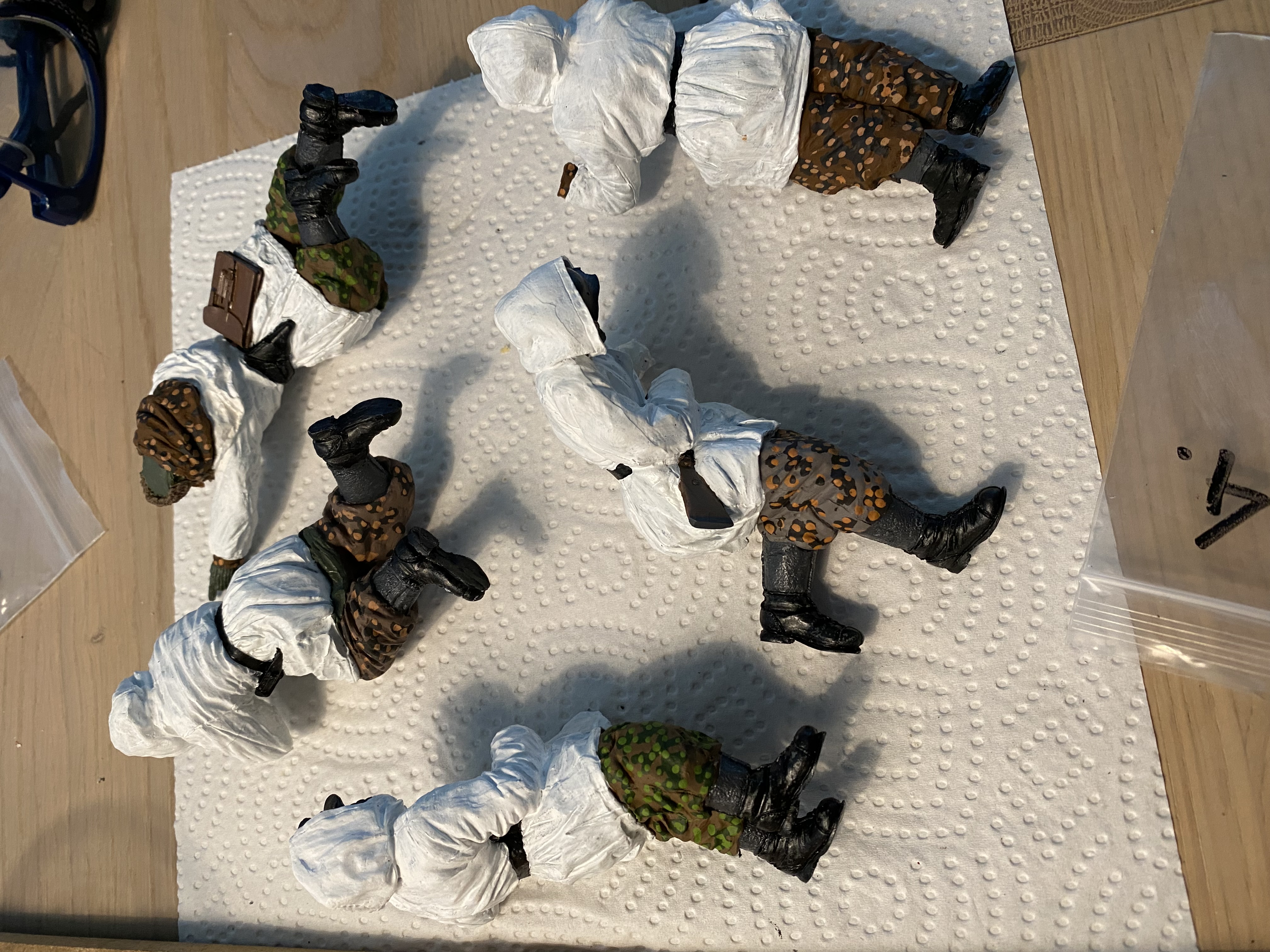

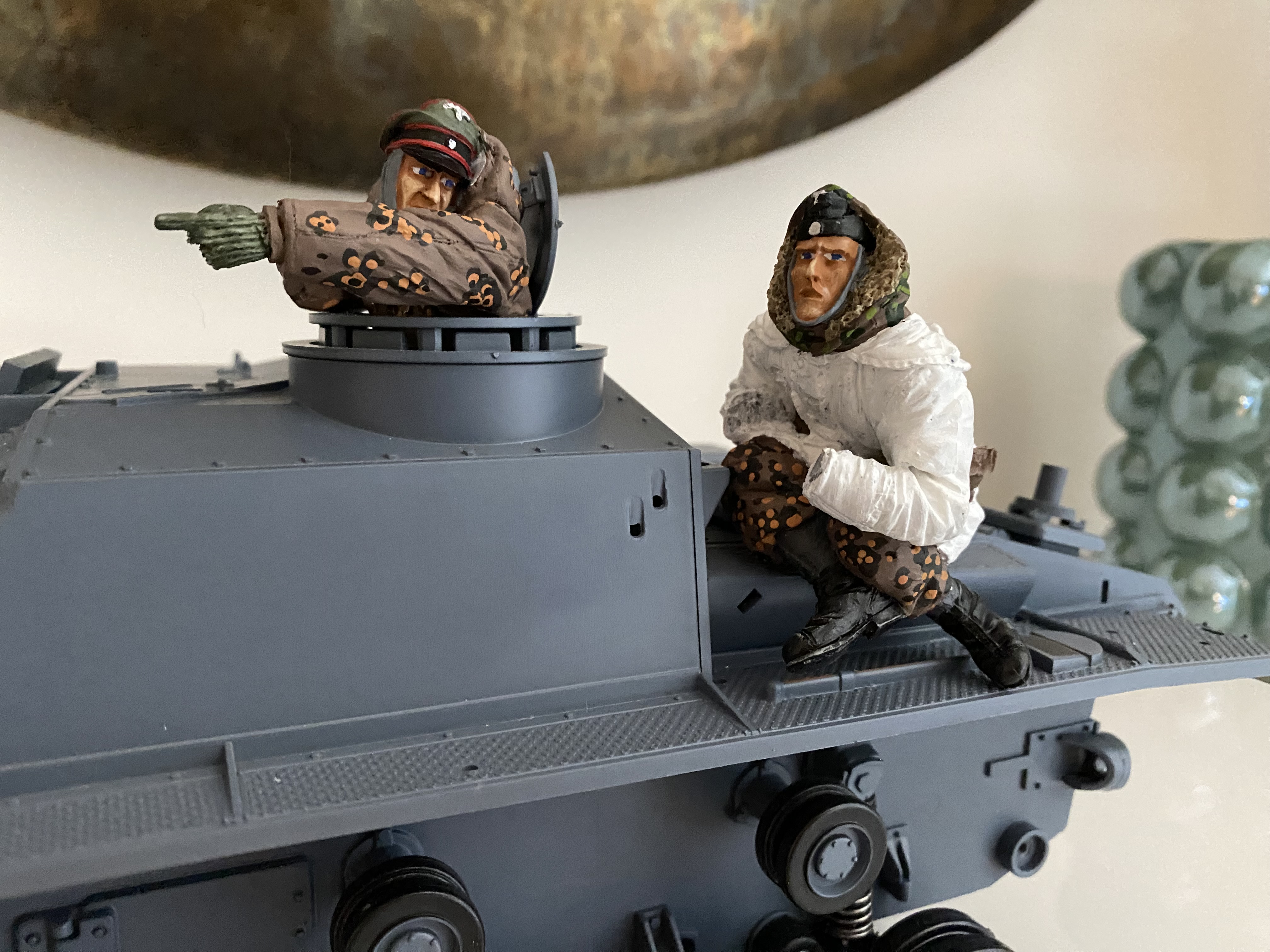

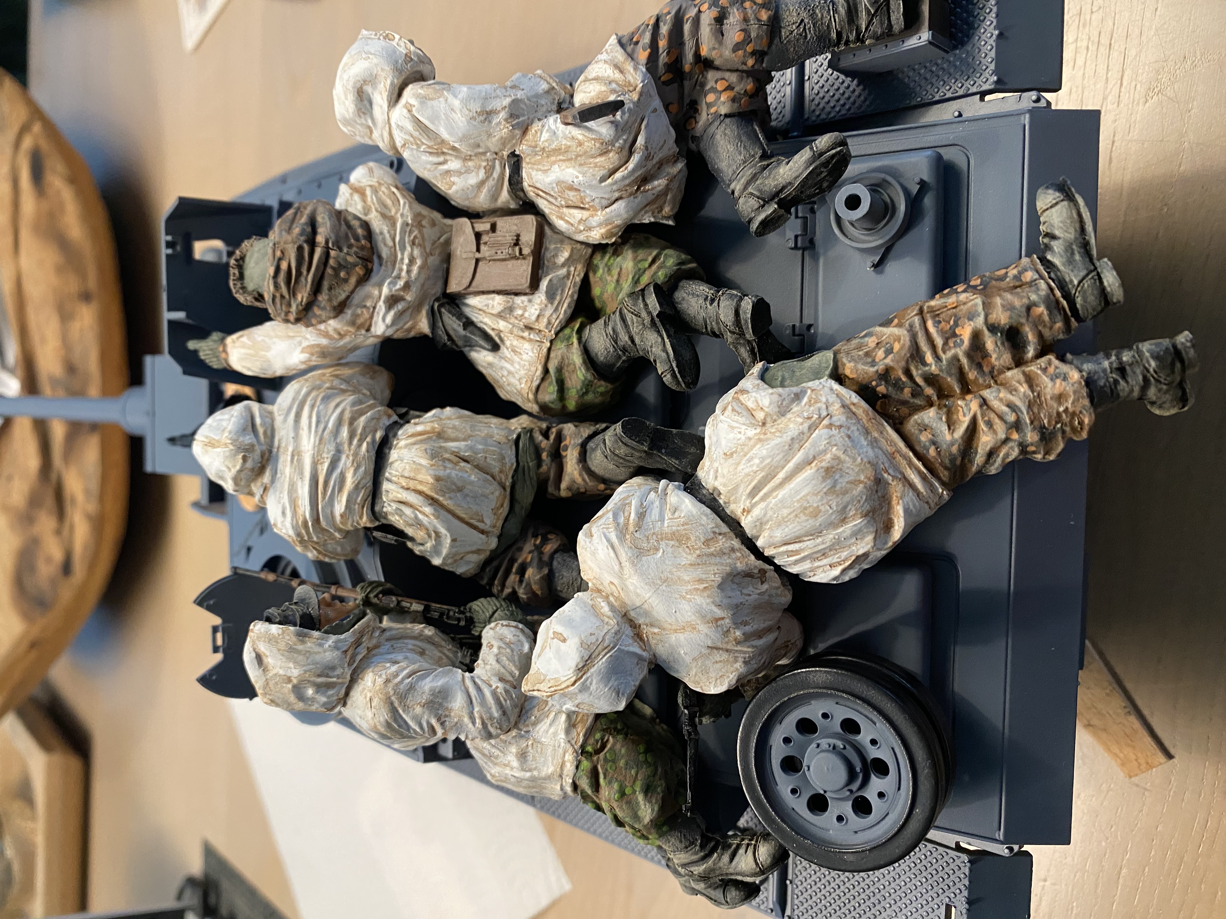

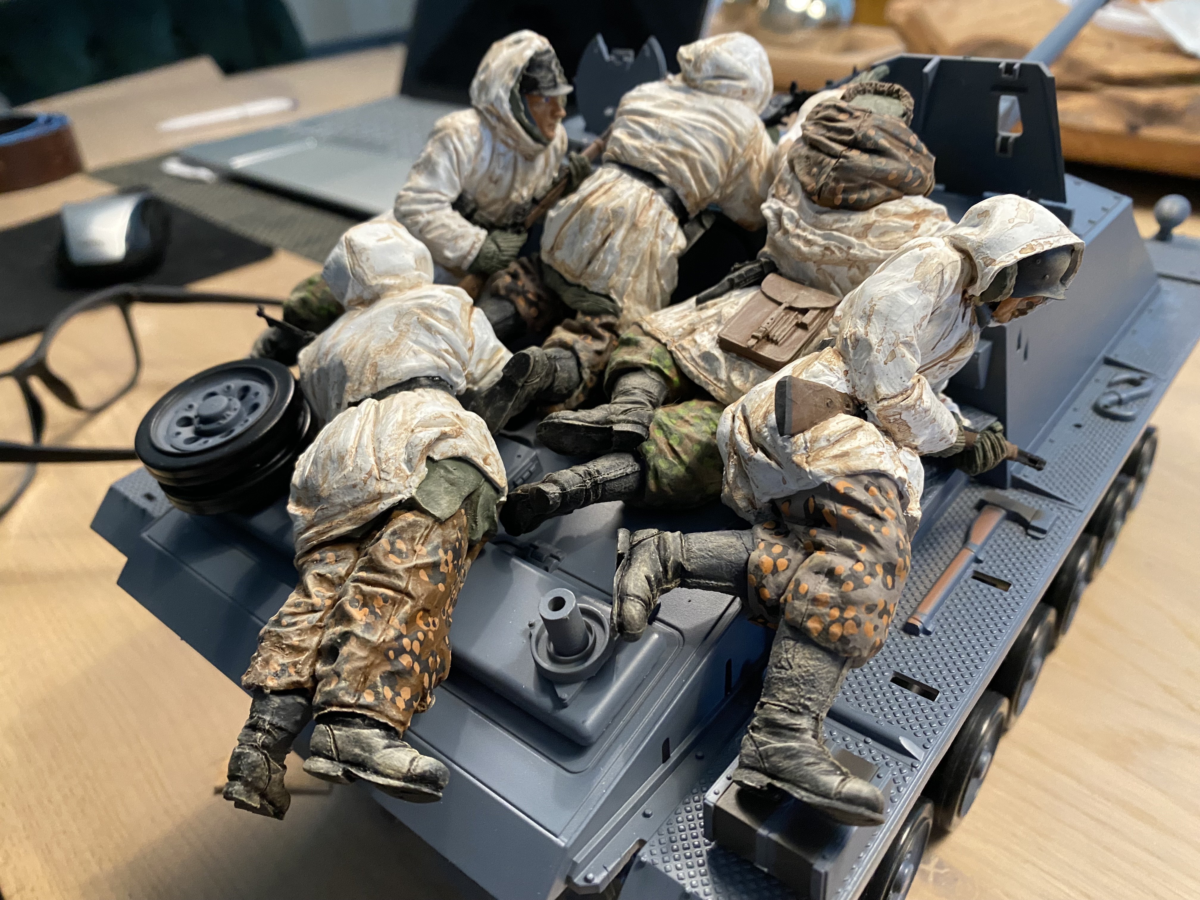

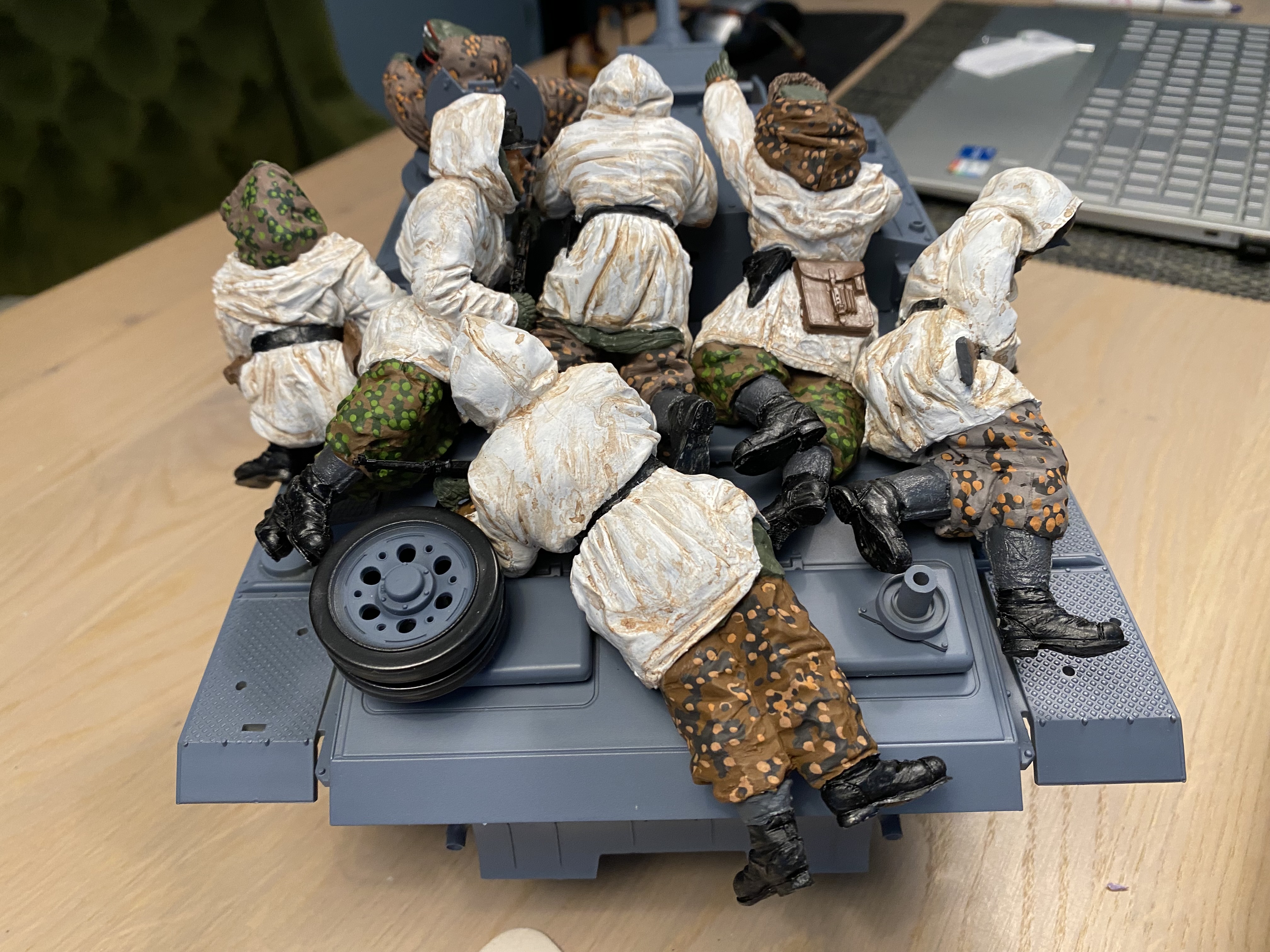

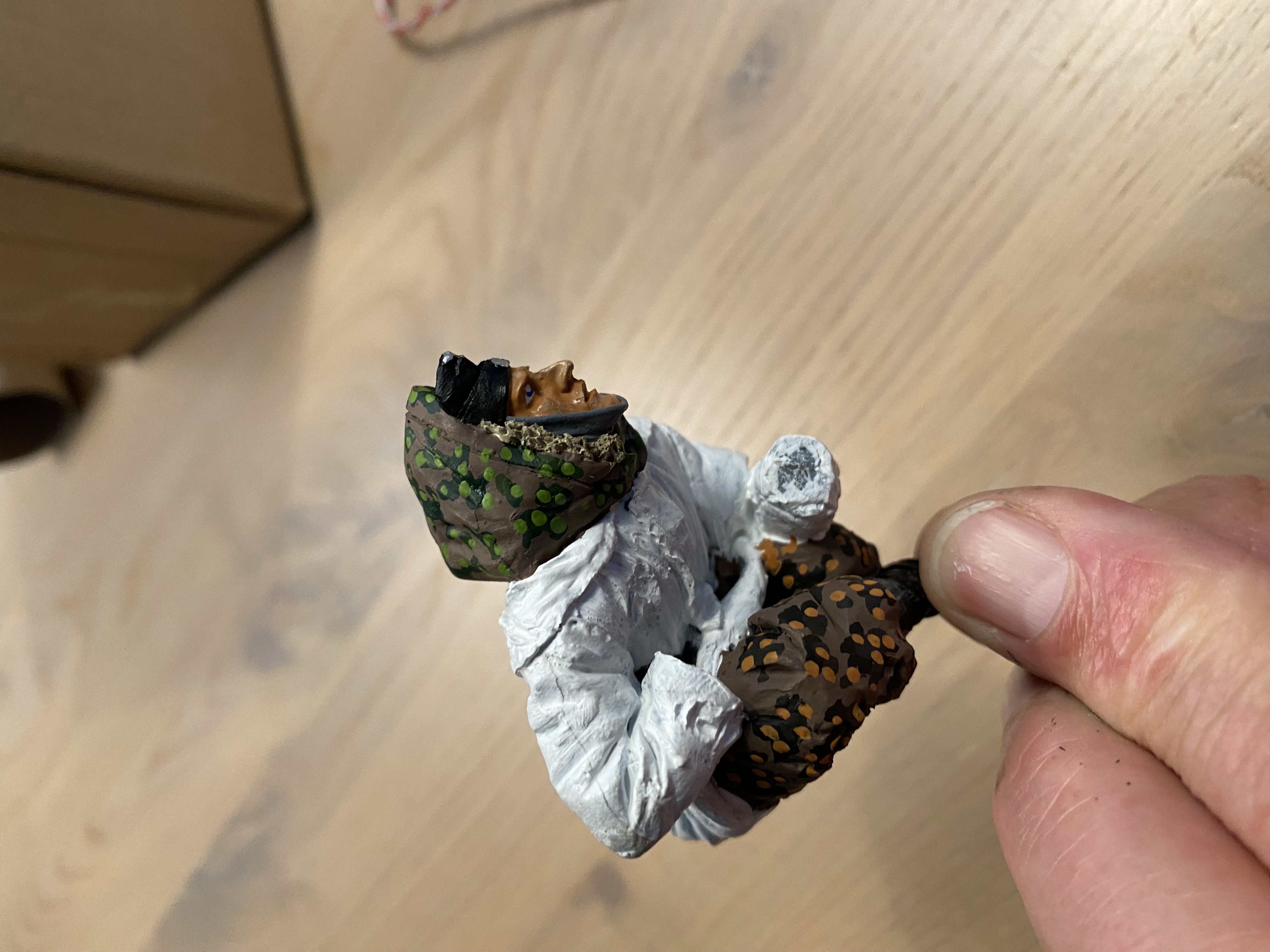

In the meanwhile the tankriders arrived too.
All guys are almost finished by now, received some clear varnish matt and got a bit altered.
Some minor things need to be done but that‘s for later.

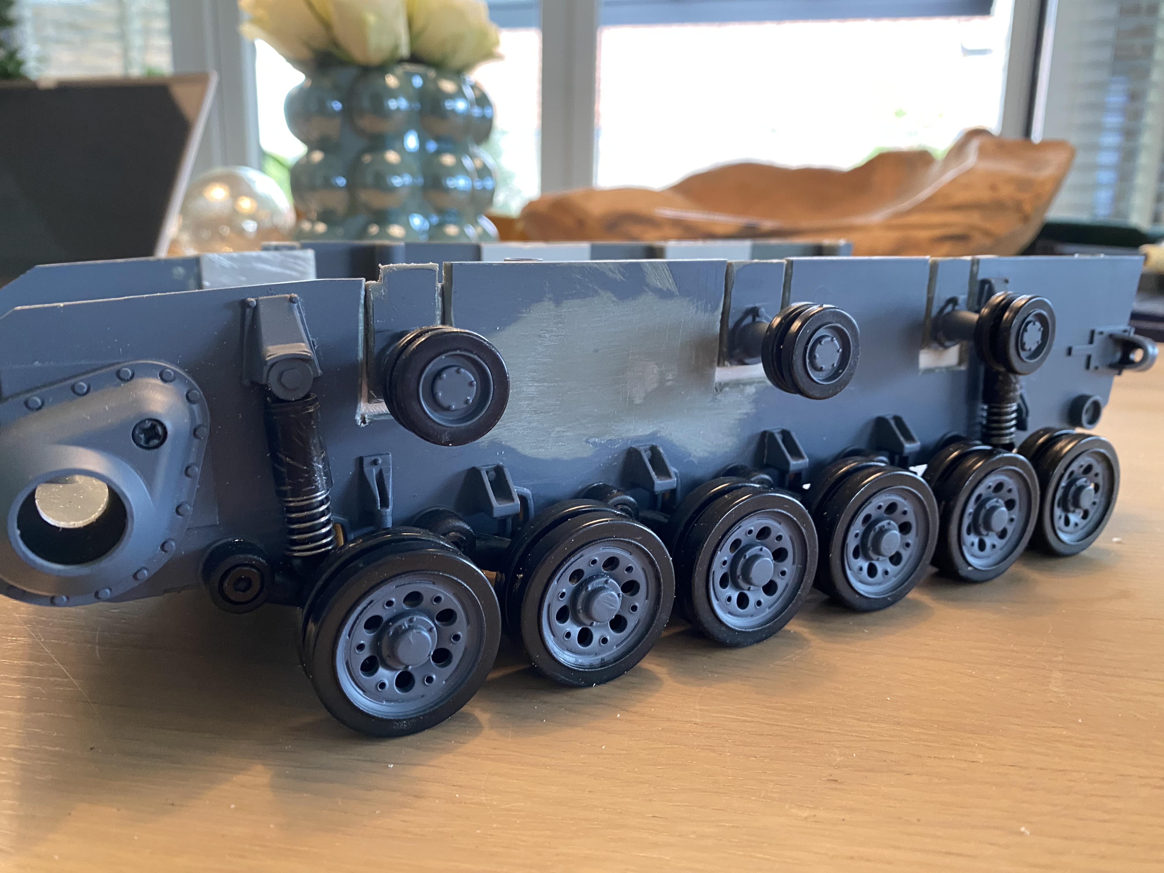

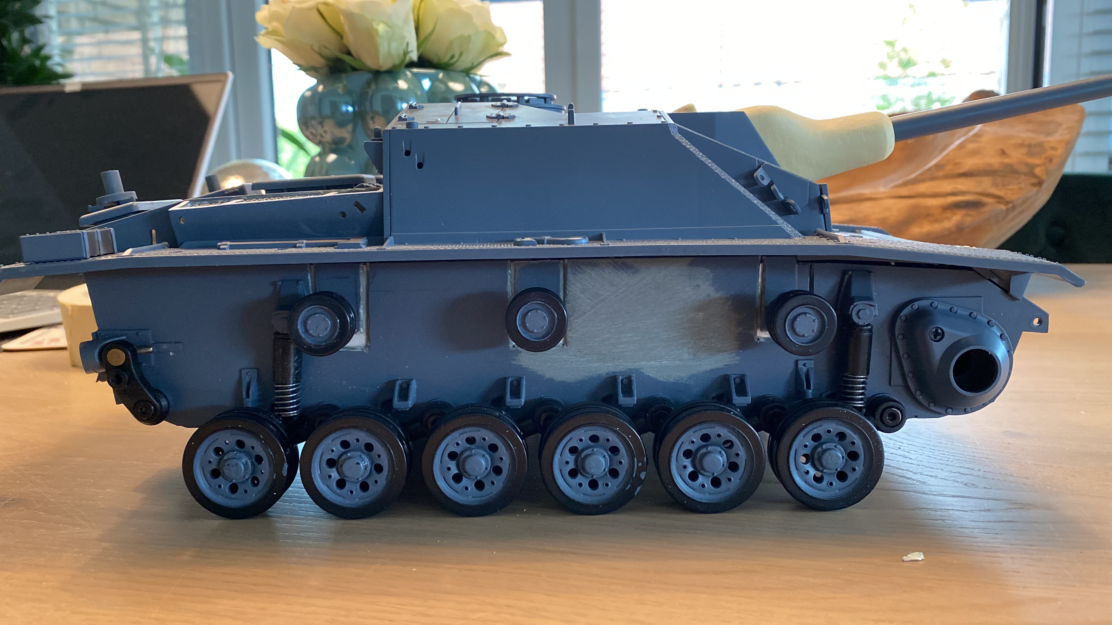

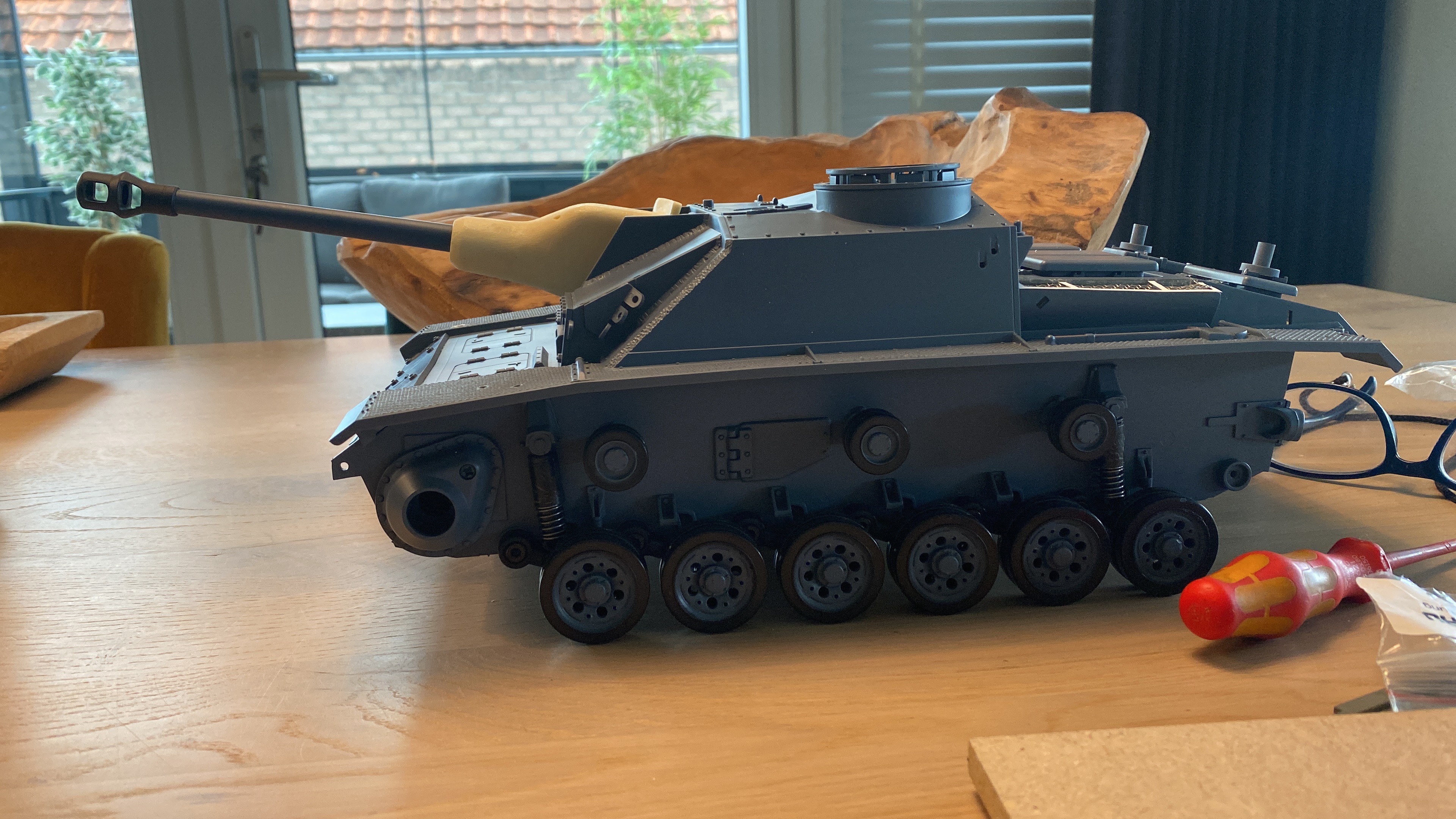

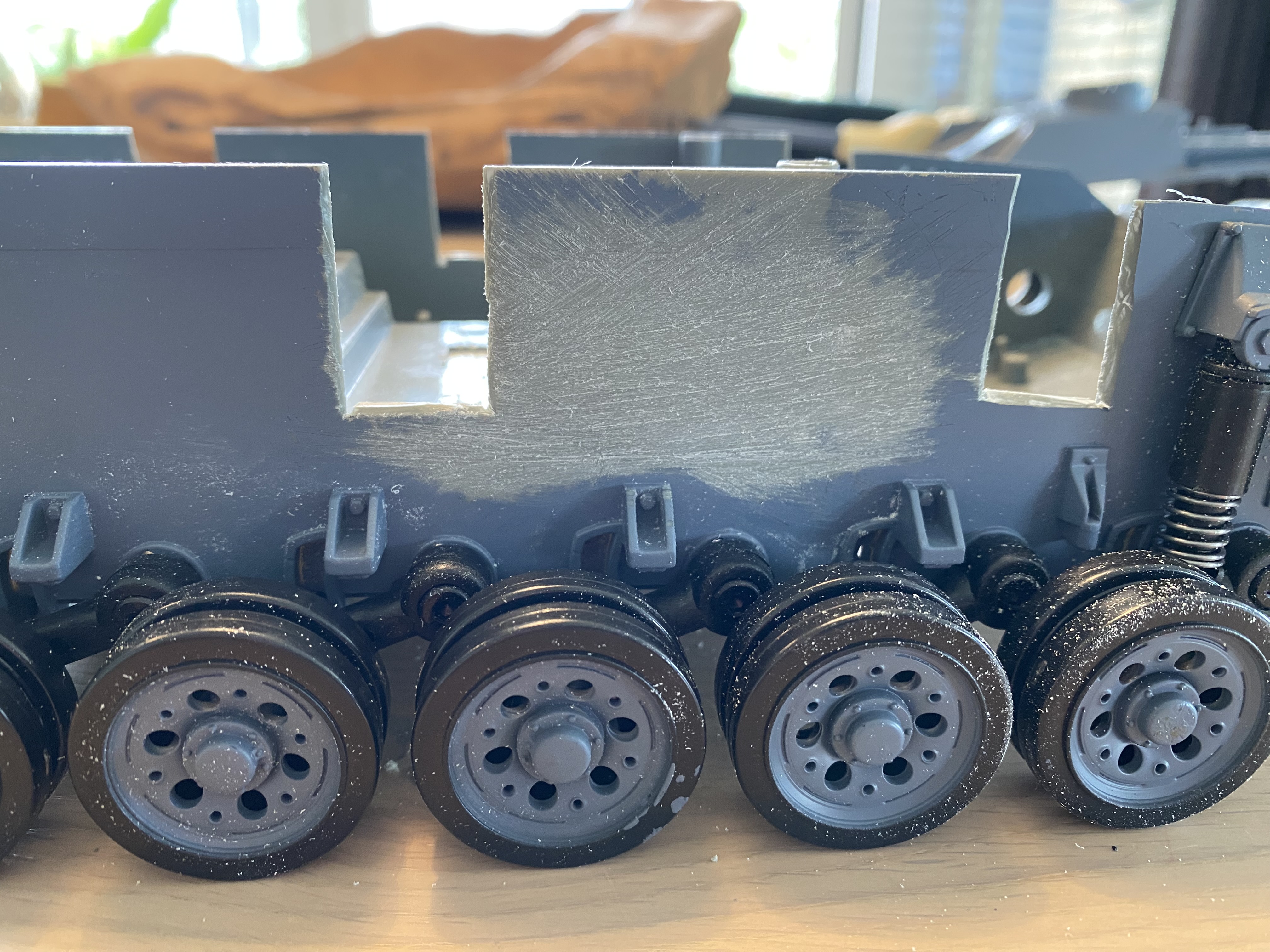

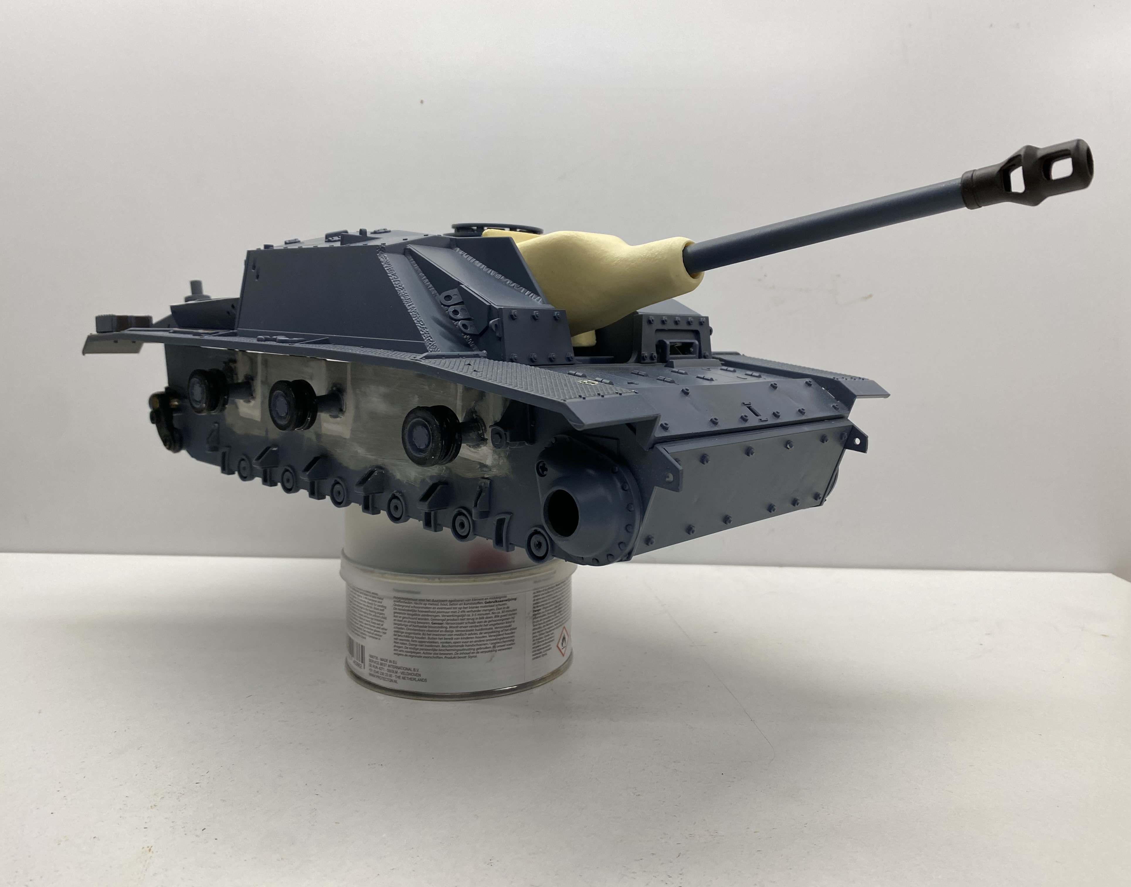

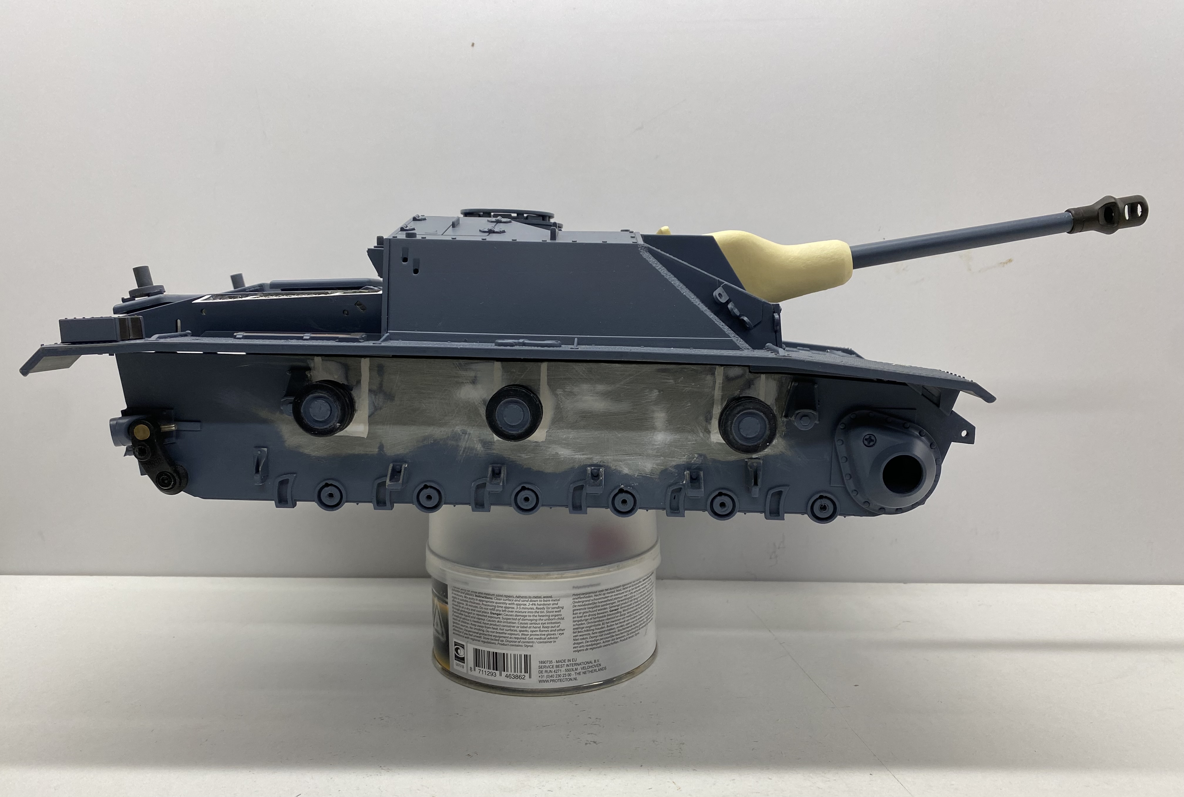

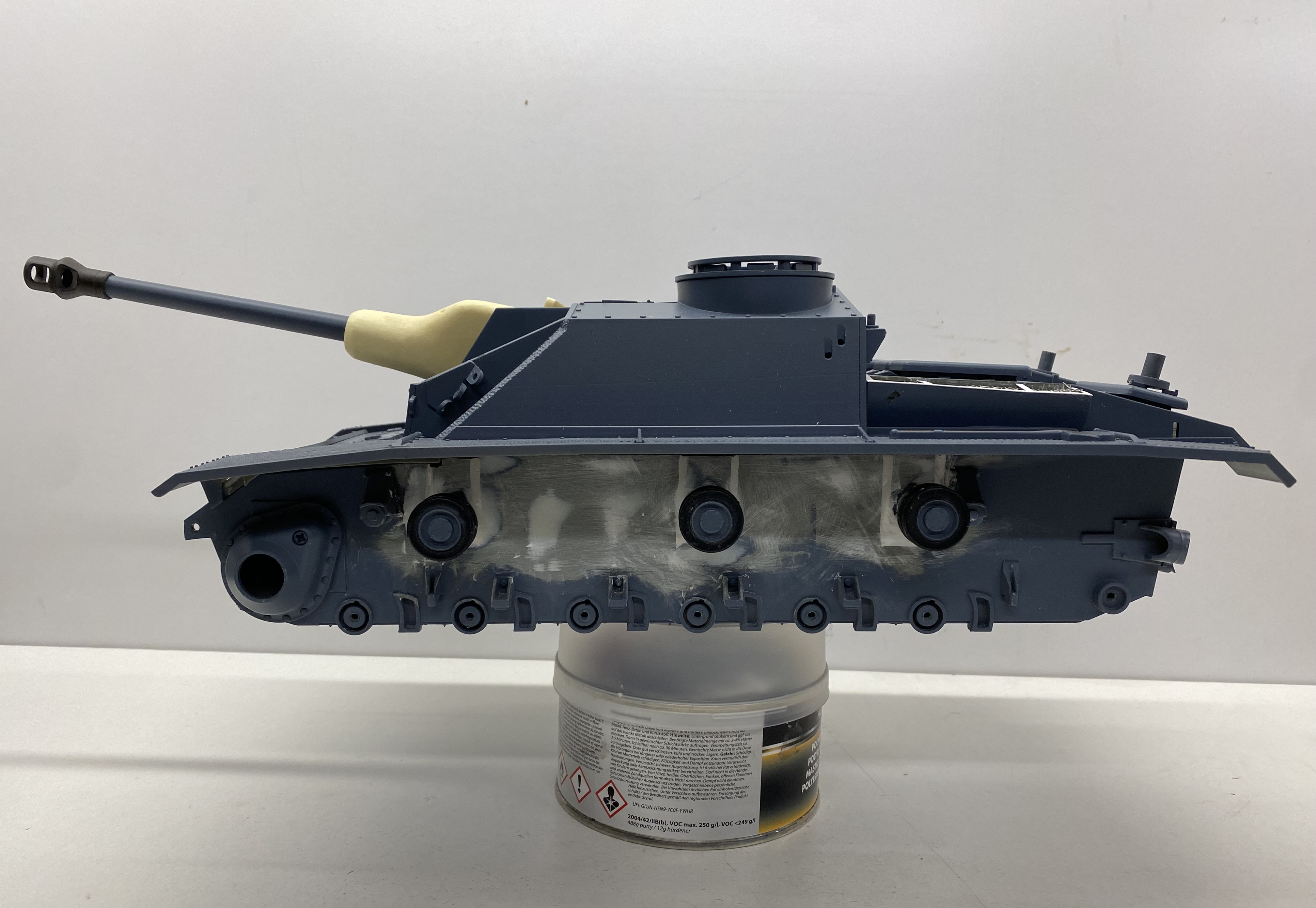

Finally I decided to work on the returnrollers.
Been busy all day repositioning them and I also removed the escape hatches too:
Next step, filling the gaps underneath the rollers with poly strips.
Than I can start with putty to make it all smooth.

This morning it looked this, after adding putty, grinding, putty, grinding and that for quite a few times in a row…

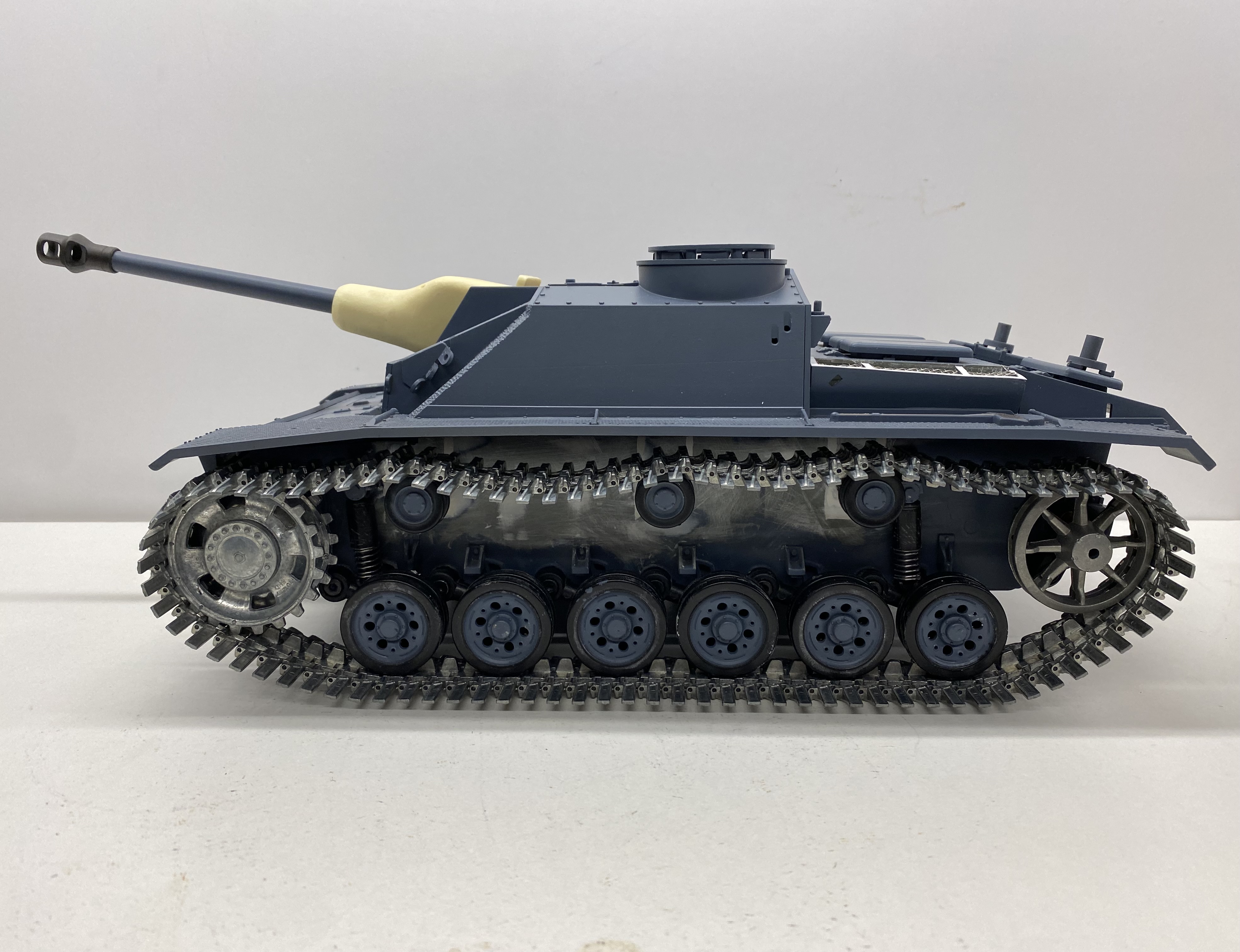

Rob59
Posts: 1216
Location: Netherlands
Re: New project.

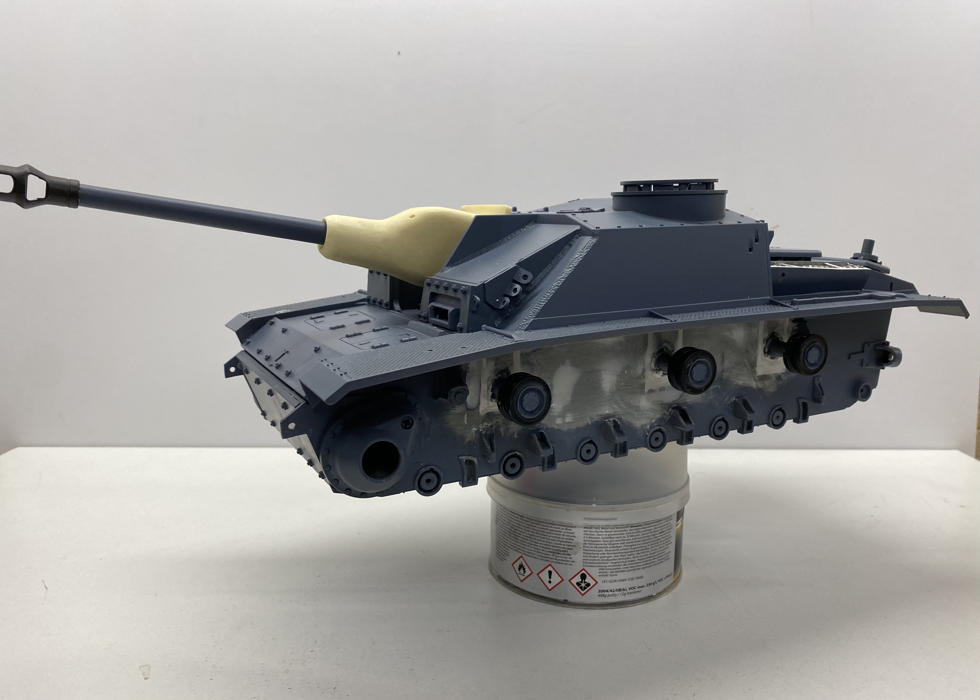

Post by Rob59 »
And right now, almost 2.5 hours later, it looks like this:
