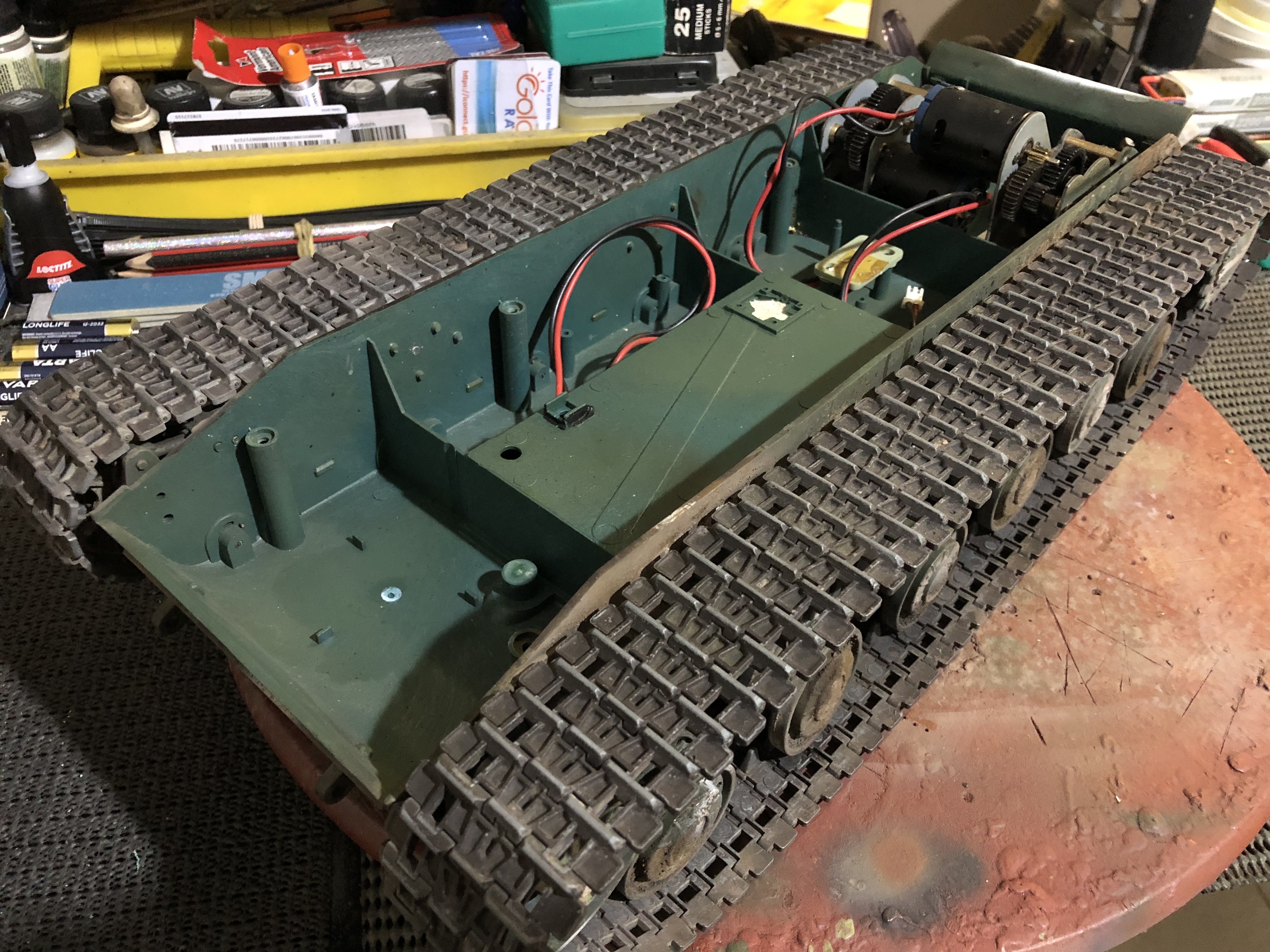

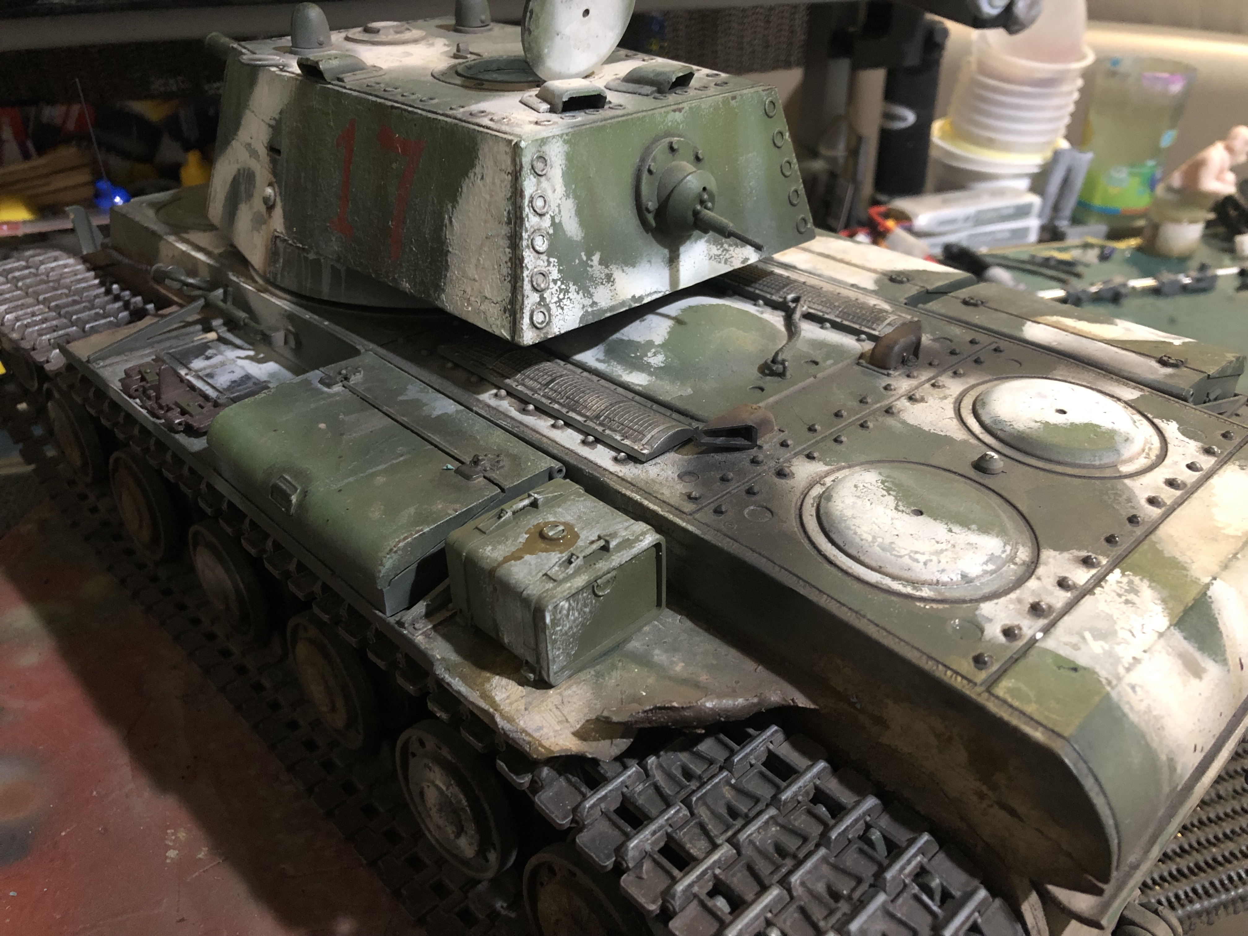

Against my better judgement, its opened up, cleaned out & now to the fix ups.
Noticed 2 roadwheels that were refusing to rotate freely & when one was removed it decided to snap the axle off the swingarm :-<
Drilled & tapped the arm out to receive a surplus suspension screw from I believe a Leo(spares box from G.K.W. ) and drove the thing into place.
Rotation restored on both, with a snifter of WD40 spray to help the matter.
I'll get jiggy wid-it over the weekend (after preparing Nacho mix for 265 hungry Dance comp spectators :wtf: ) in the morning & see how it shapes up.

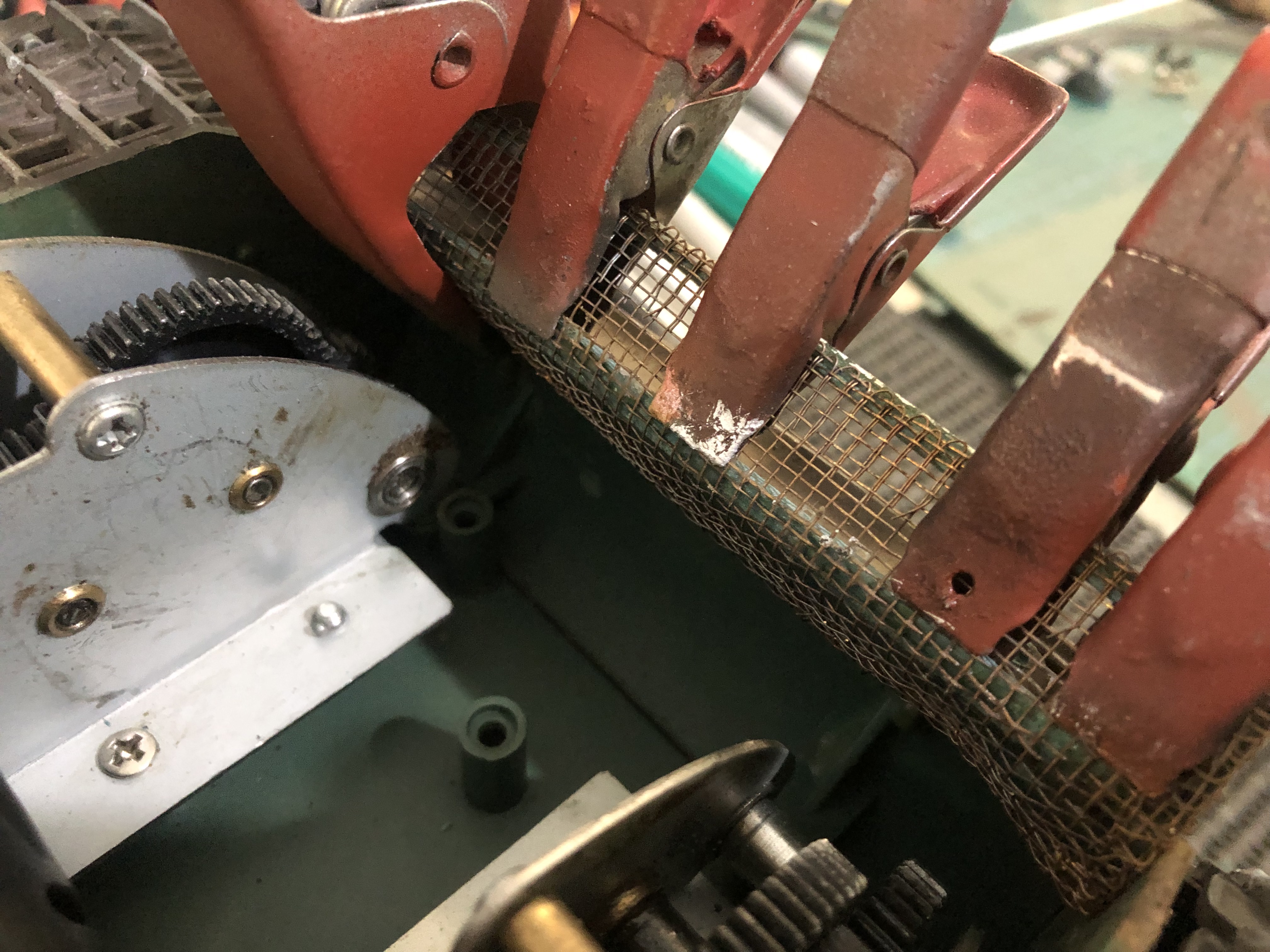

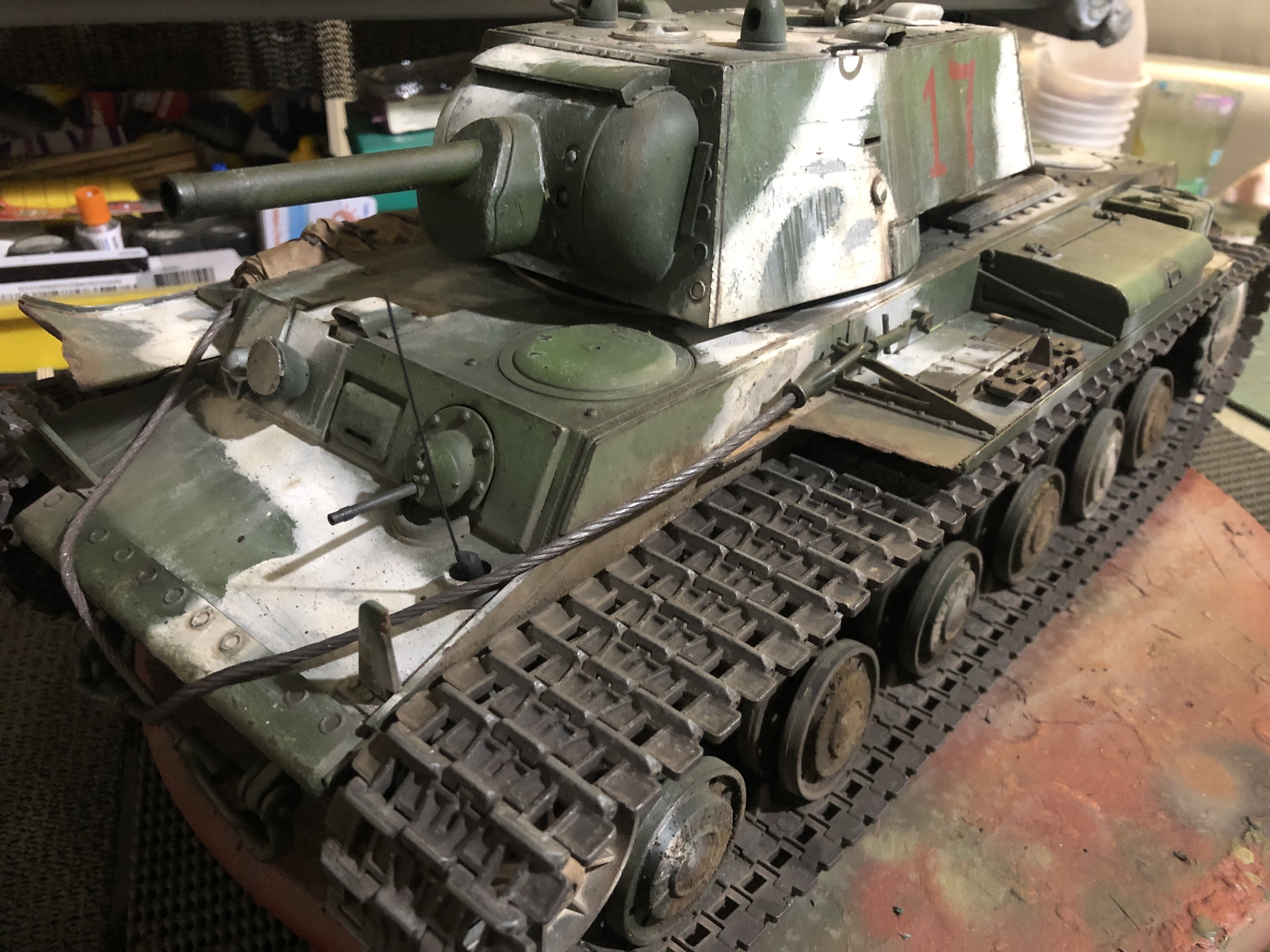

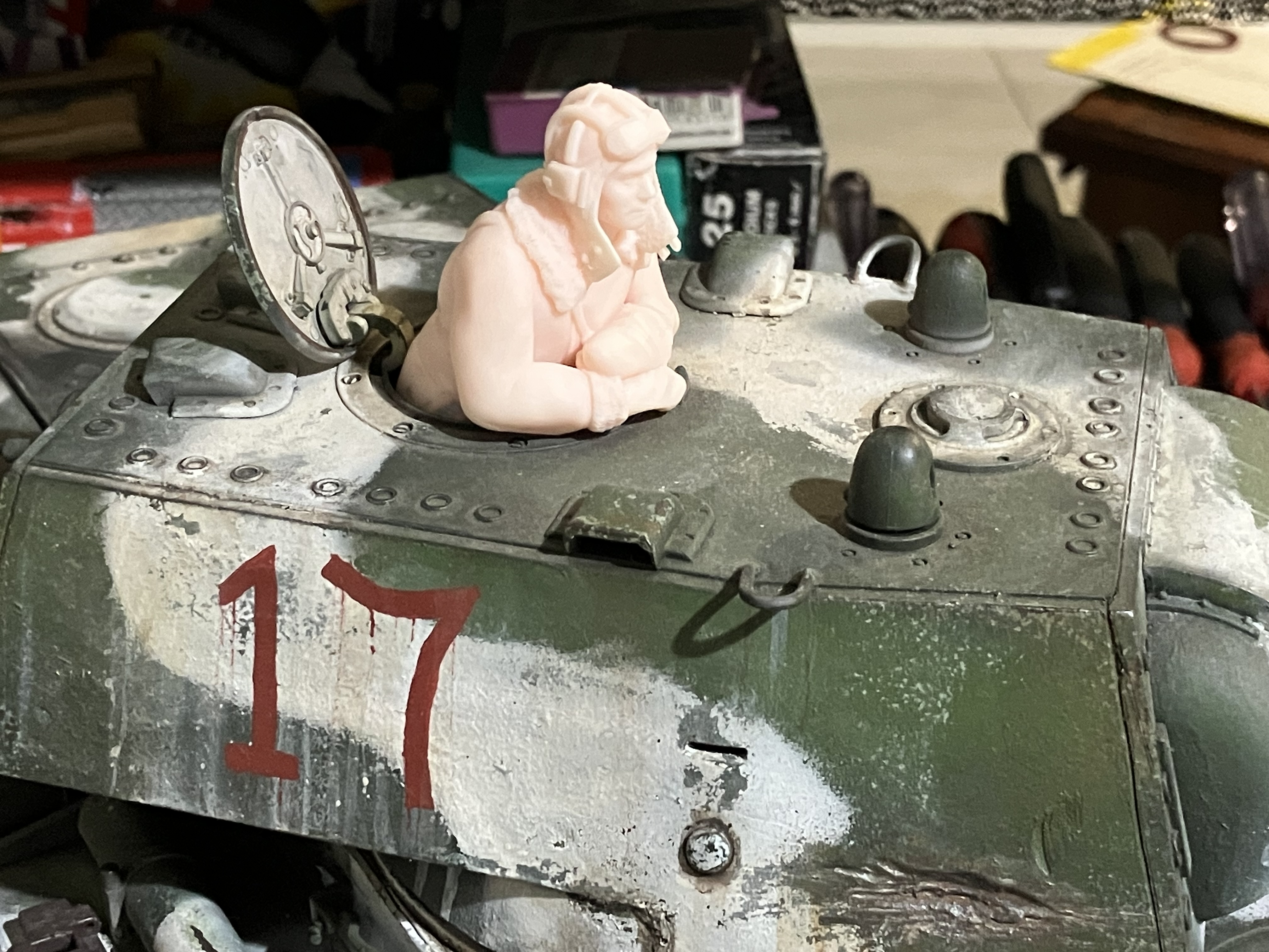

I stripped a V7 out of a T34 that is pending a conversion some day & installed it into the KV-1 .
What a great idea !
Tidied up the wiring, hooked up the MG, carved off the BB system ready for a recoil mod some day., added the mash panel into the rear hull valance and fitted my second to last oil tank .
For the time being its a vast improvement and will do for this kid.
Once the commander figure is in, the poor ole thing will have a new lease of life !

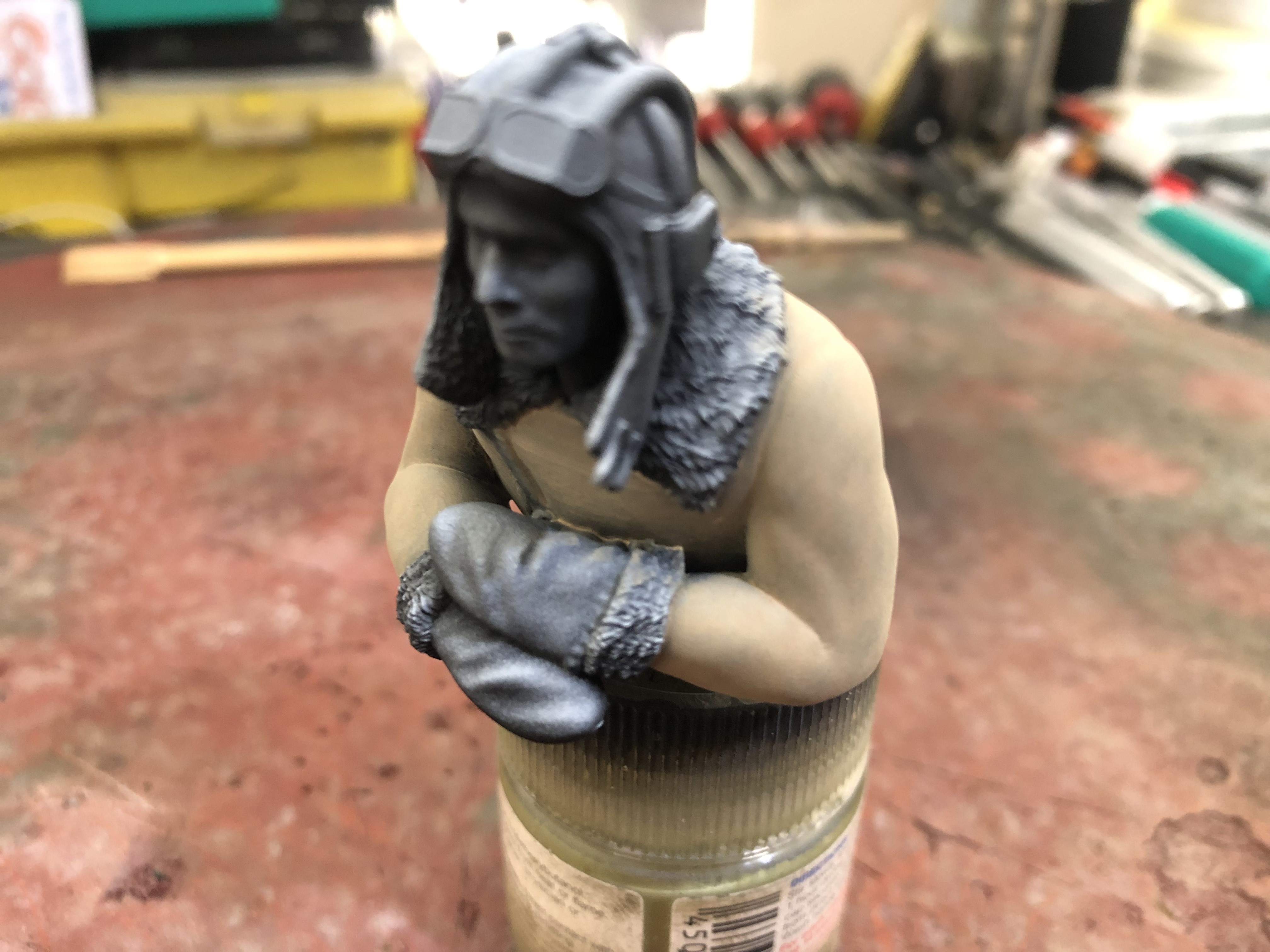

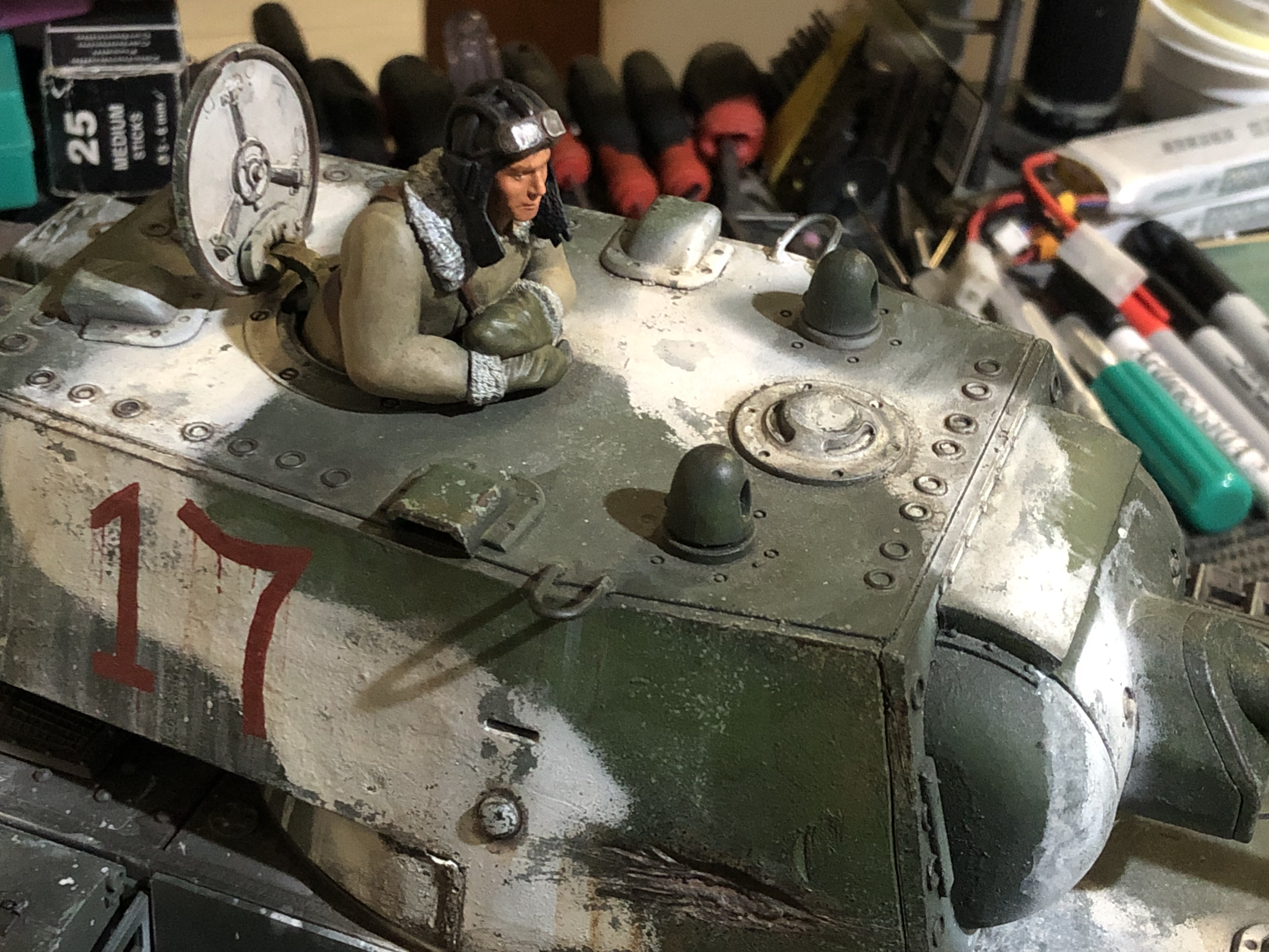

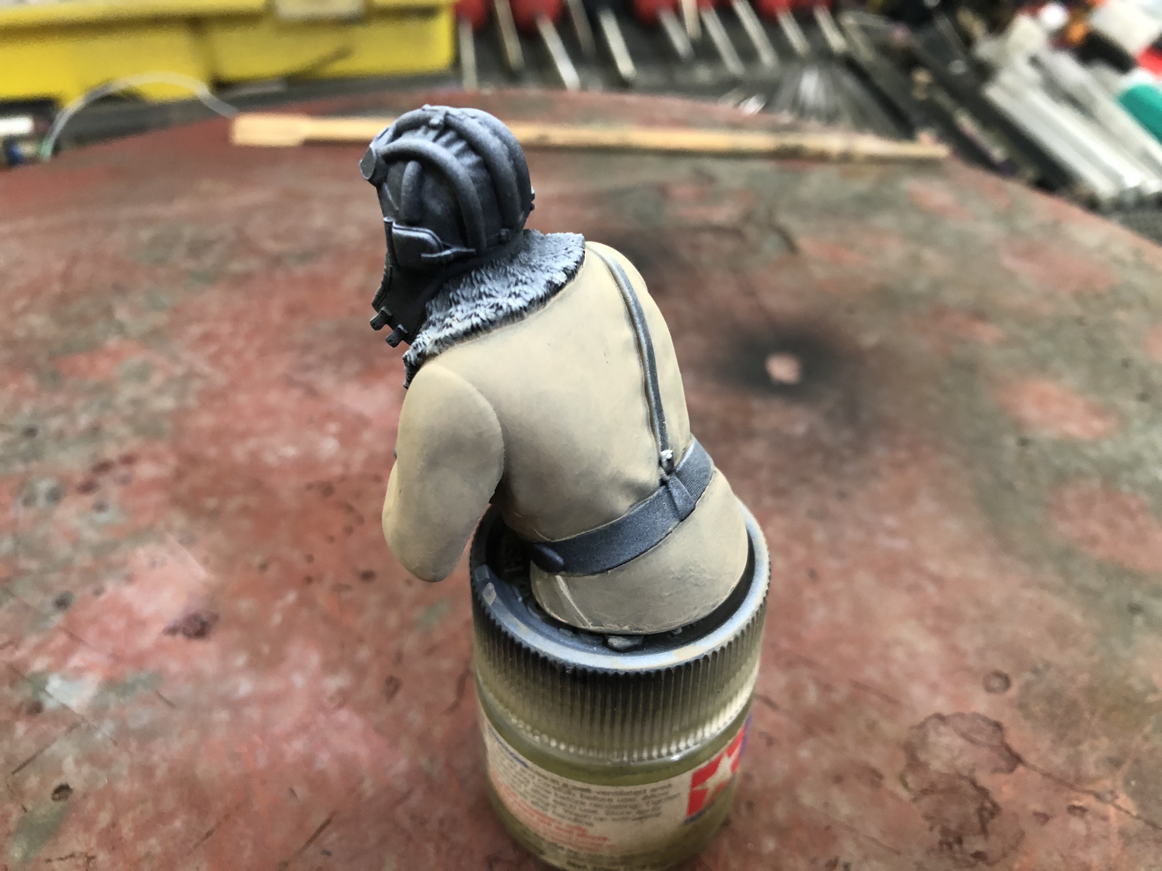

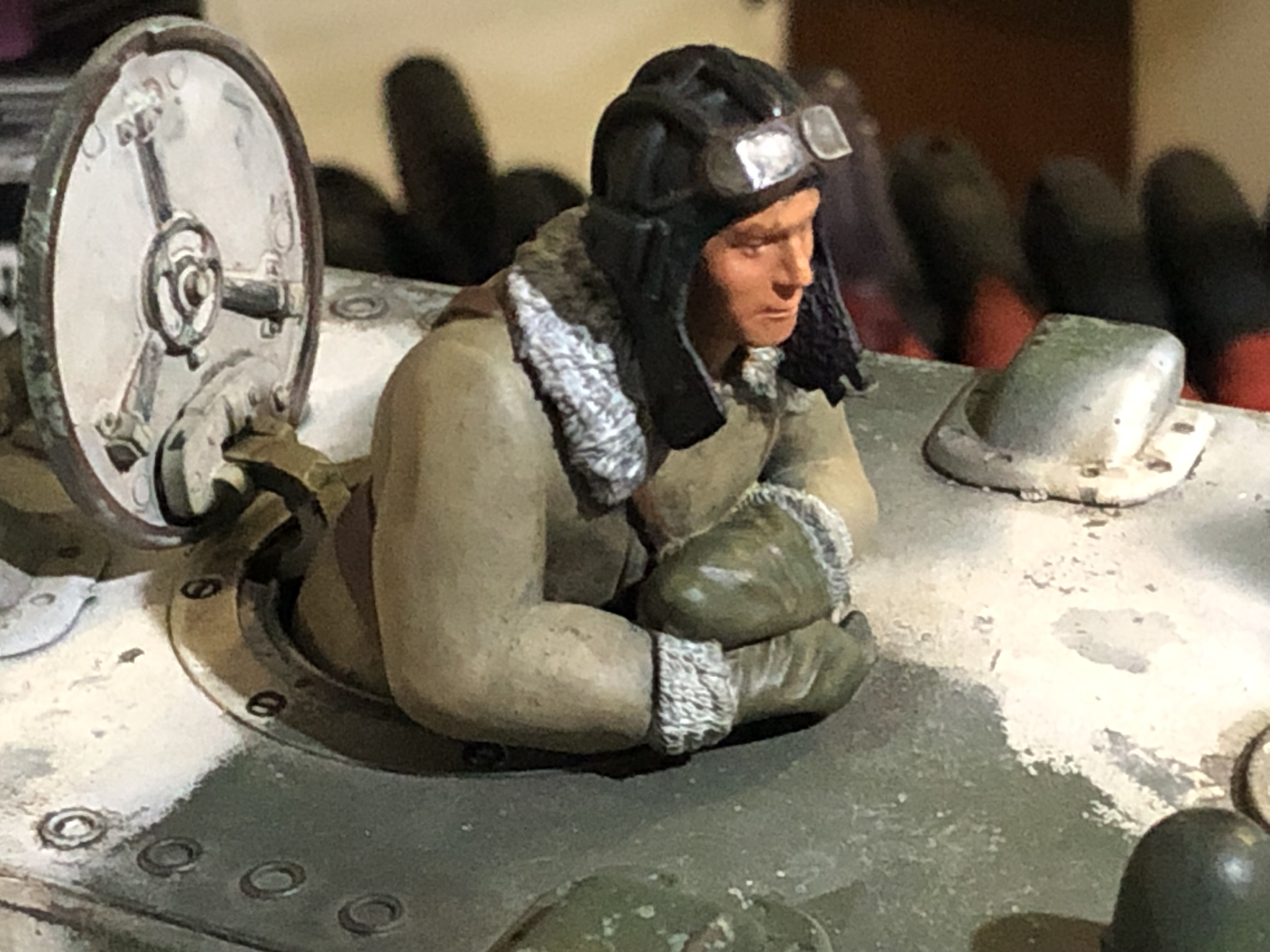

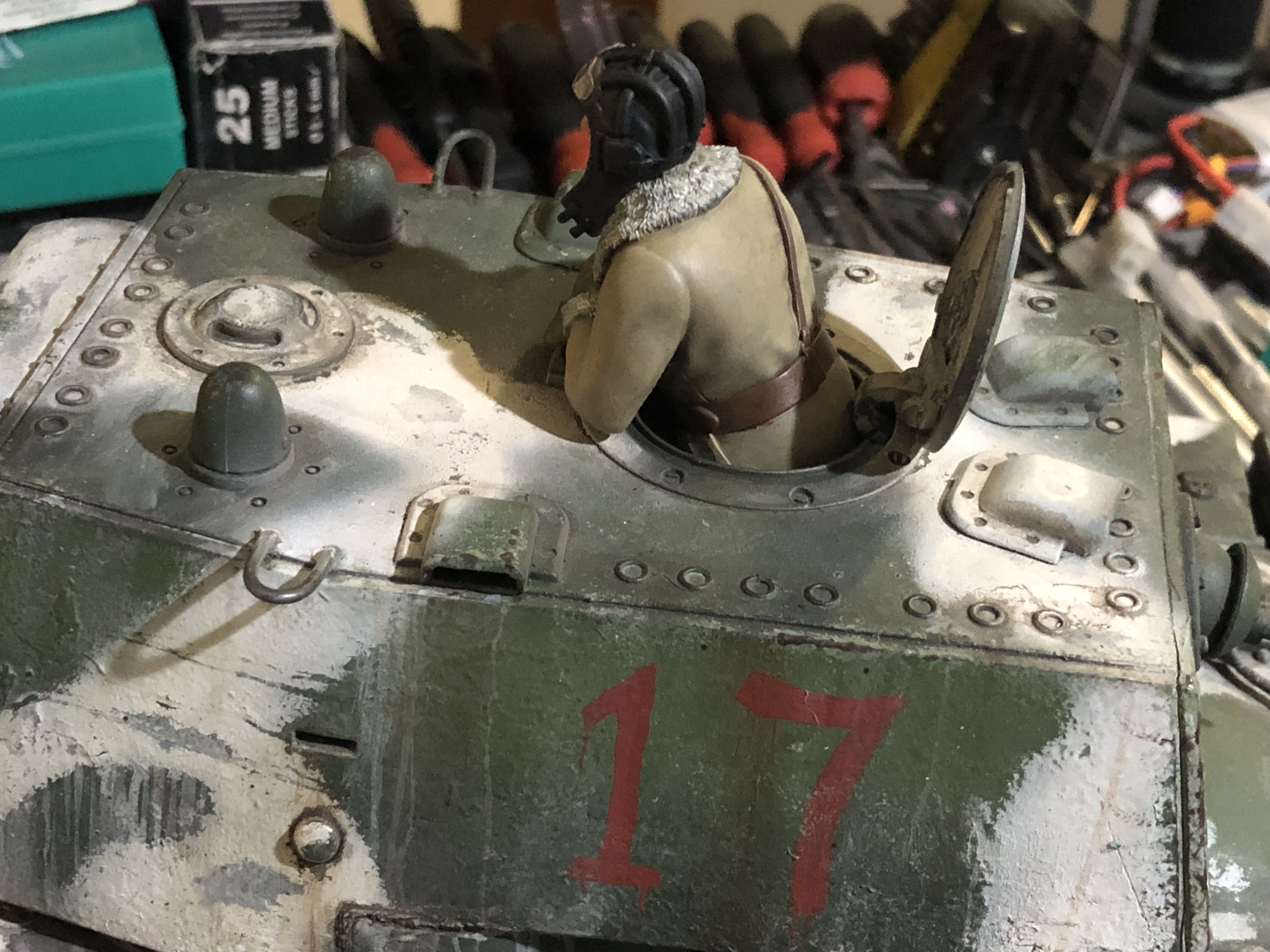

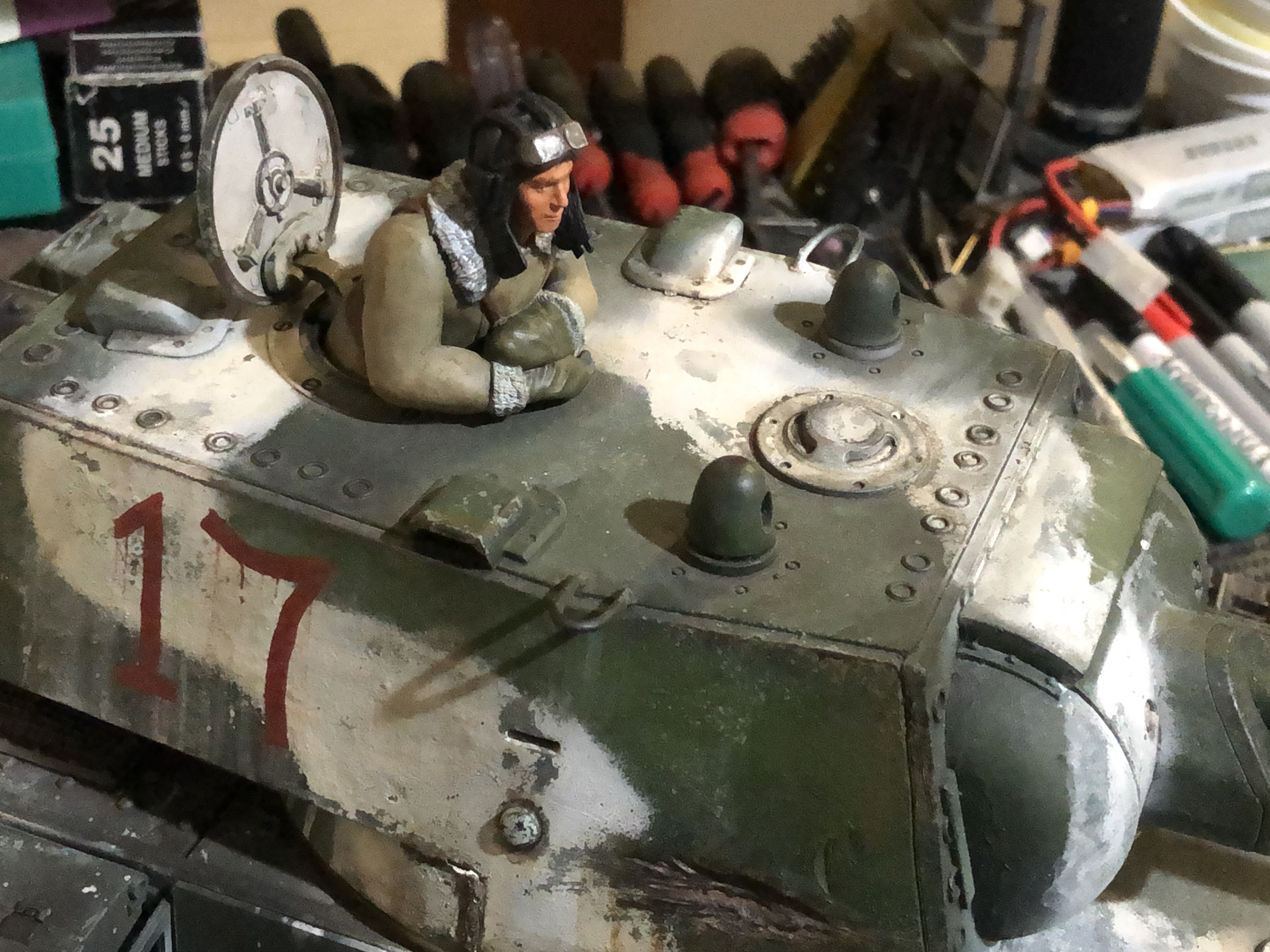

Got the T.C under way.
Base of all flat black, a dusting of white from above, and several washes of water thinned XF-78 Wooden Deck Tan .
I have used Desert Yellow XF-59 but its a bit too bright. The tanning effect on sheepskin is closer using the Deck Tan I reckon.
Used the glazing method I learned form me ole Uncle Nightshift.
Hes a good fit for this thing, seems to reflect the mood............
On the shelf it goes, repaired & ready to run...............one day :think:
