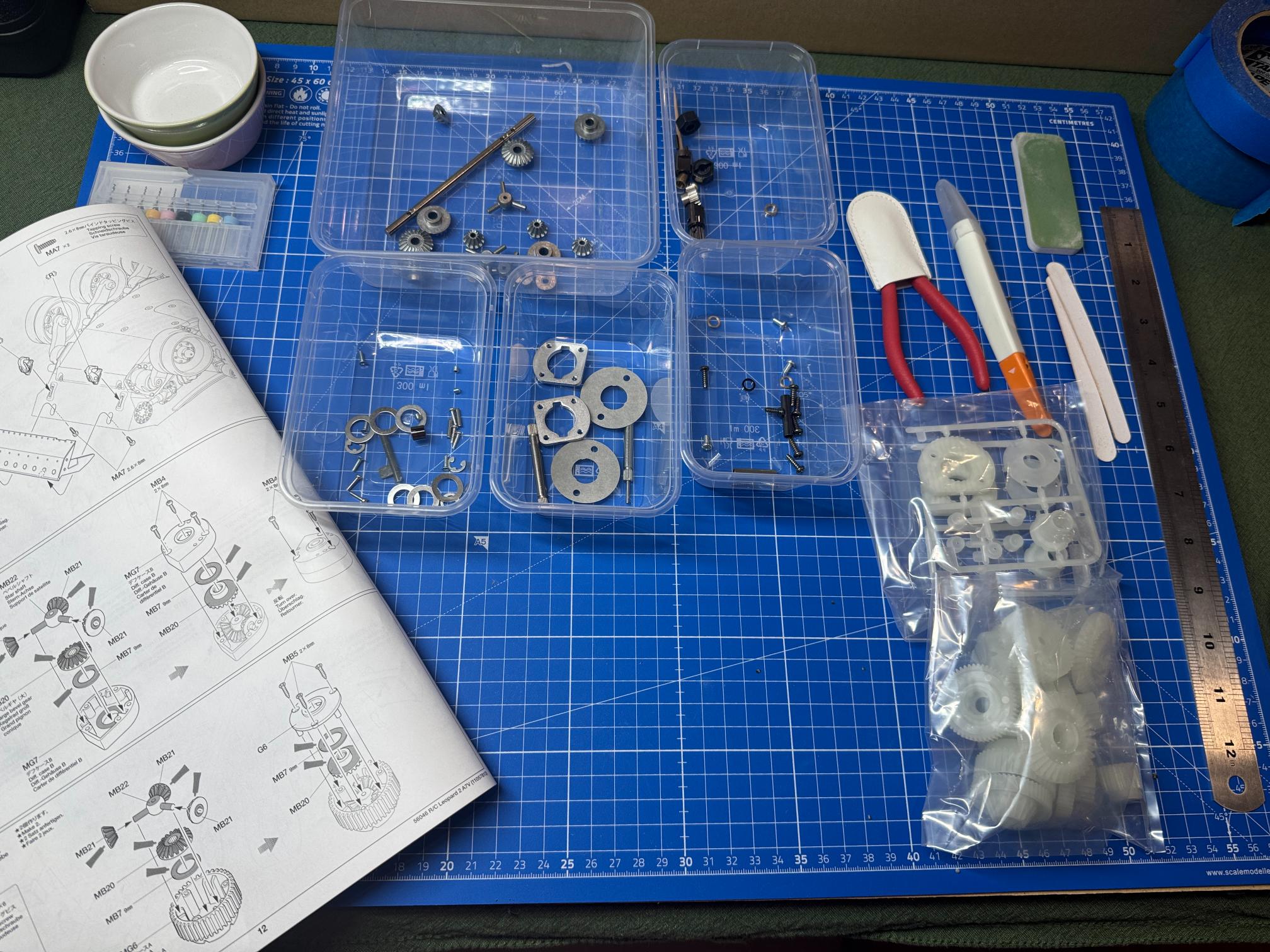

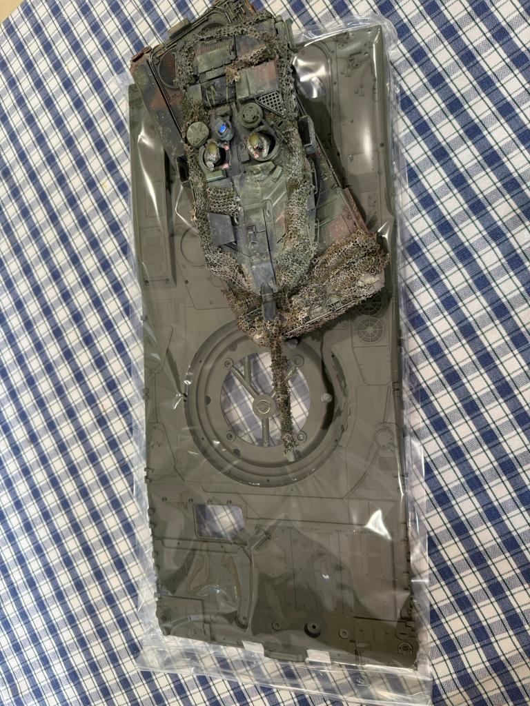

Lessons transferred from the 1/35 bench
As I just mentioned, I recently completed Tamiya’s 1/35 Leopard 2 A7V (IMHO so far the best 1/35 kit of the A7V), and the assembly sequence of the 1/16 counterpart follows it almost bolt-for-bolt—merely enlarged. That fresh experience give a clear build plan and should maintain momentum.

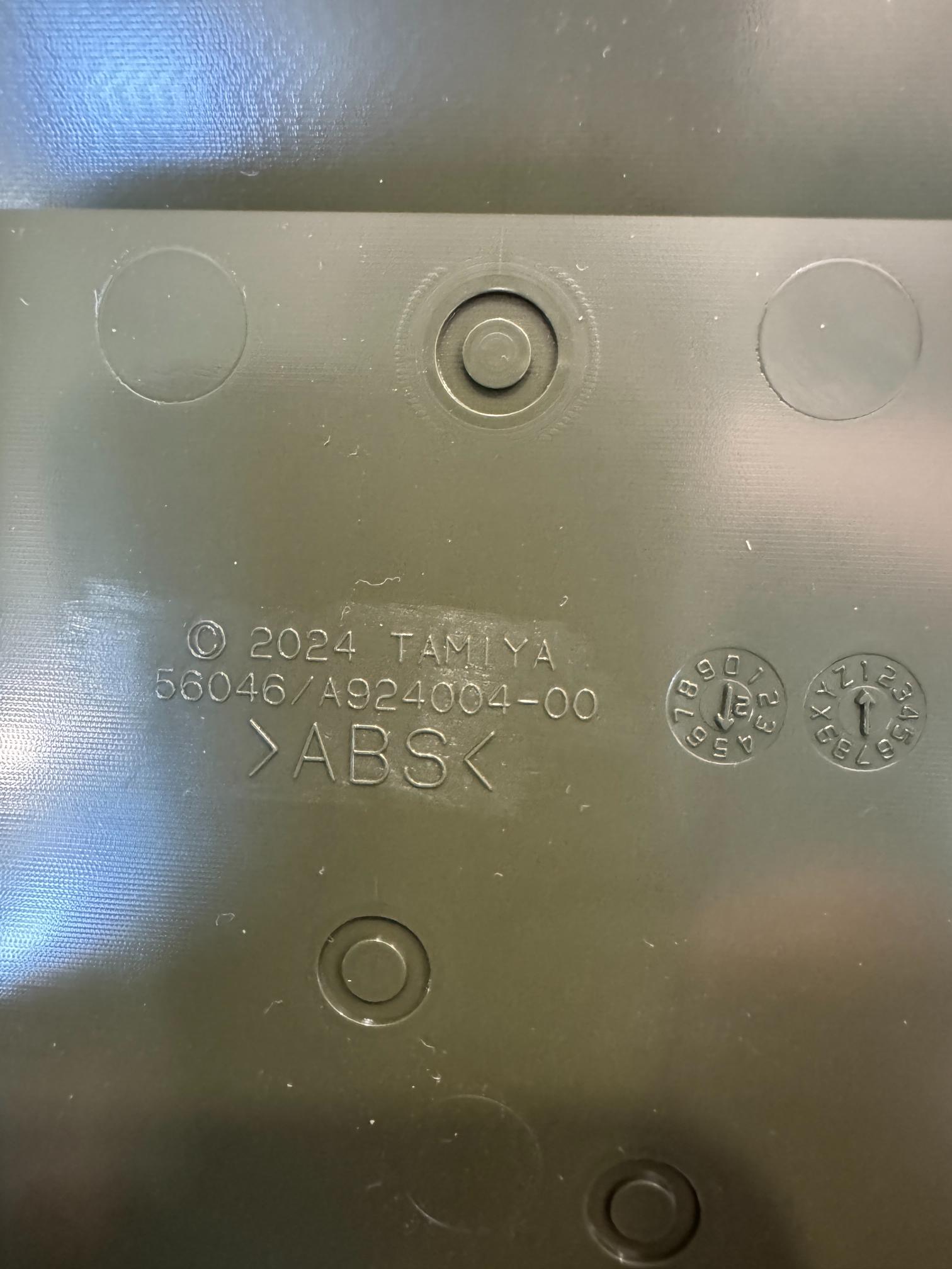

The kit uses threemain plastics, each clearly identified on the sprue gates or larger parts.

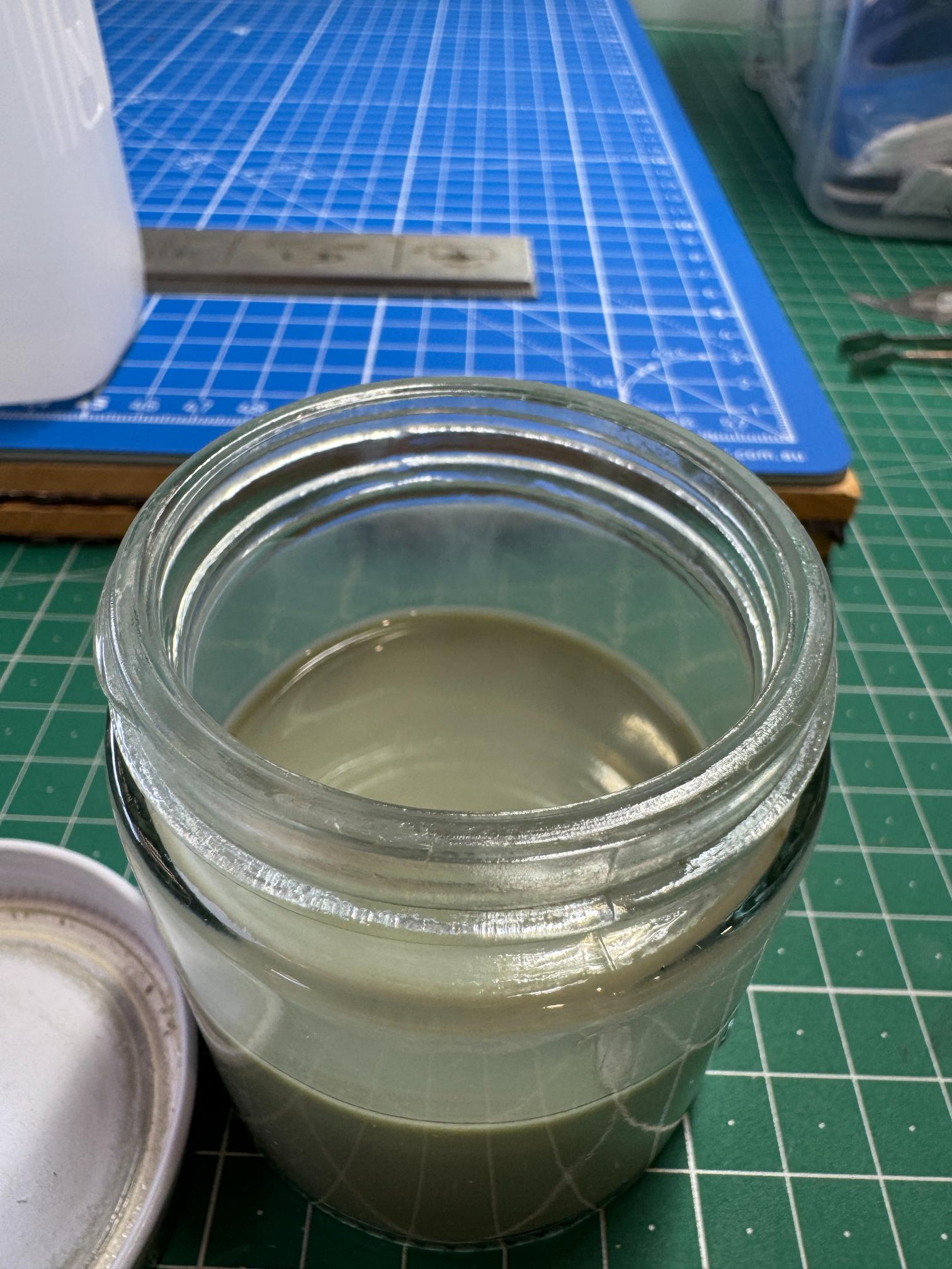

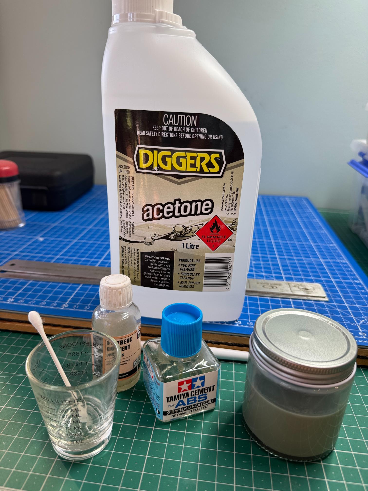

I want solvent-welded joints across all the plastic, rather than surface bonds, so I conducted some adhessive trials:
Adhesive Observations
Tamiya ABS Cement Viscosity relatively high; initial grab >30 s
ABS cement thinned 1:1 with acetone Improved flow yet still sluggish
Home-made blend (1 g ABS chips in 60 ml acetone) Thin, capillary action excellent; sets in ~10 s and cures rigid
Dang
This little sheet specifies Tamiya Extra-Thin Cement (green cap)—conventionally considered a styrene solvent—its label lists butyl-acetone, the active constituent of many ABS adhesives. So, I have learned a lesson already, Extra-Thin produces a reliable weld on both ABS-to-ABS and ABS-to-PS joints!

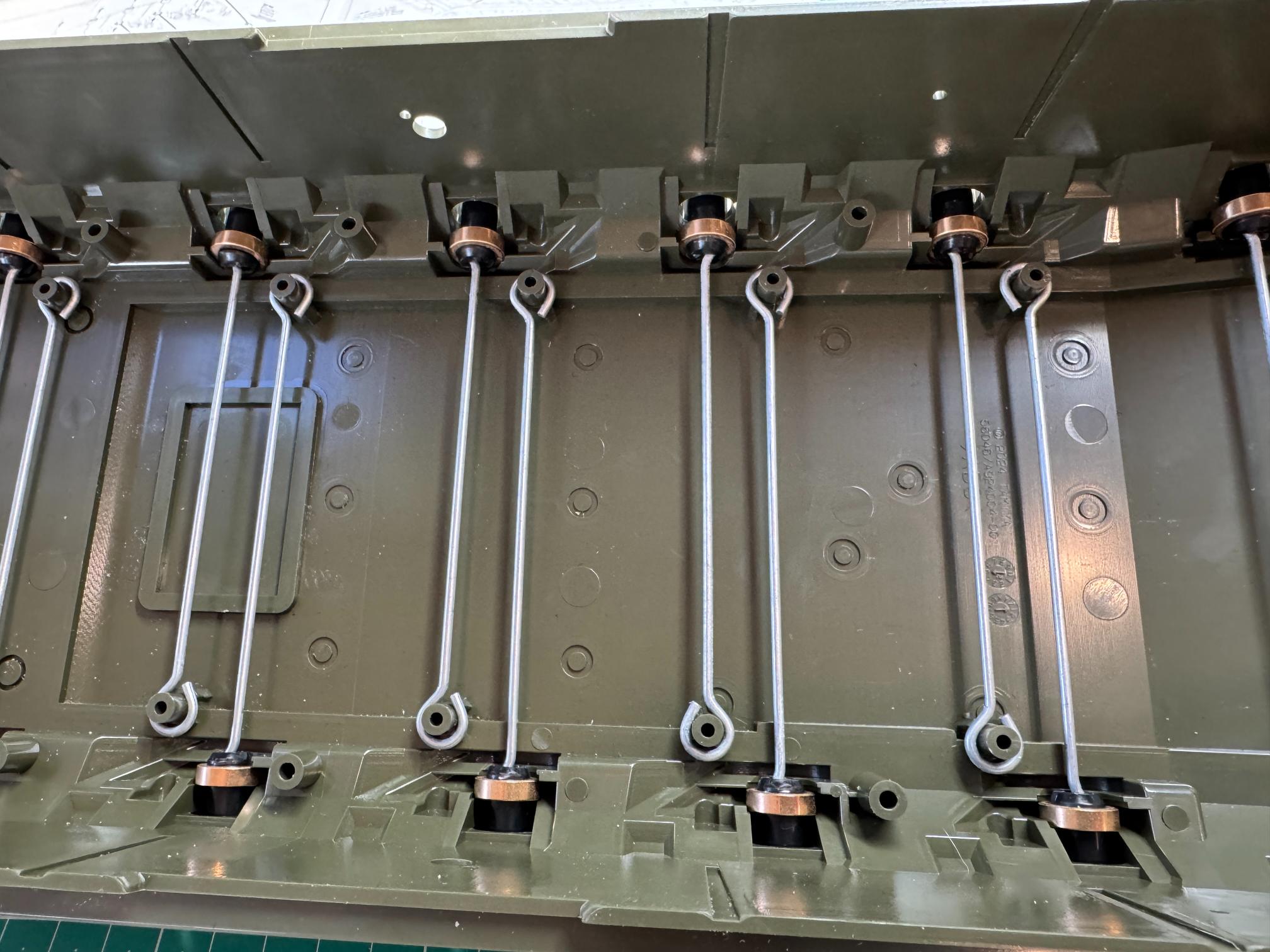

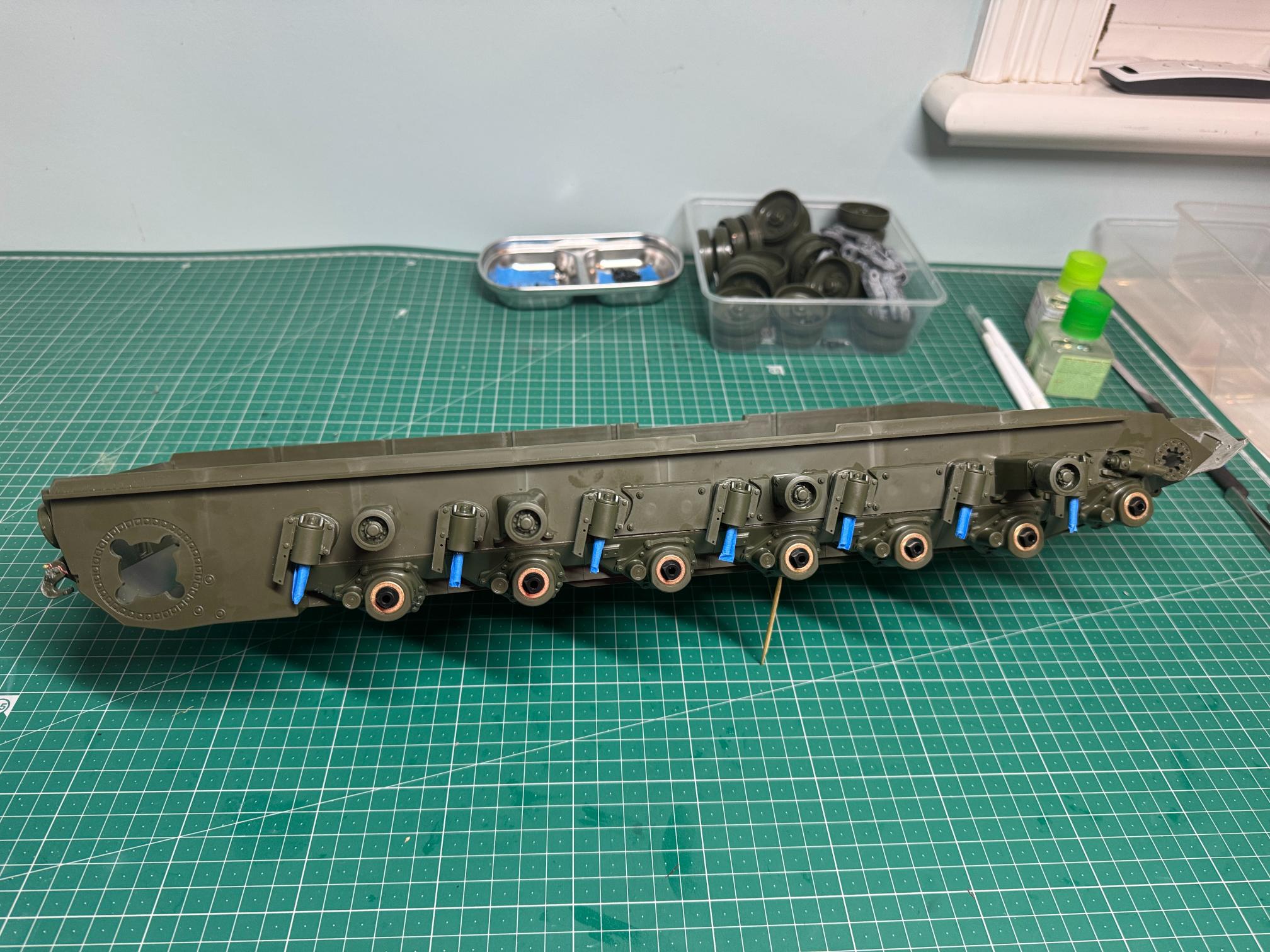

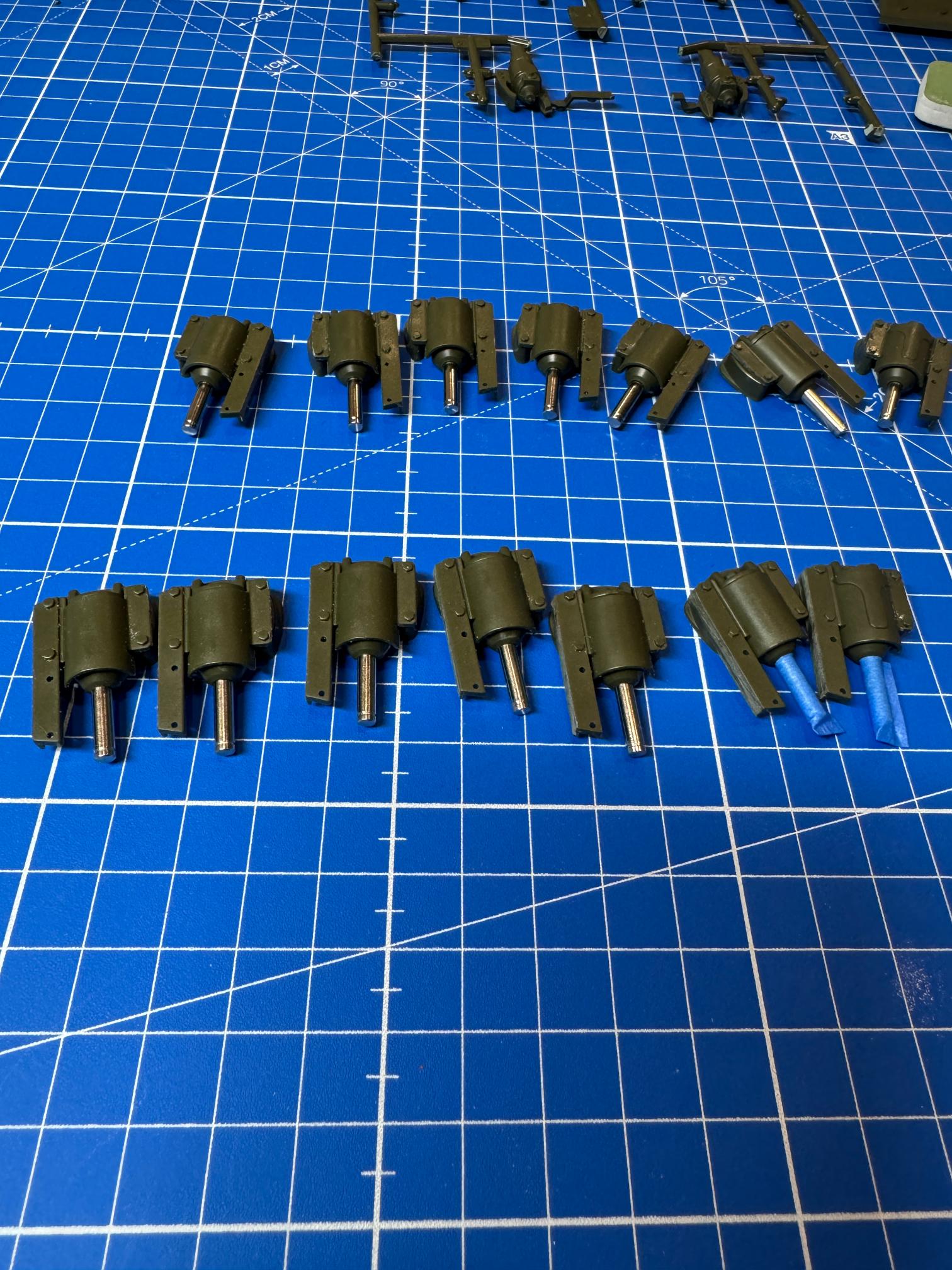

Removed thin galvinised layer form the swing arms in readiness for etch primer.
Completed lower hull.

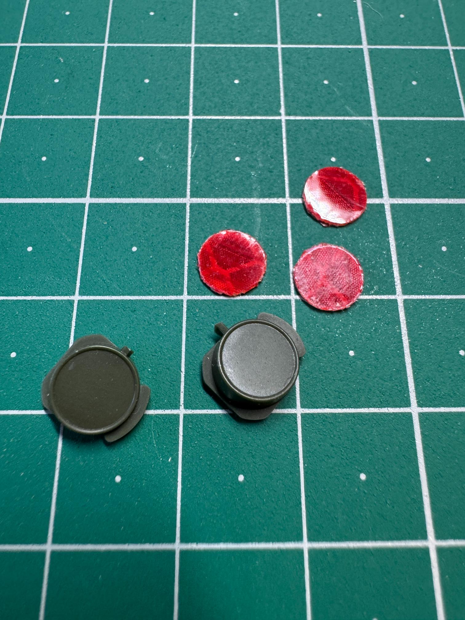

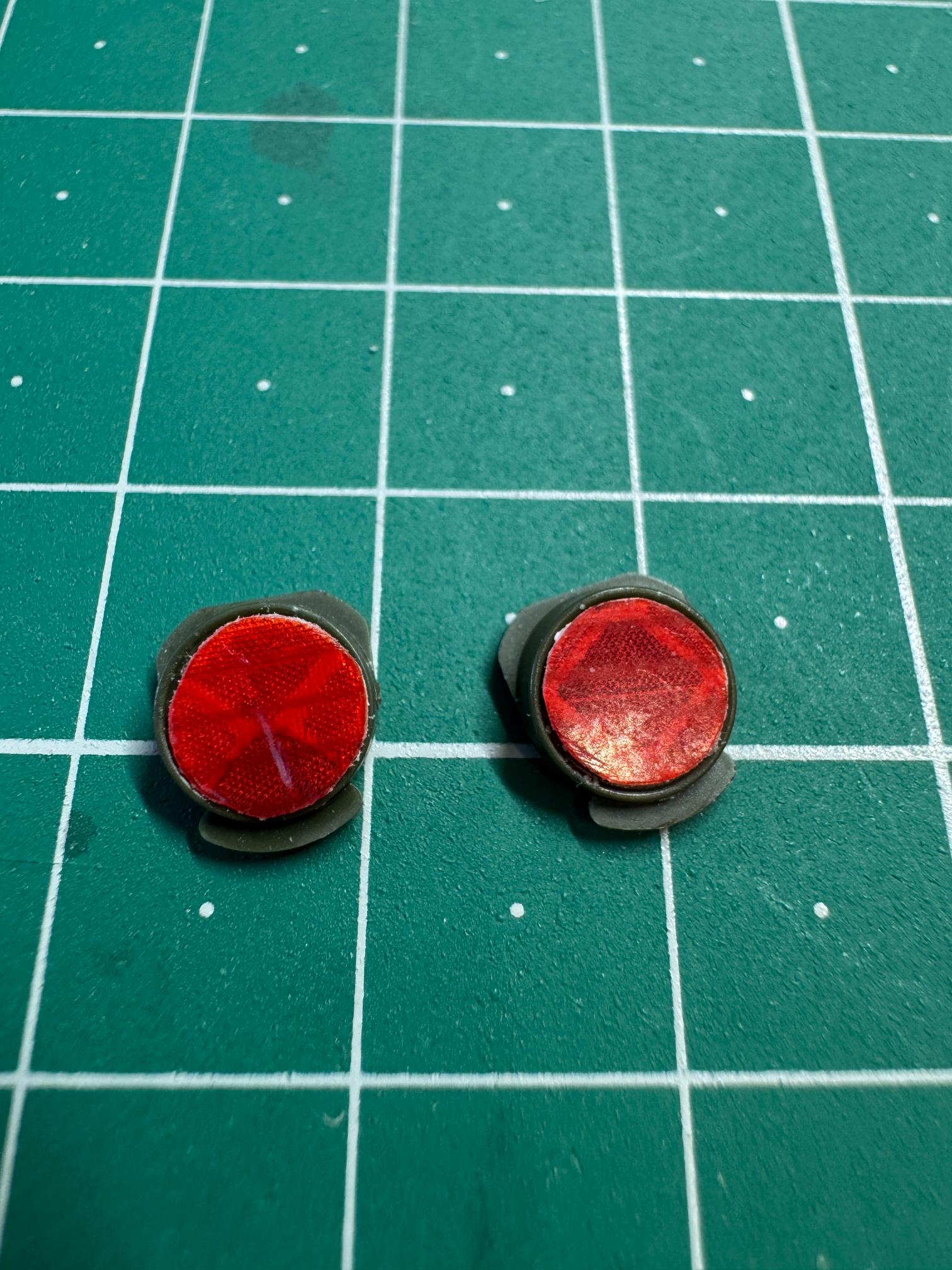

Modified rear reflectors using reflective strip.

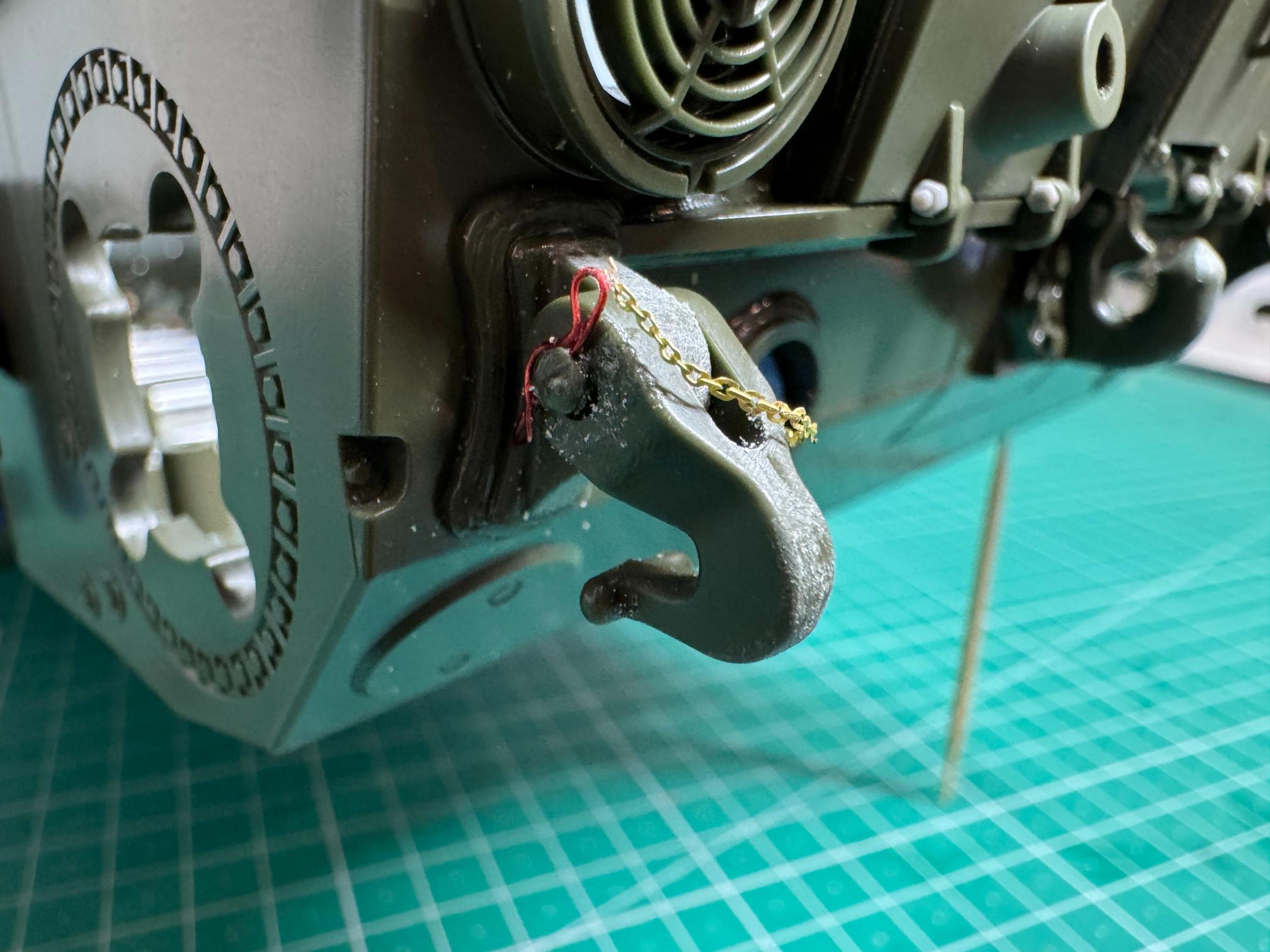

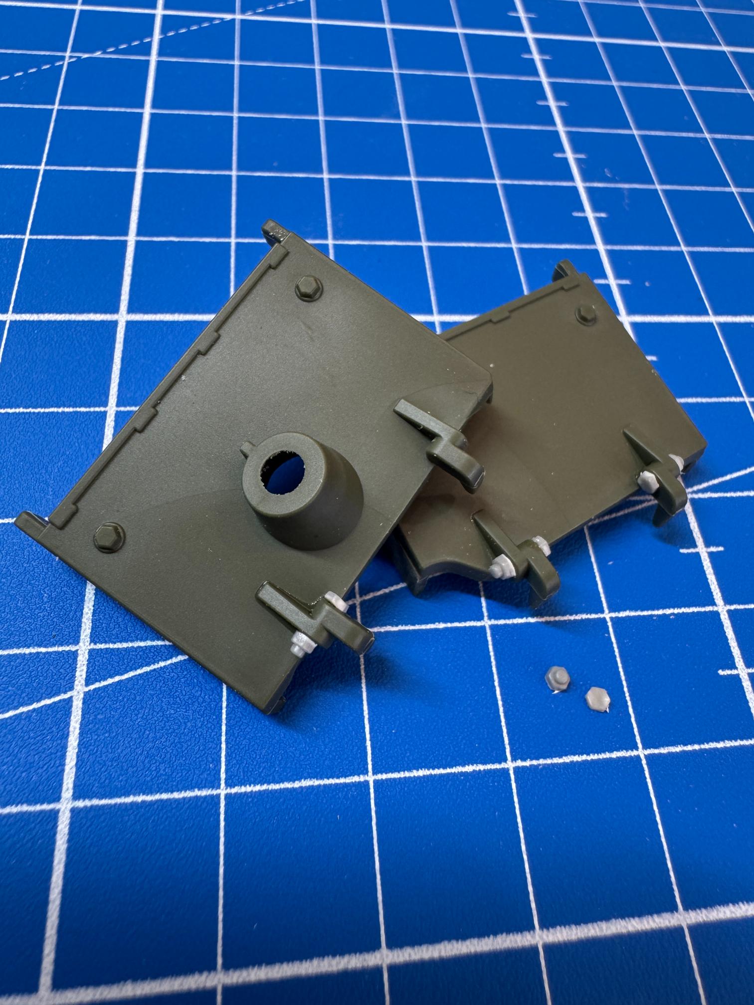

Add some detail to rear stowage boxes and tow hooks.

Tow hook detailing.

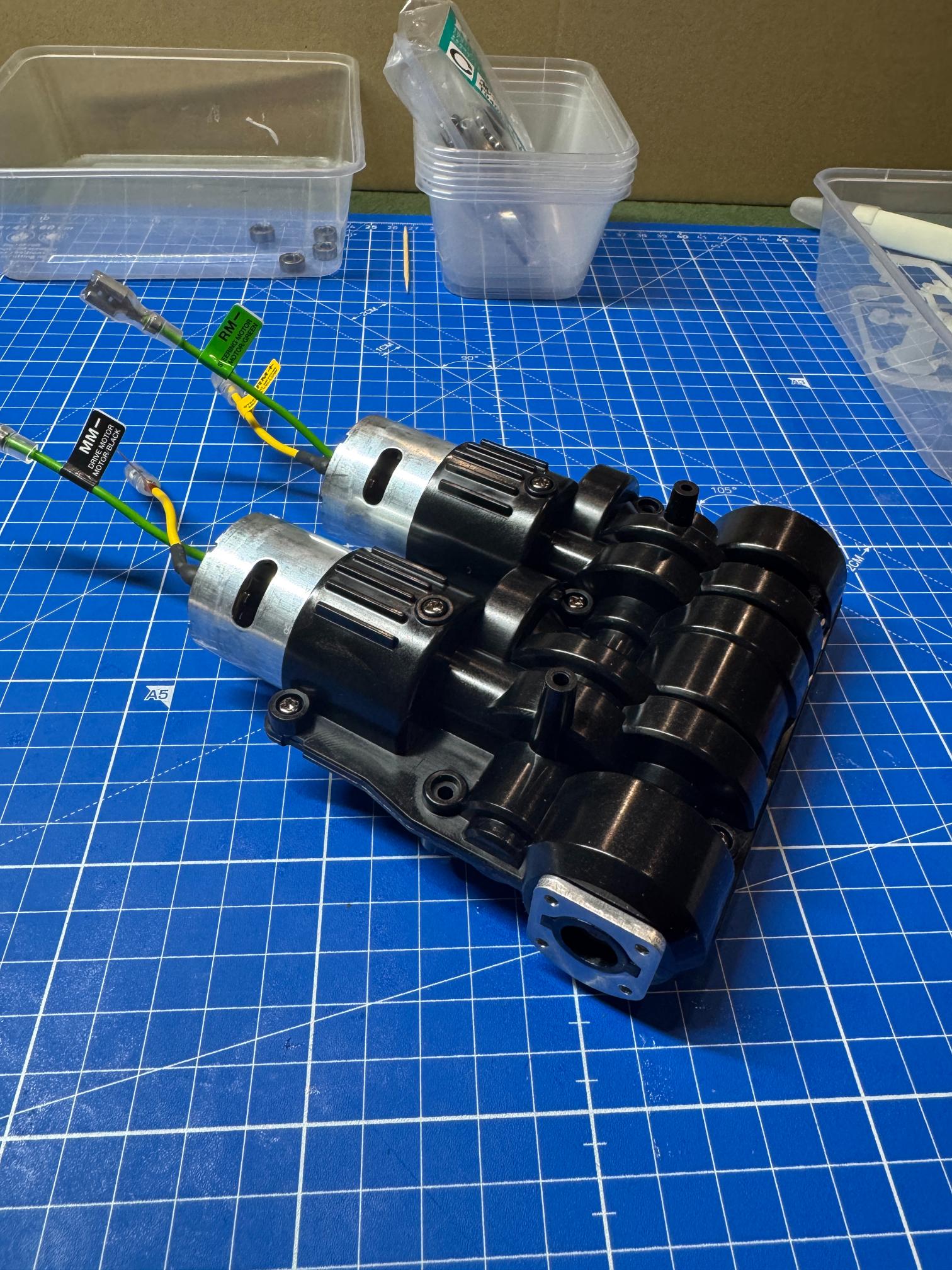

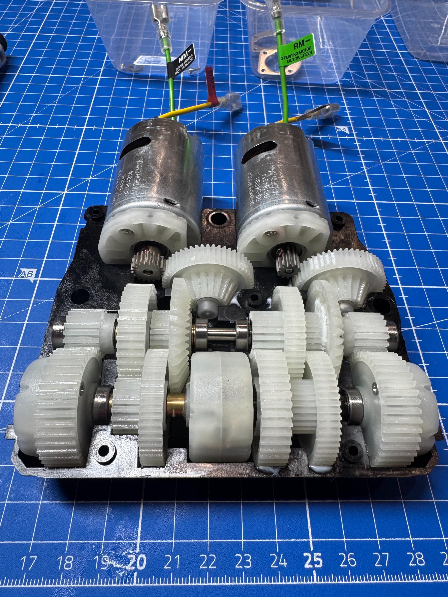

Transmission Build-up
