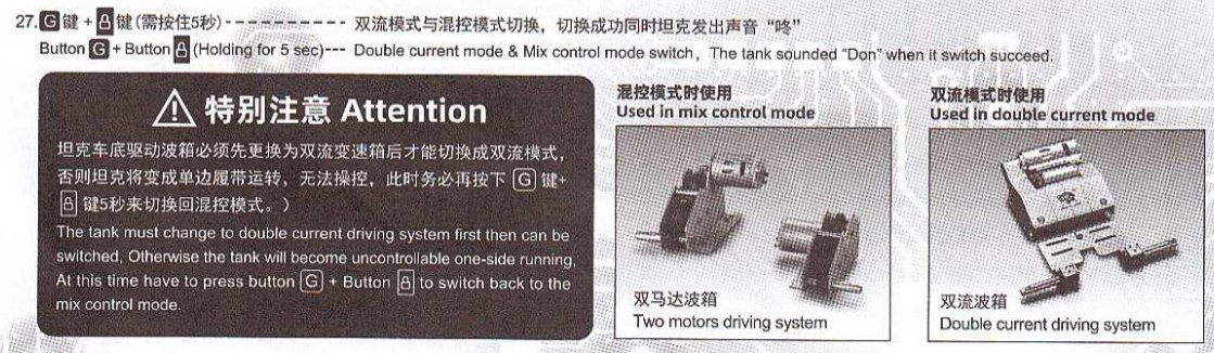

Post by Kaczor »
Remeber to setup this first. Working with my Collbank (Stuart, Crusader) gearboxes.
magnumwarrior001
Posts: 10
Joined: Tue May 20, 2025 12:27 am
Re: Heng Long PDSGB gearbox and MFU compatibility
Post by magnumwarrior001 »
Kaczor wrote: Sun Jun 01, 2025 3:48 pm Remeber to setup this first. Working with my Collbank (Stuart, Crusader) gearboxes.
Hey there, yes I did perform this switch right at the start.
