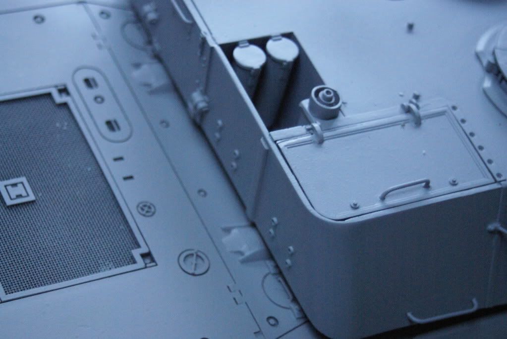

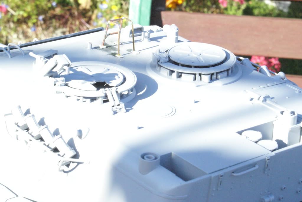

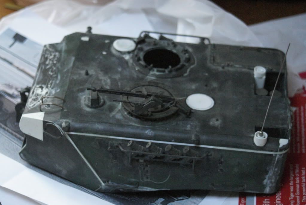

Here is the turret and this is where most of the work is neded. The left hand rangefinder is blcked off. the weld lines are missing. the circular item behind the loaders hatch is now there. Antennas are changed as is the gun sight. The wind sensor has now been fitted (not shown)
This is the uncompleted "all new" rear end. Yes there is now plenty of brass for better strength. I need spare track links to finish it off as well as better detail on the left hand box. Also desperatley need mudflaps.
This is just a shot of the tank with primer on it, note Jerrycan fix points. I would like to scratch build the mesh turret basket with the aircon installed.

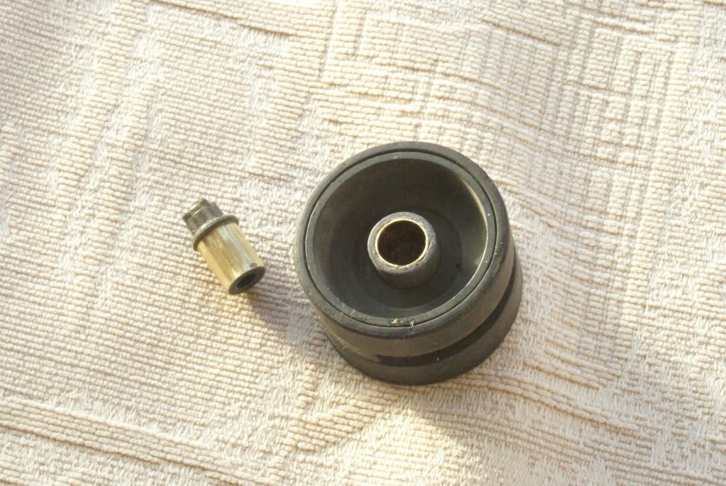

I've altered the wheels. hours of use had them wobbling in a weird way. the brass should firm things up a bit.
This shows the frame for the wind sensor and the new gunsight my dad made (he builds O guage trains you know).

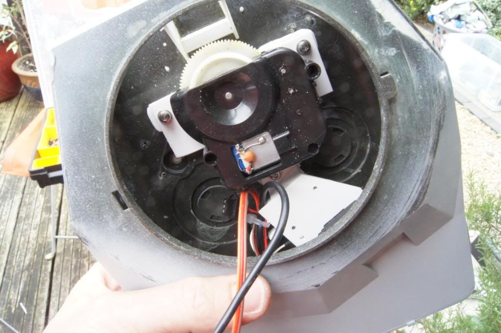

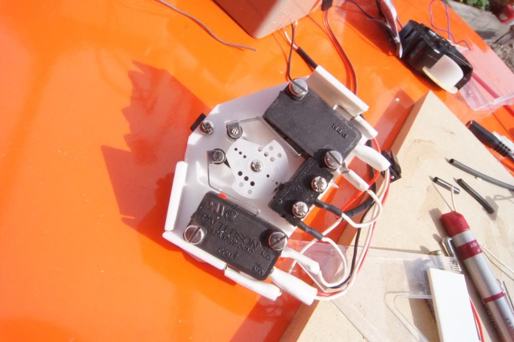

I worked on the gun elevation. I designed a means of controlling the power to the little Heng-long gearbox. I had to use 3 microswitches mounted on plasticard and activated by a micro servo. I wired it correctly first time (phew) and then mounted it far back in the turret. It releases with just one screw. Then it was a matter of mounting the gearbox, also removable. I'll find a small bearing now and fit it onto a shaft mounted from the back of the barrel and spring load it to the turret roof. I also fitted a steering servo in the hull and had a bit of a play.
