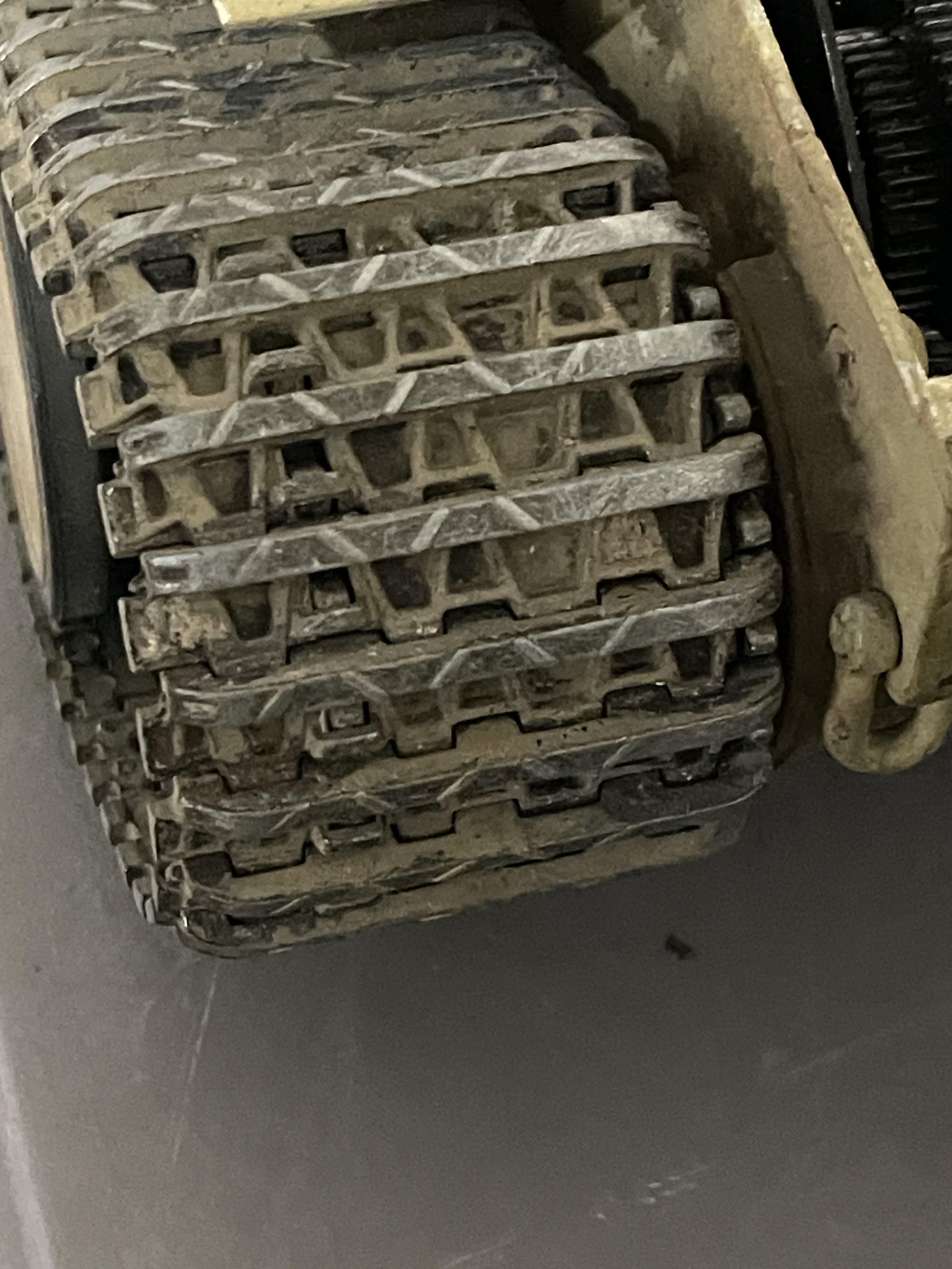

These are 2 shots of my Taigen mid Tiger's tracks ( thread made me realize it was time to charge the battery) This was my very first RC tank and this is the second pair of tracks. As one of my 2 main battlers these tracks probably have at least 60 hours of field time on them (believe me on our field that is torture testing) I think the original TS-63 coating has held up considering the abuse (look at those worn cleats) Like Rob I used no primer because as I found on my Taigen Panthers that if you use too much paint it starts to cause some of the links to get sticky. Of course there is nothing that beats running these things in the dirt and dust for realistic weathering
