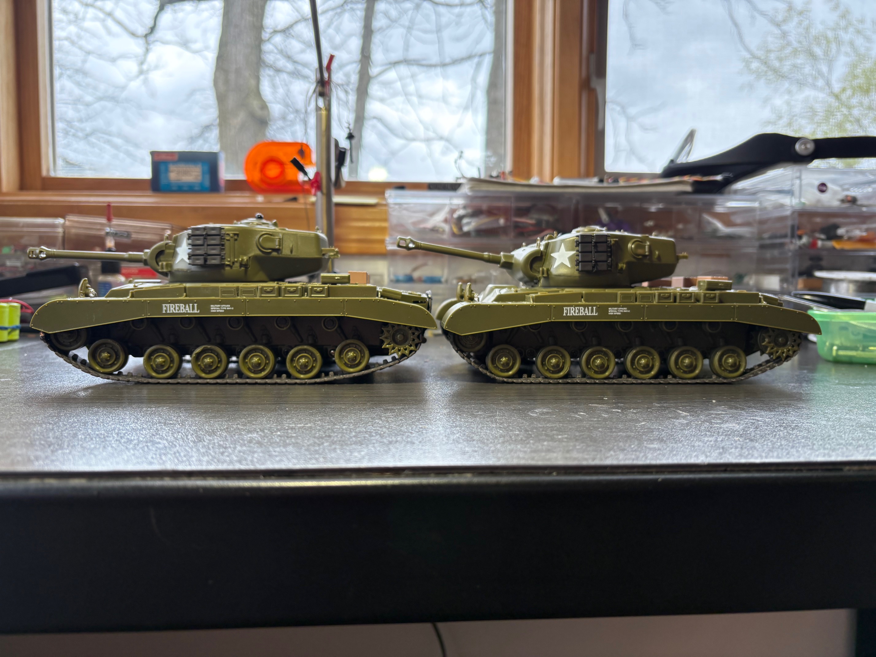

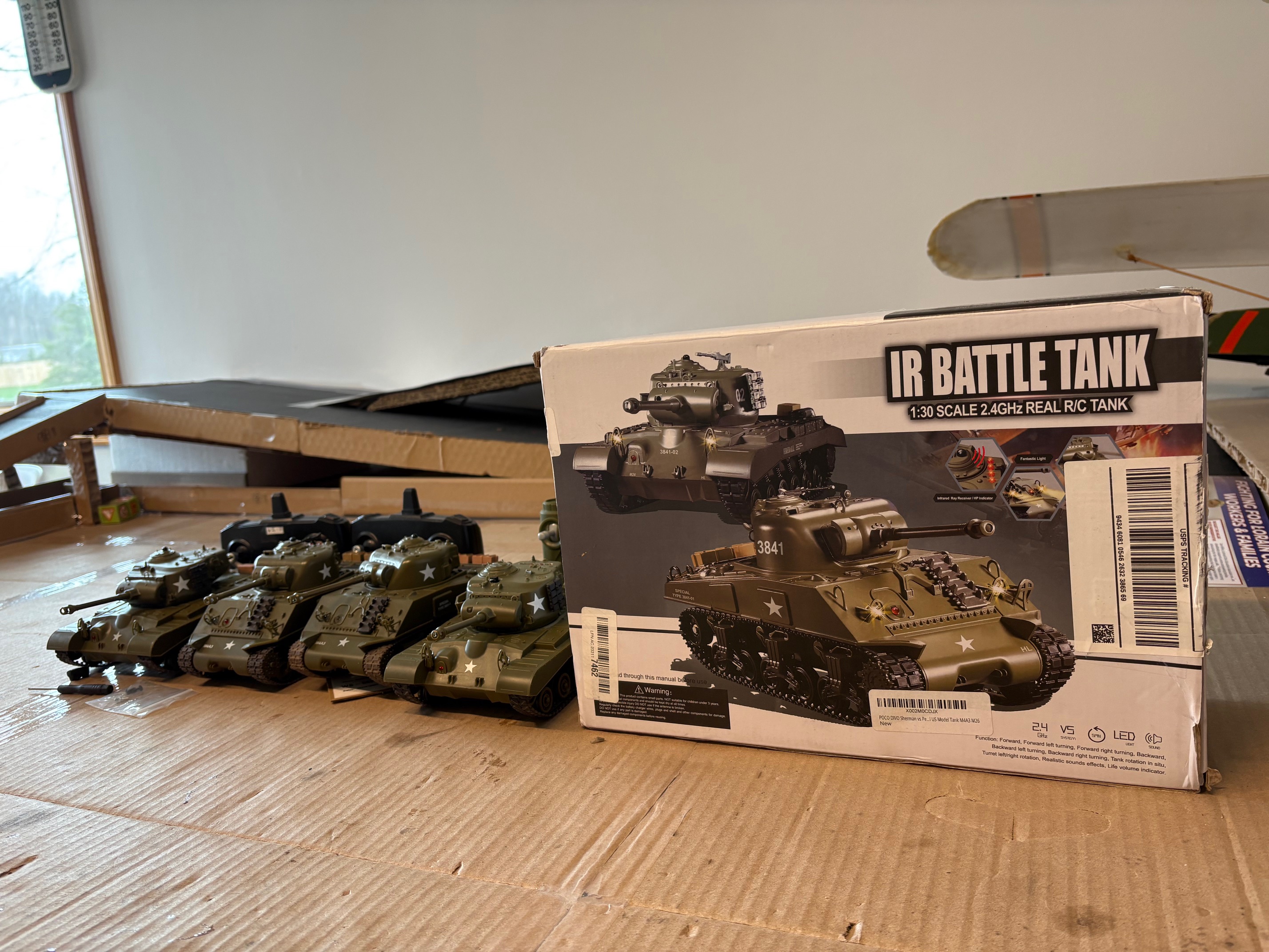

the tank in front has the suspension mod and now has four road wheels touching the ground at the same time  compared to 6. This is the only way to adjust the track tension and reduce turning resistance. Result of this mod is better turning and longer run time.

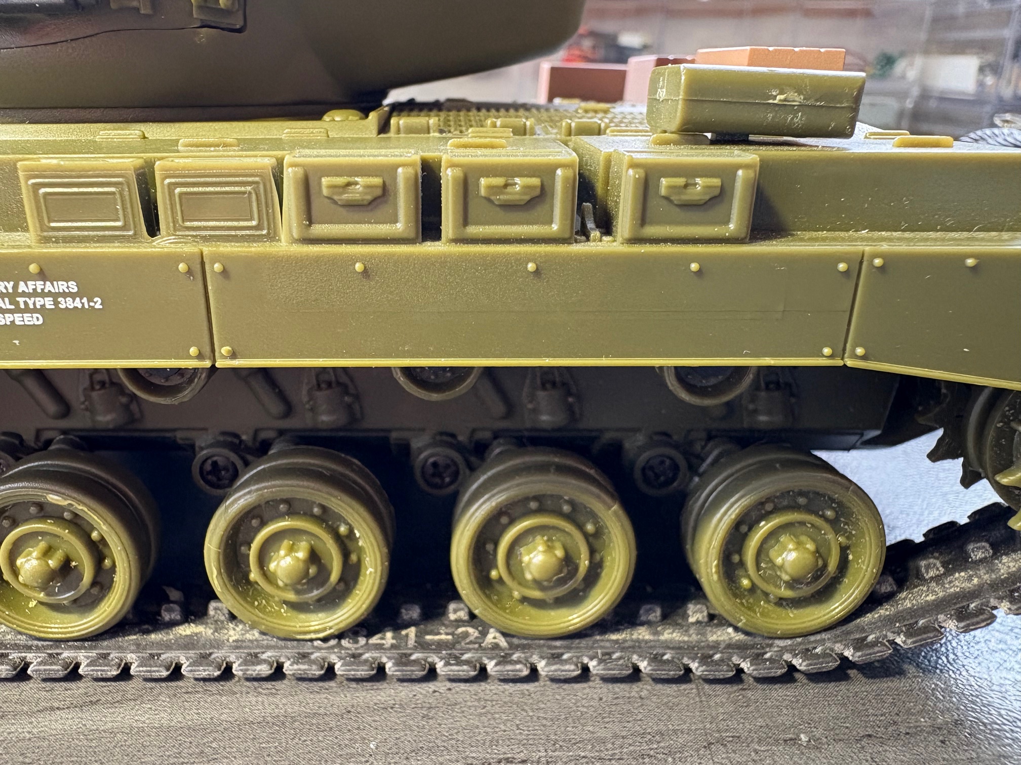

With all of these road wheels in the same straight across axis, there is too much turning friction and track tension.

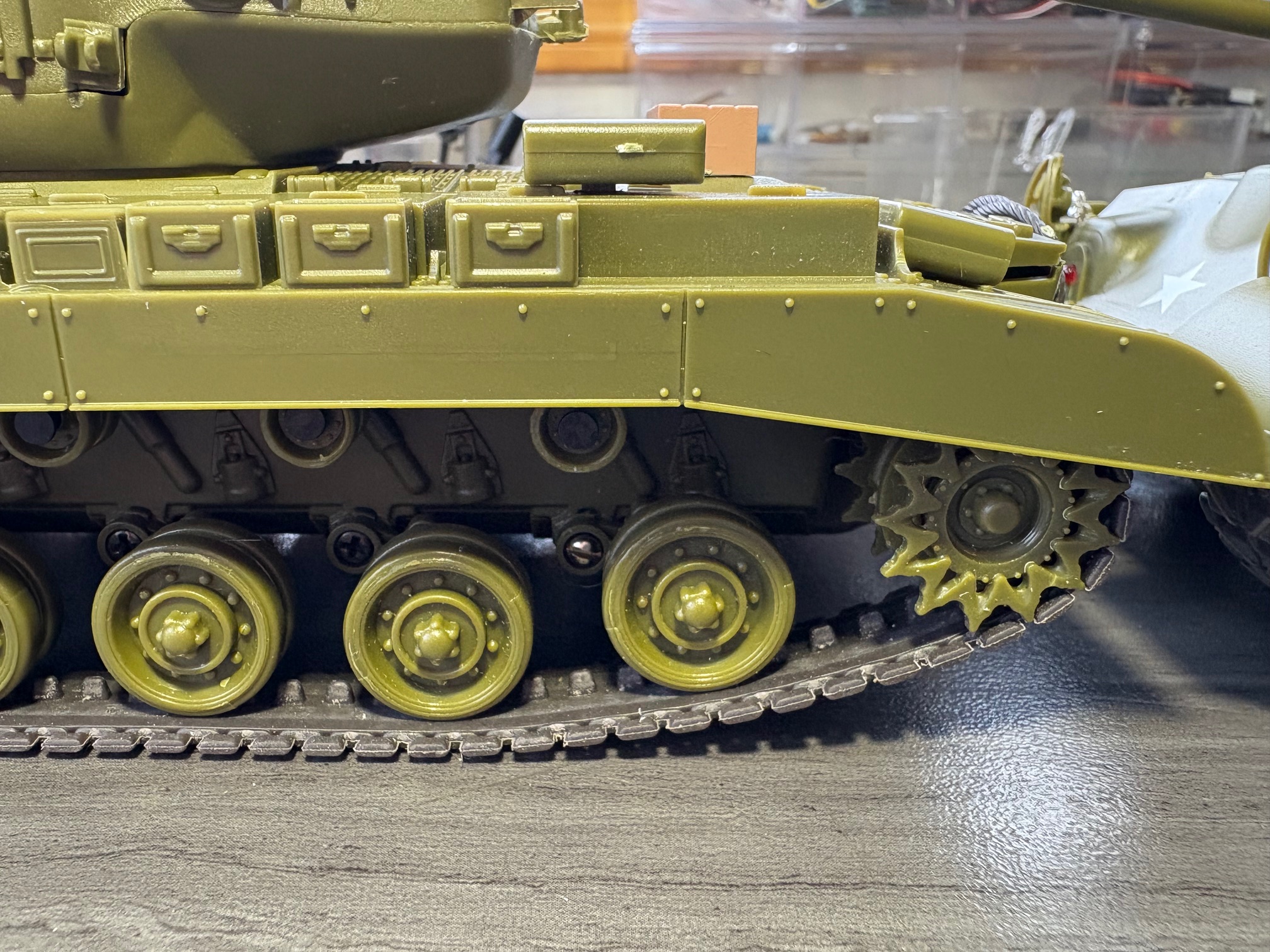

Rear road wheel moved up a few degrees. Less ground friction and track tension.

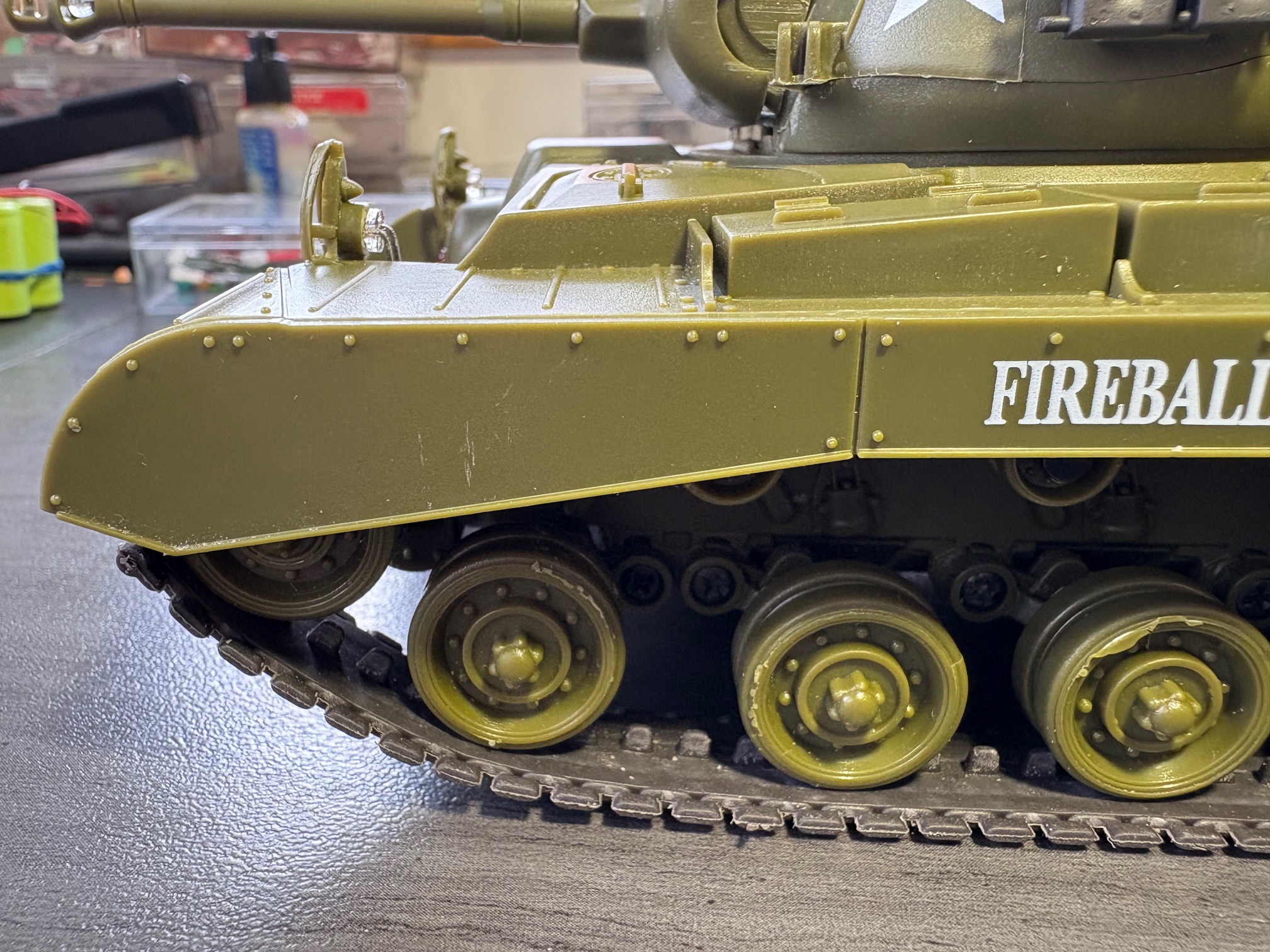

Looks a bit flat footed to me.
Front road wheel moved up a few degrees. Less ground friction and track tension.

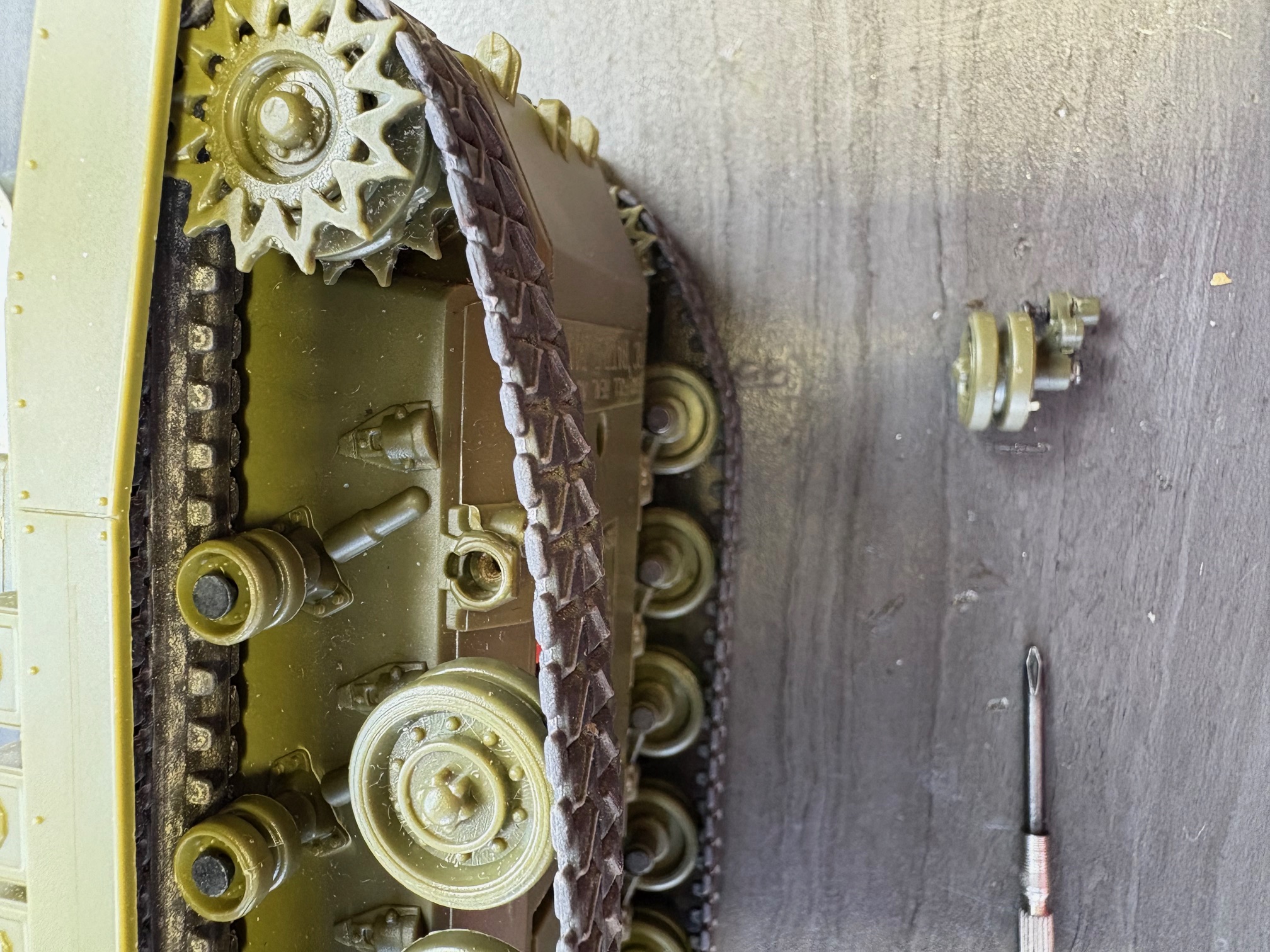

Axle in question has been removed. Turn the screw slowly CCW to remove. Too much torque  will strip the threads so when reinstalling the screw, turn CW and stop when just a bit snug. Anymore than that the threas will strip.

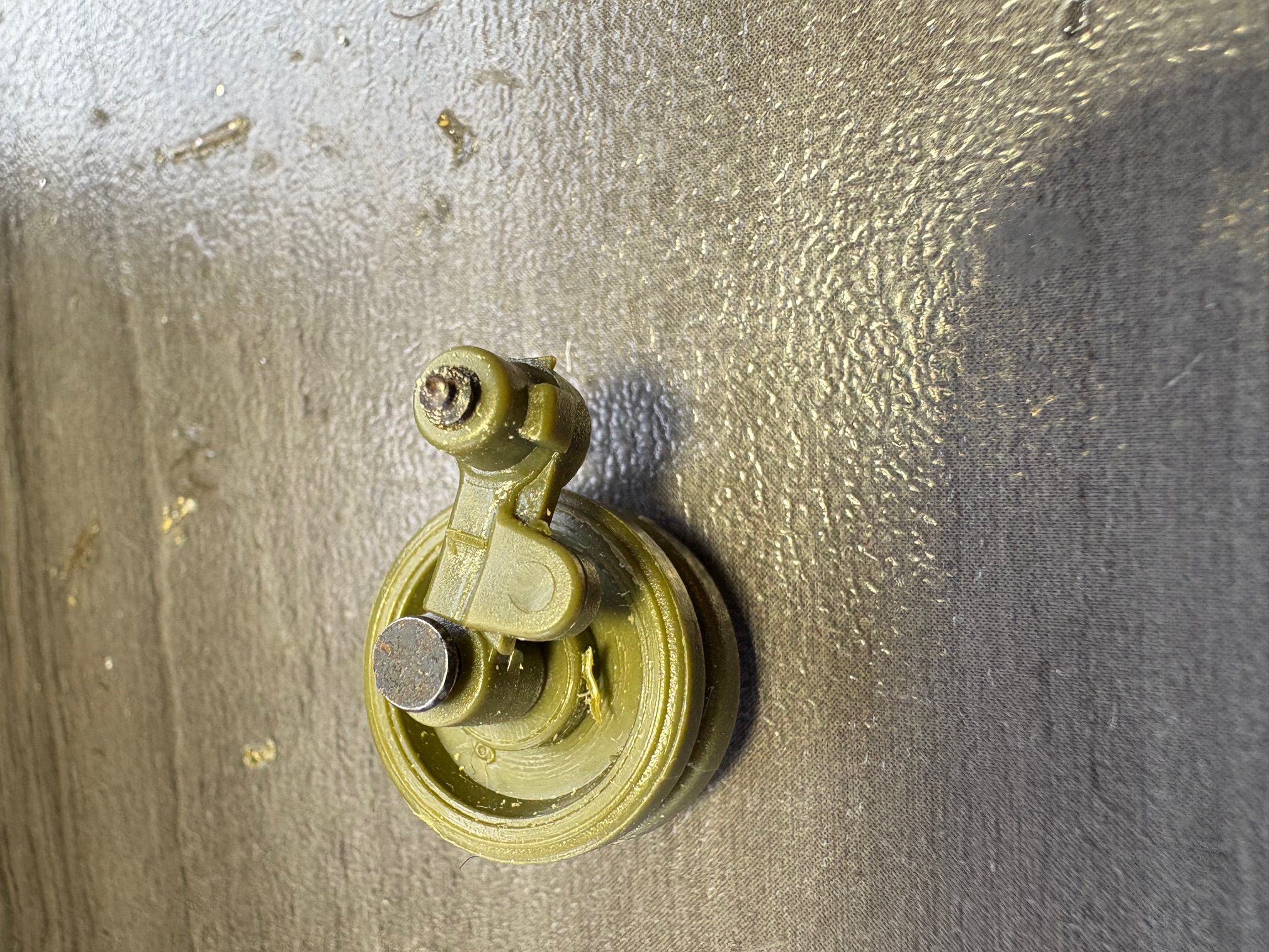

The position nub visible near the screw. This will be carefully removed so as to not ruin the axle. I use a set of precision electrical snips.
Axle has had the position nub removed.
The trimmed road wheel will now rest on the stop. The others are off the stop boss.
