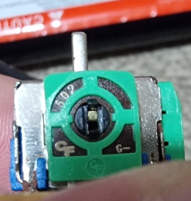

I'm looking to replace the L&R potentiometers(the whole component).
All I can see on them is CF502 G-
Can someone clarify which ones will fit/work.
Circit board below...

https://aliexpress.ru/item/32954287638. ... _rcmd=core
This is for you!
How did you manage to render it unusable????

Pavel wrote: Thu Jan 16, 2025 3:07 pm https://aliexpress.ru/item/32954287638. ... _rcmd=core
This is for you!
Thank you. 👍
The brass cage has detatched from it's mounting point on the left controller. So there is sometimes reduced movement.
I bought this one used, so it has broken or worn at some point on it's travels.
I took a PS4 controller apart, butchered it, and the potentiometers are different... 🤦‍♂️🤪.
