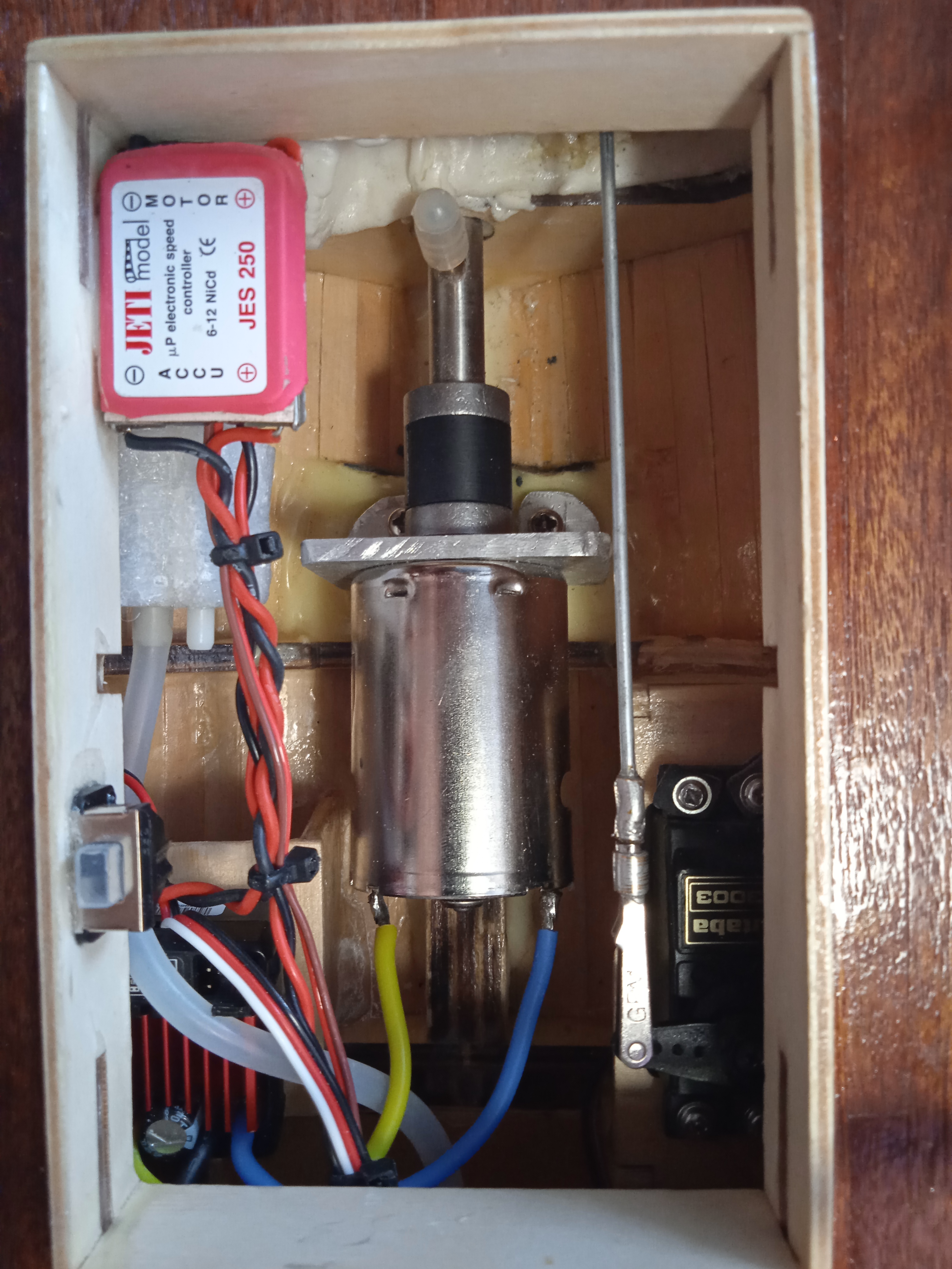

But I made the fan operation proportional by using a small speed controller, thus regulating the smoke stream from small to strong....
True, I have a Futaba 10 and a bunch of channels that I can use at my own discretion
