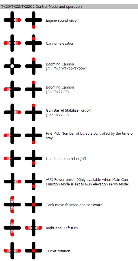

Hello everyone,
Having a TK 24 card from Clark, I wonder about the fact that for many functions, it is necessary to operate both handles? Is this normal? because in the SBus version it seems simpler? Is there a way to have the same functions, with a TX like Flysky ER9X with modified firmware? Thank you in advance for any help :thumbup:

Well! I actually created mixes for the standard 4 channel tk24 to make it work like an sbus. The elevation was tricky but managed to move everything off the sticks onto buttons and had elevation and rotation on left stick, drive on right and rest on switches.
I had the ersky9x firmware

8O Hello, does anyone have an idea for getting a TK 24 Clark to work? without having to use both sleeves for certain functions, see attached diagram. Asked question in PM? Qualified members? but seems not possible if not Sbus ??This from programmable TX ER 9 X (Flysky Flashé !
Have at least: cannon fire, MG 1/2, engine start-up, tank start-up, on switch?

Hello everyone, following request without answers? I appeal one last time to the kindness of a person? likely to tell me, how to map a Clark TK 24 with a Flysky TH9X radio flashed ER9X? without having to manipulate the sleeves 36 times? Thank you in advance, have a good rest of the day :)
