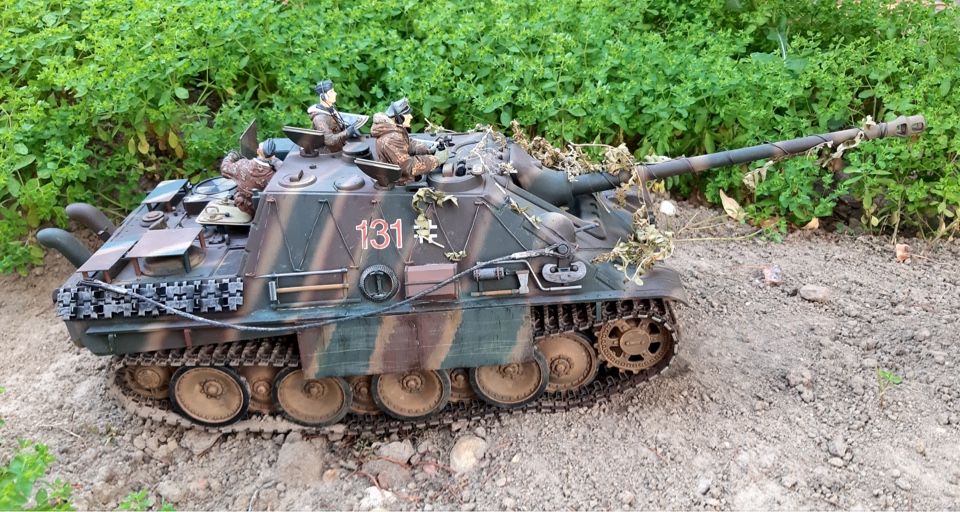

Hi all, hope everyone's well and am after some collective wisdom on an issue I have.
Am building a jagdpanther at the moment, the weald foundation jagdpanther as my inspiration. Purchased all of the bits separately from forgebear, taigen / rctank.de lower hull, hl upper, metal running gear and 7.1 taigen gearboxes, got a tk50 board for it too.
When I am assembling the parts and fitting the tracks the rear idler is really 'high'. I have the idlers adjusted with the tensioner to the lowest they can go. When I fit the tracks they are really tight, very difficultto even fit and shoildnt be like this, to the point where they are compressing the road wheels and the rear one is not touching the floor properly.
If I put a spare link in then they are really loose, if I try to tension them then the idler goes higher and the tracks scrape on the hull sponsons. On the attached pics, one side has the extra link and one the original length.
Dom at rctank.de has some henntec tensioners, i dont know if these are any good and may solve the issue. Has anyone run into the issue before or anyone got any advice here?
Pics to illustrate the issue
Thanks in advance

Hey Dave!
First of all, that JaPa looks great, just like the real thing in Bovington!

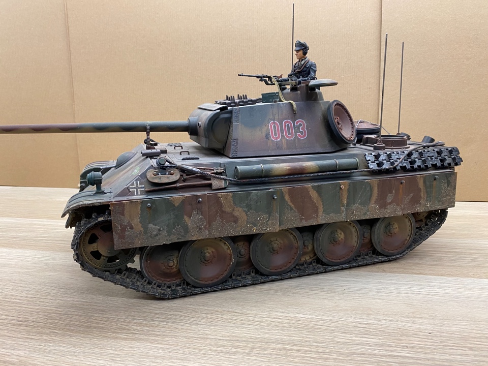

Strange, I do have 2 Taigen Panthers and 1 Taigen Jagdpanther, but on none of them has the issues you have.

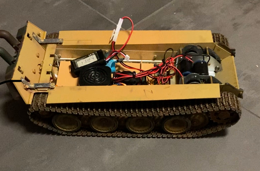

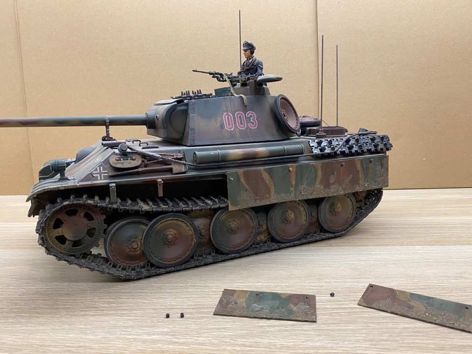

The only thing I did on all 3 of them, is bending the torsion bars. Because on the real thing the Sprocketwheels are higher than on the models. It is difficult to put the spr.wheels higher on a metal hull, so the only option for me was bending the torsion bars to make thr spr.wheels look higher.

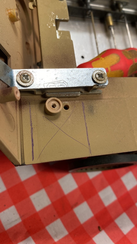

What I also did, I cut out a part out of the lower hull, above the idlers, because I had an issue with little stones got between the tracks and the hull, so they blocked the tracks. Cutting out a part of the lower hull just above the idlers, solved that problem for me.

Just looked at your pics again Dave, the Panther seems a bit high on its wheels.
Maybe consider bending the torsionbars so the entire TD could get a bit lower, which could loosen the tracks a bit too.

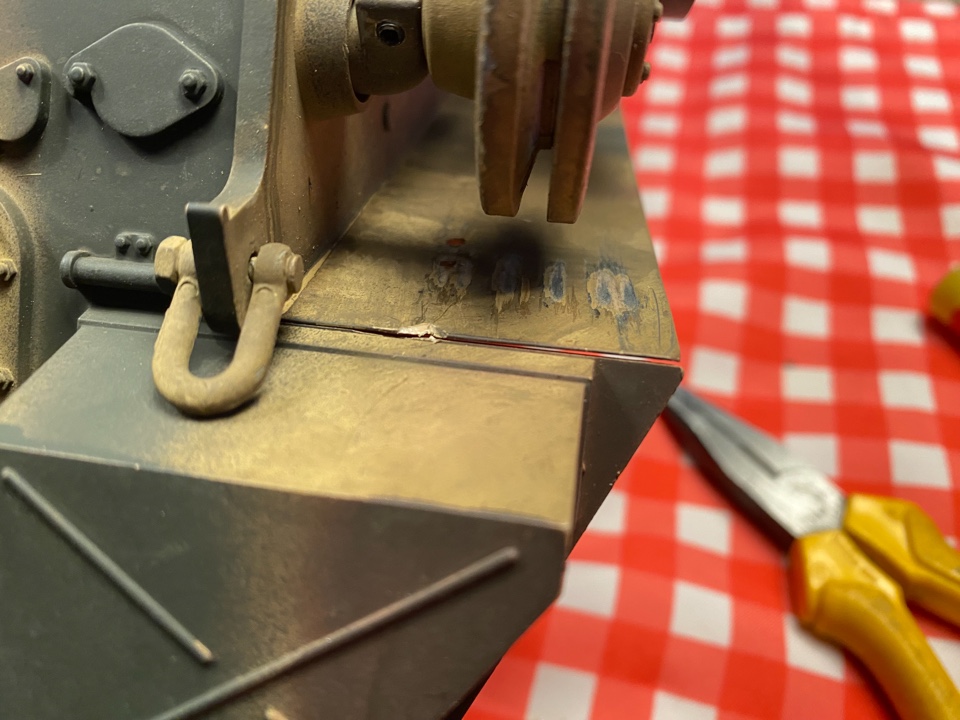

Dave, got some pics for you how to solve the stone issue:
In this pic you can see the tracks were scraping onto the lower hull:
Imagewww m
I did cut this section out:
Afterwards it looked like this:
And here it is with the Bovington Lookalike mounted schurzen.

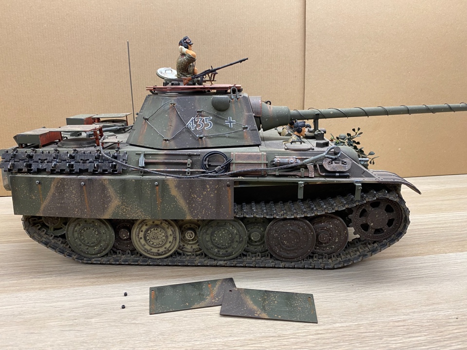

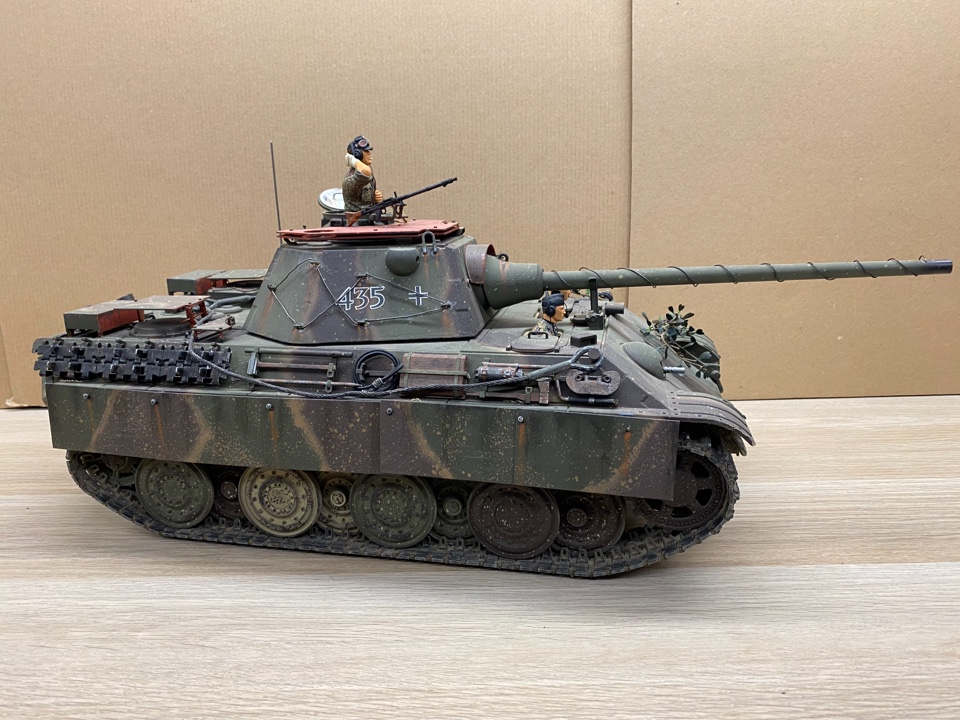

But you also could choose for detachable schurzen.....also homemade out of 1mm thick aluminum.
I did that on my Taigen Panther-G and the Panther-F, a few years ago.
Maybe not scale, but that's not really so important to me!
The stuff just has to stay on the Panzers during outdoor rides!
That was my first attempt to make schurzen onto tanks, a different setup which works good too!
