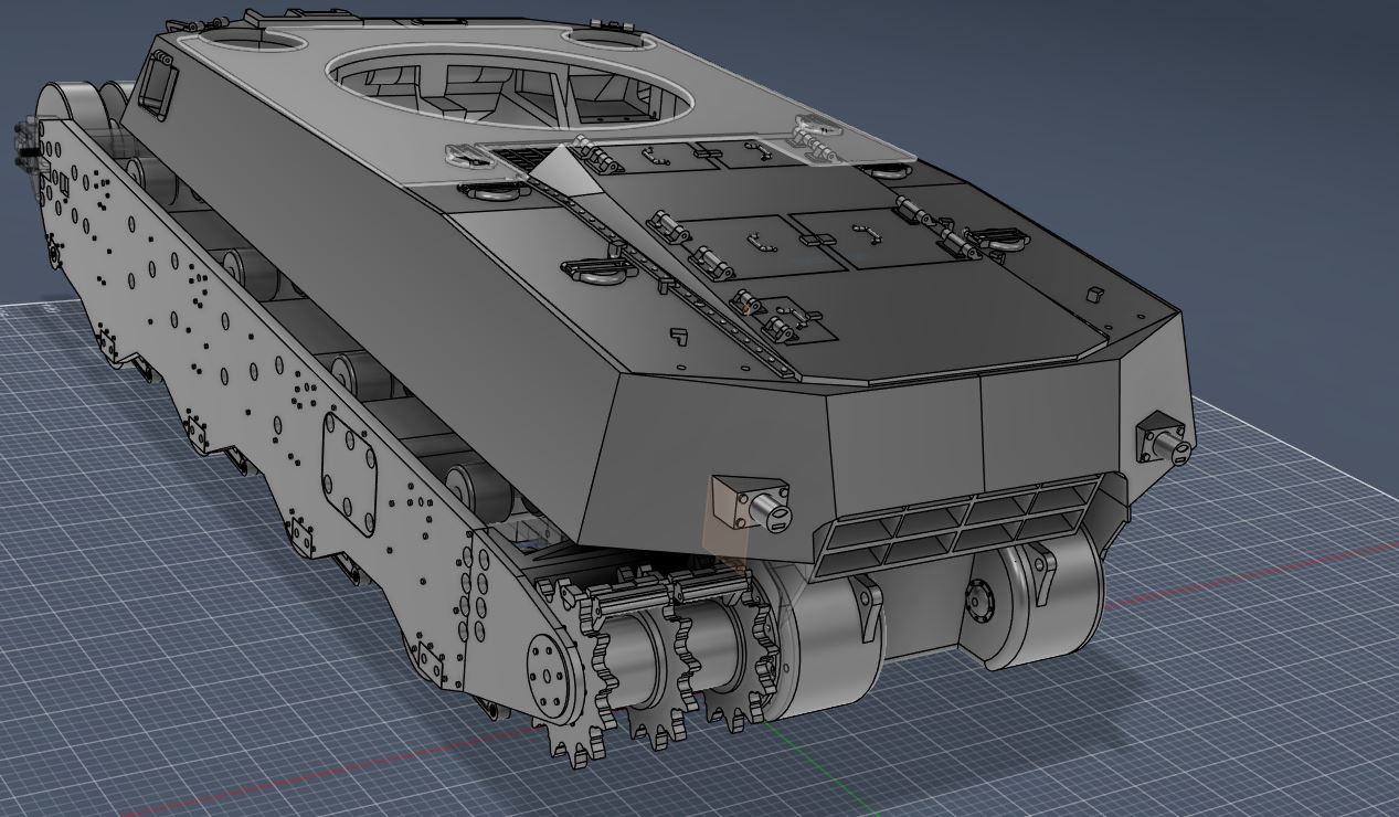

Yep the spoiler from the T14 thread is the M6a1
I currently working on the hull,the final tank will have compatibily with the cannon smoke unit and the engine smoke.
The M6a1 has the early hvss suspension , I counted almost 100 link for one track ( be prepare to print 200 link ).
Next step the double cannon turret

Update
Almost finished hull, with interior designed to accomodate a heng long 7.1 , a 6500 mah battery , a speaker , 2 smoke generator ( one for the engine smoke the other for cannon smoke)
Almost 100 link per track
I'm planning to add the possibilty for the Mg led , I added the rearlight with a 2 red 3mm led

Yes, I am one among probably many watching with admiration. That turret drive ring looks seriously heavy to stand up to use. I see only one set of gears in the bottom photo, but I suspect that's just to make mounting points clearer.

Herr Dr. Professor wrote: Mon Oct 28, 2024 7:45 pm Yes, I am one among probably many watching with admiration. That turret drive ring looks seriously heavy to stand up to use. I see only one set of gears in the bottom photo, but I suspect that's just to make mounting points clearer.
The turret ring is from the Firefly , i'll try to minimize the weight of the turret.
