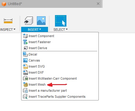

Step 2. In a new empty part, in the solid (or surface, or mesh, doesn't matter) tab, Insert > Insert Mesh.
Import 1.jpg (29.88 KiB) Viewed 3288 times

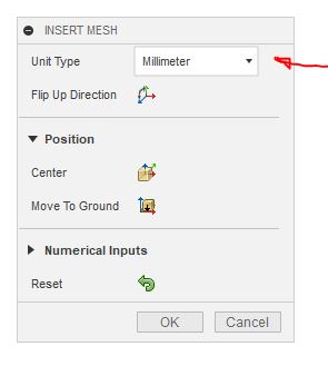

Step 3. Make sure you have Unit Type set to 'Milimeter' in the dialogue box, otherwise it will import using centimeters as the unit of measure and your scaling will be out (this is what happens if you use File > upload instead of Insert Mesh)
Import 2.JPG (13.34 KiB) Viewed 3288 times

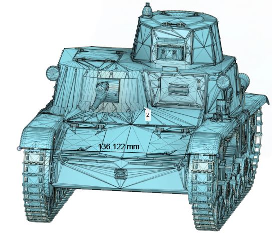

Step 4. Check the scale by measuring something on the mesh that you can verify against published figures, i.e. the overall width:
Import 3.JPG (45.32 KiB) Viewed 3288 times

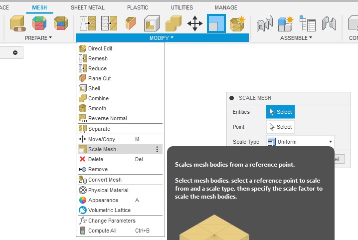

Step 5. In the Mesh tab, Modify > Scale Mesh
Import 4.jpg (78.32 KiB) Viewed 3288 times

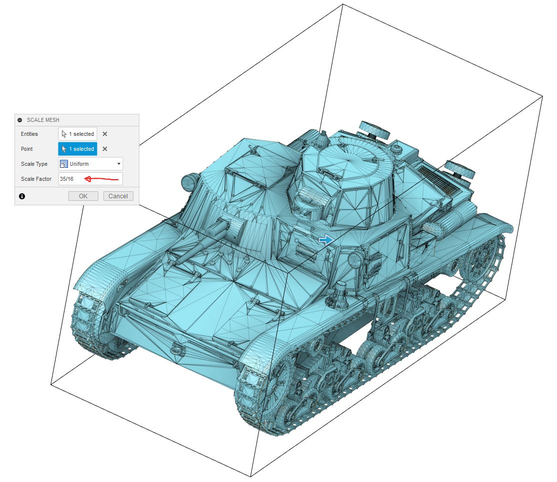

Step 6. Pick the imported Mesh, pick any point on that mesh (make sure Scale Type is set to 'Uniform'), and enter your desired scale - in this example I have a 1/35 scale mesh, and I want 1/16, so therefore the scale factor is 35/16. F360 will very helpfully accept an equation rather than a figure, so you don't even need to get the calculator out...
Import 5.jpg (149.95 KiB) Viewed 3288 times

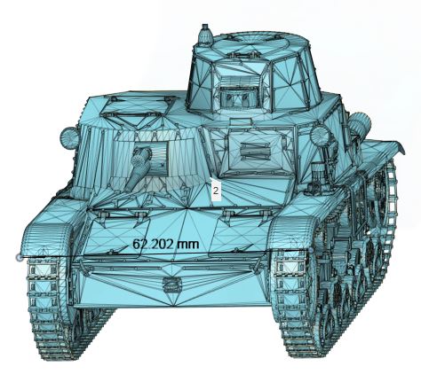

Congratulations, you now have a 1/16 scale mesh:
Import 6.jpg (57.44 KiB) Viewed 3288 times
