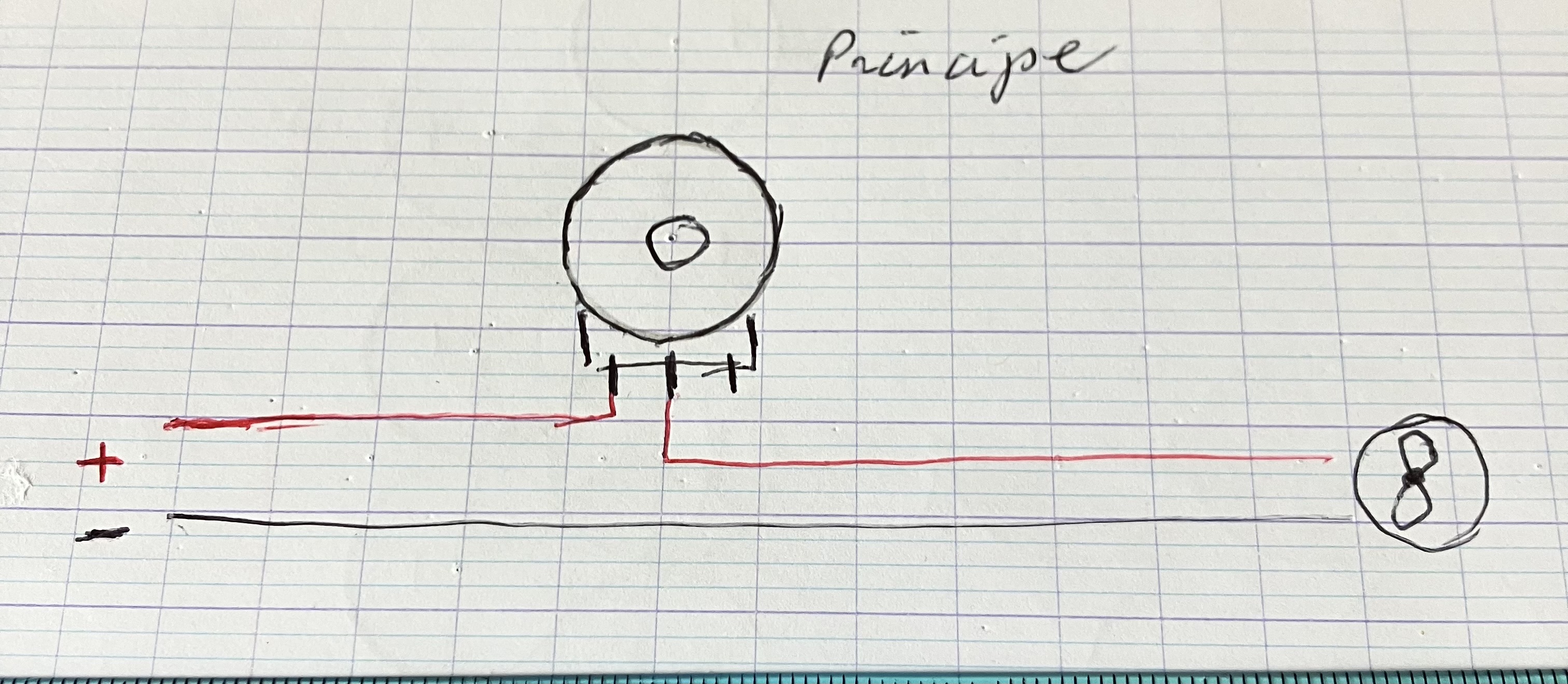

Anyway. I would suggest a ten ohm wire wound variable resistor/potentiometer or pot for short.
With three connectors/solder tags. Just use the middle one and any one of the other two. Depending on which one you chose, changes which way turning the dial goes up and down with the resistance.

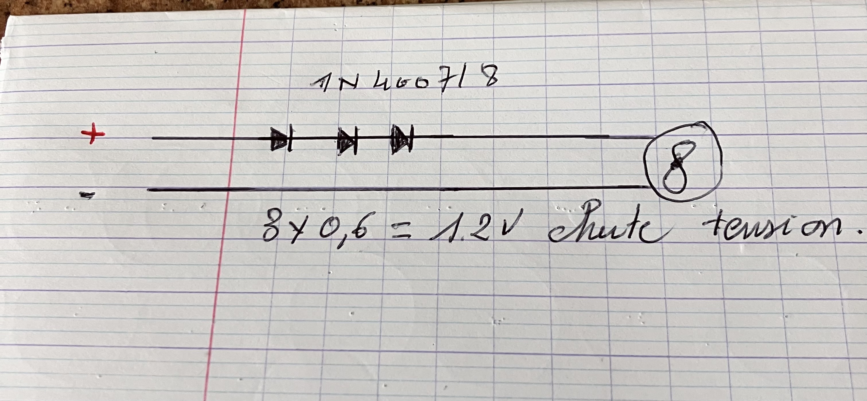

Jofaur86
- Posts: 2205
- Location: Centre France

- IMG_0567.jpeg (1.03 MiB) Viewed 2139 times
