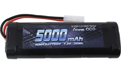

Nine years on the shelf?? Not good for the battery. Is it yellow (Nicd) or Green (Nimh)? which doesn't change anything about too long storage, without recharging.....more as you get older? the wires of the battery tend to oxidize, and do not conduct current, see also the plug (oxidized) I would say that it is time to invest in a new battery. On the transmitter at the bottom of the The antenna, there is a light, does it light up? You should have this type of platinum in the tank? this type of battery is suitable, but 2000 Mah will be enough

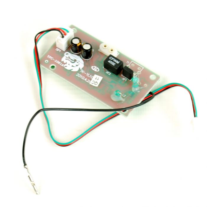

Yes, correct, but hey, personally already made the antenna work, reduced the range, but not being very sophisticated electronics? Personally I don't think that's the problem!!! As said above by Jardinage, the first thing, in order, is to replace the battery, and if the original charger (which actually only has the name charger) common transformer and 4 diodes, allow 6/8 hours of charging for a new battery, there may also be a quartz problem? in the tank you must have an RX plate with a quartz on it, check that the numbers match? that they are well seated in their supports, non-oxidized contacts, and avoid dropping Otherwise HS, also check all the connections of your cables (always oxidized contacts) I know, that's a lot? there are specific bombs on the market, for electrical contacts

Receiver 27 Mhz HL the black wire is to be connected to the antenna, and the multi-strand (3 wires) makes the connection with the RX 18 plate, CN 8 Receiver Board socket
