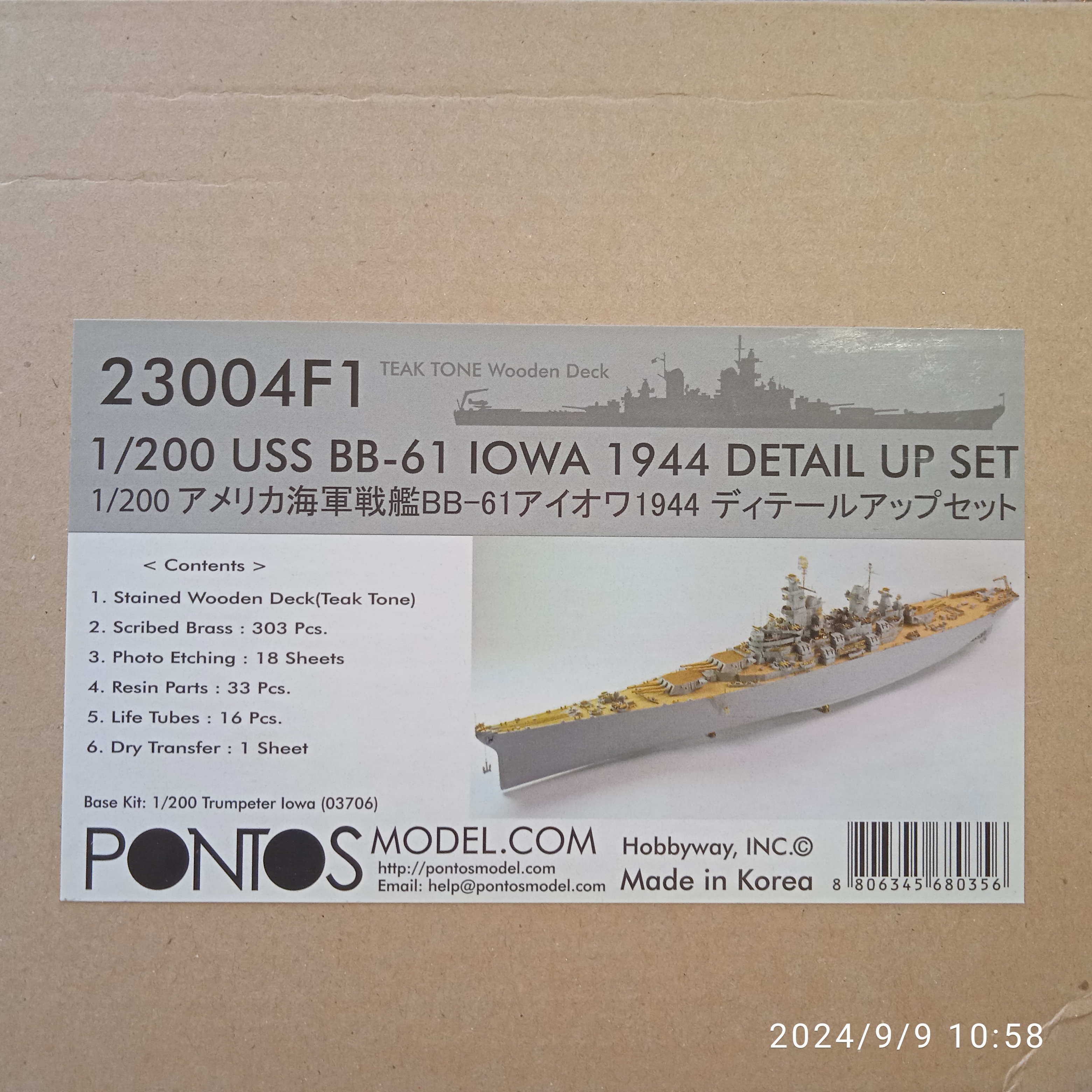

Money doesn't matter! (c) The Fifth Element
I don’t count money for hobbies....
Don’t eat ice cream again, don’t go to the cinema...
Just recently I bought an additional kit for Iowa 1/200
It costs 300 bucks...
